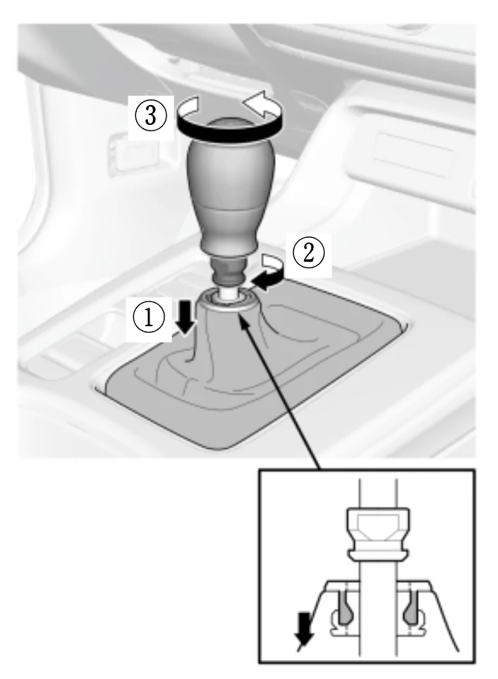

This is all I found in the online procedures. I used a plastic interior panel removal tool to force it down the first time. After that it was much easier to do by hand.

Great, thanks for this, I'll give that a try and hopefully I don't snap anything!

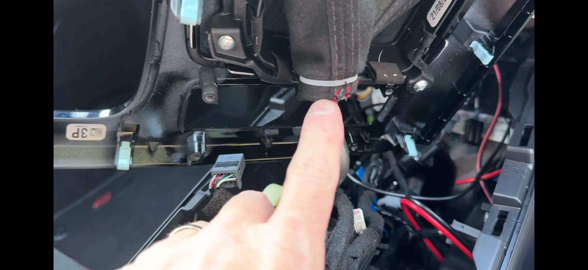

Here is an image of when I replaced the center console. It shows you the ziptie that you need to cut. I ended up cutting mine and replacing it with no problem.

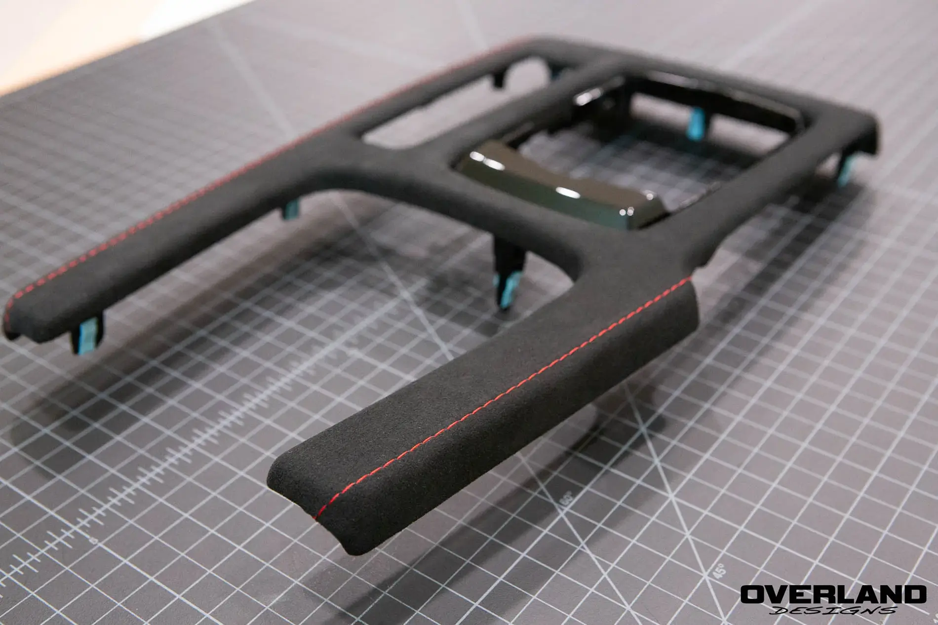

I just ran into this issue as well, and the method of just removing the center console completely and flipping it over was the way to go.
I am always so hesitant to start taking off interior panels for fear or breaking tabs or creating new rattles (probably because I am used to working on 20 year old cars and not brand new ones), but the center console came up surprisingly easily. After that it was easy to see what's going on and remove access the tabs on the collar.
In this picture you can see where the tabs are, keep in mind there are two more that you can't see in this pic, on the right side directly opposite the two visible on the left towards the bottom of the piece:
