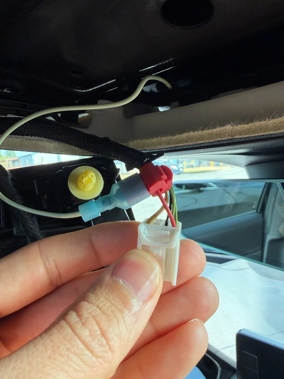

I just did this same install as Berzerker. Great writeup and works perfectly.
The only thing I did differently was instead of jumpering the red and yellow wires, I wired the yellow (homelink power) to constant 12v. That way the homelink buttons work even when the car is off.
Conveniently, the red wire in the map light connector is constant.
You didn't happen to have a reference photo of that red wire did you?
