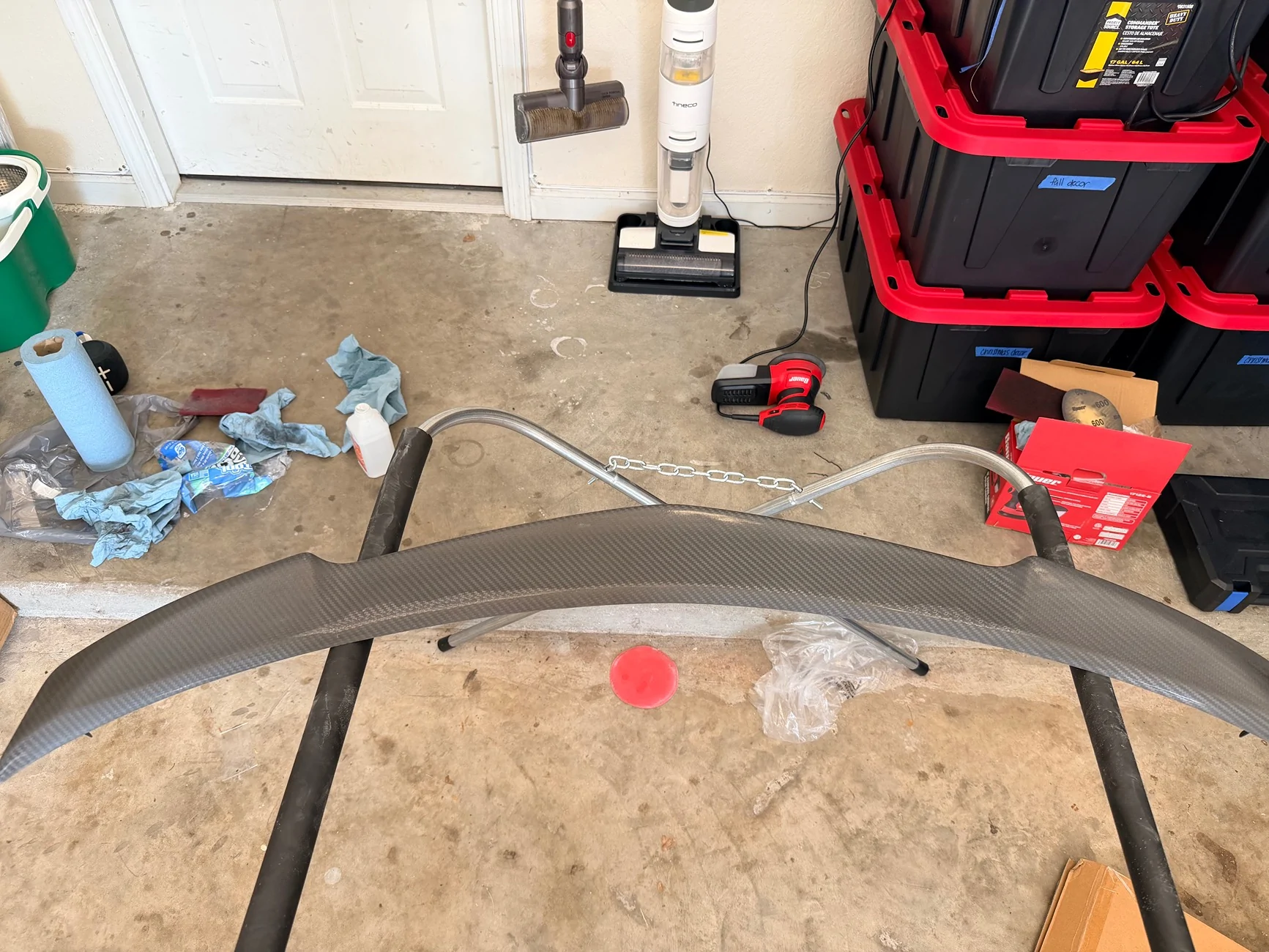

I had to have mine replaced under warranty for this issue. I installed myself and in less than a year, it was peeling in like 4 spots. Shoutout to myacuraparts.com for putting in my warranty replacement and shipping it out to me free of charge. They must have know this was a known issue because they didn't ask for pics. The hardest part getting off the old spoiler and then the adhesive cleanup takes twice the amount of time that it takes to replace the part. Because the spoiler drops down in the holes, you can't easily just saw all the way through with floss like some other spoilers. Yes the tabs are reuseable, but the adhesive is one time use and will be destroyed upon removal. You might need some needle nose pliers to grip the tabs and hold them open so that they can be slid off. I ceramic coated the replacement and probably should have used a better one, because there is a single spot of peeling, but I'm not doing it again if I can avoid it. Good luck.
