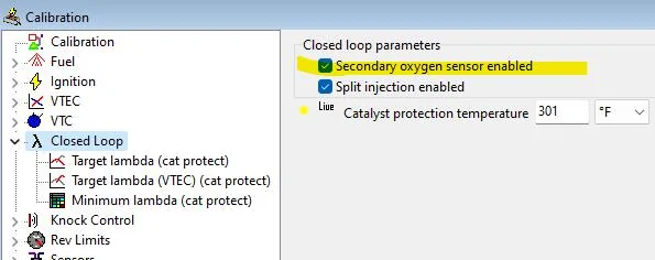

I don't think you need a tune for either exhaust or DP, but @koatic has more experience with that I believe. Pretty sure I remember he did all the basic bolt on's with no tune to see where he landed power wise before getting it tuned.
I don't think a tune is absolutely necessary until fuel/turbo mods.
To clarify a tune is optimizing your ECU programming for best performance with or without any modifications.
You cannot modify anything on our DE5 without Hondata at this time (don't think Cobb is developing for DE5).
only bolt-on that would be an "issue" without hondata would be an aftermarket Downpipe that does not have the secondary O2 sensor and your car would have a CEL and run very poorly maybe even limp mode but not sure.
you NEED hondata in this situation to disable the secondary O2 in the ECU from throwing CEL AND affecting very table that uses closed loop to calculate vlaues.
Acura Integra [Now Available] AWE Exhaust Suite for the DE5 Acura Integra Type S 1720808679236-x2

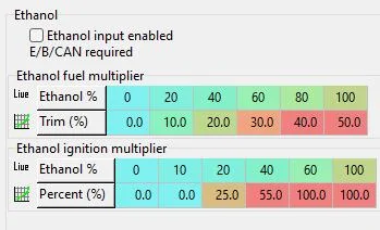

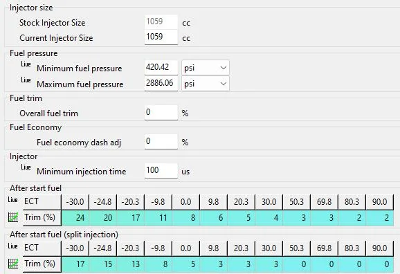

Other mods which technically would be classified as bolt-ons that I don't think will throw code but you will not be able to utilize the benefits without the ability to modify values would be Fuel system upgrades. (fuel injectors and or ethanol)
Acura Integra [Now Available] AWE Exhaust Suite for the DE5 Acura Integra Type S 1720808975113-v7
Acura Integra [Now Available] AWE Exhaust Suite for the DE5 Acura Integra Type S 1720808985496-sj
Upgrading the turbo itself I also don't think would throw any codes and I expect you would see some gains with stock map but without ability tune it would not realize potential..
I am no SME (subject matter expert) on this, and this post is considered my opinion and not hard facts..
