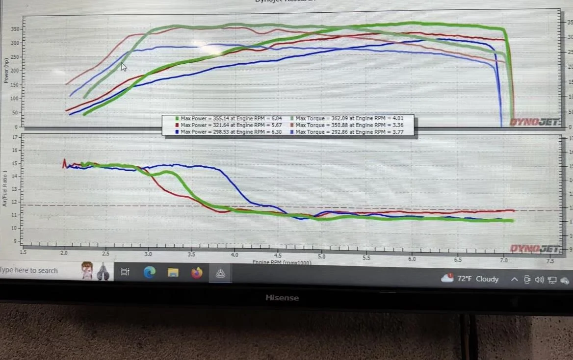

This is my car bone stock with a intercooler upgrade when I was developing my basemap. Stock everything aside from intercooler in the heat soak that is Miami.
Blue stock
Red Hondata OTS map
Green custom tune

To clarify your point, your graph there does NOT show turbo lag, it shows the turbo threshold moving. This is a very confusing topic for most people, even car enthusiasts.
Turbo lag = the time it takes to build ANY boost from the time the throttle is opened ANY amount.
Turbo threshold = the rpm at which the turbo spools for max torque/boost.
You can alter turbo threshold a lot more easily than turbo lag. Getting rid of lag is hard. In this car it's not totally horrible, but it's there. It's no NA car with a drive by cable throttle body, but it's also no ej257 subaru or early air cooled Porsche.
Increasing piping size, intercooler size, or changing wastegate actuation can negatively effect turbo lag AND turbo threshold. For a stock based car, the best way to reduce the throttle to turbo lag is to adjust wastegate actuation so the piping post turbo maintains some pressure with throttle pedal 0%, possibly even leaving the throttle body sliiiightly open. This is what Porsche does in their turbo cars now when in s+ mode. You lose some engine braking ability, but you gain a lot of throttle response and dramatically lower the turbo lag.
