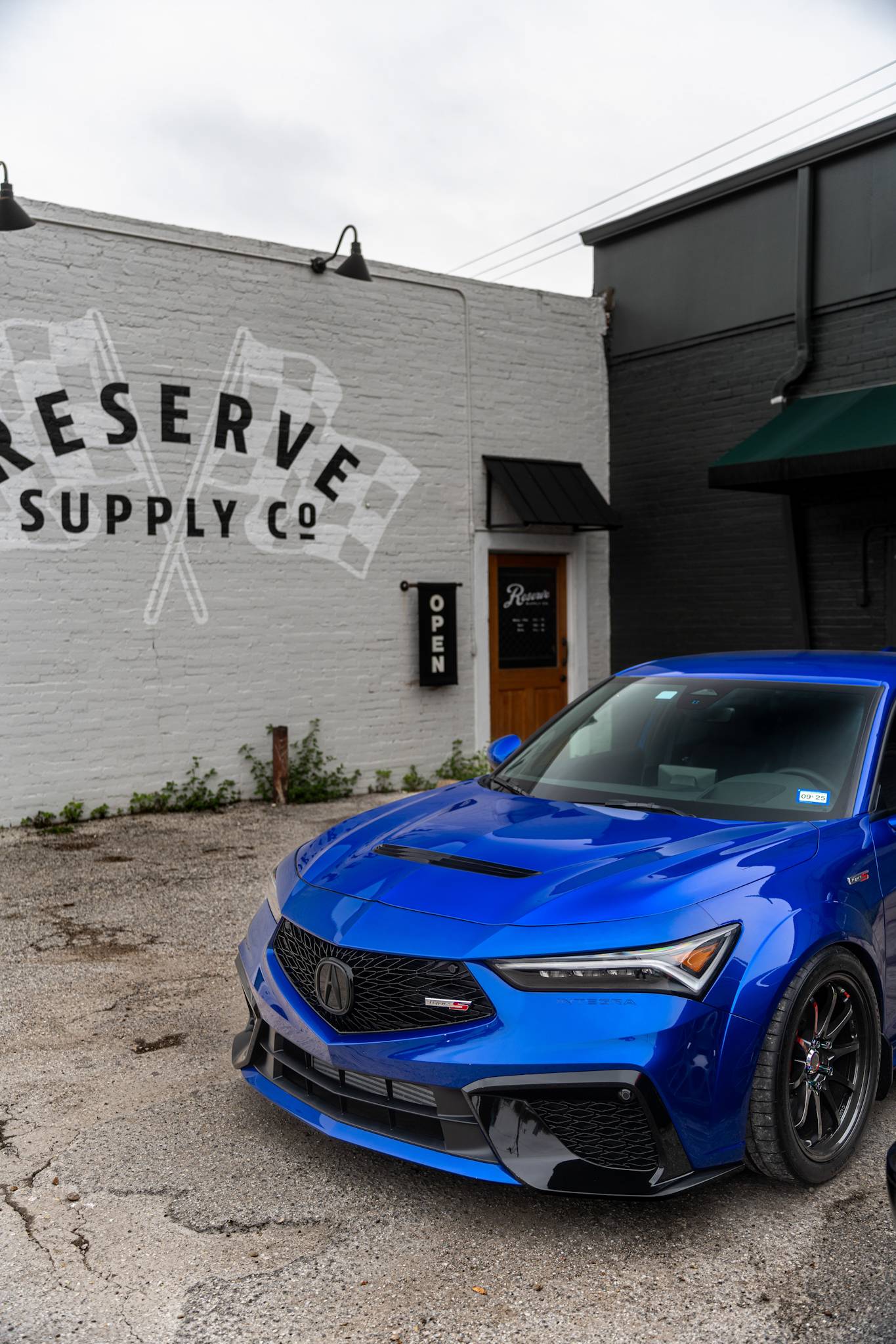

if you want a quick solution that won’t require you to remove your front bumper you can plastidip the front emblem.
I didn’t care to remove my bumper and just wanted a black emblem, so I opted to try it out. It took maybe 15-20 minutes, mainly from masking off and ensuring I had proper plastic sheets to cover any overspray.
Although not as nice as an OEM blacked out emblem, I was happy with the look.
