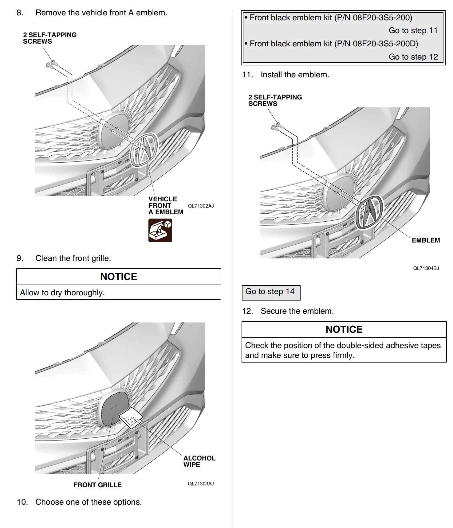

Based on Acura installation instructions, one should remove the front bumper to install "Front Black A Emblem". Installing illuminated A emblem is more complex because of wires and it makes sense to remove the bumper.
Any idea if "Front Black A Emblem" can be installed without removing the front bumper? Maybe there is a trick to remove old and install the new "2 SELF-TAPPING SCREWS"?
http://www.urvi.net/forumfiles/SB/BII19600-08.PDF

To do it correctly, you need to drop the bumper was the consensus I found on the rest of the forums. I am sure if you were really determined you could cut/break off the old emblem and glue on the new one. But it would probably take less time just to take the bumper off and do it right. Or pay the dealer, from the few prices I saw, I thought the cost was pretty reasonable.
804
1,026
I agree with @ZeroGSR, as I tried to get really creative with how to access the front logo on my A-Spec + Tech, but it’s pretty well locked down.

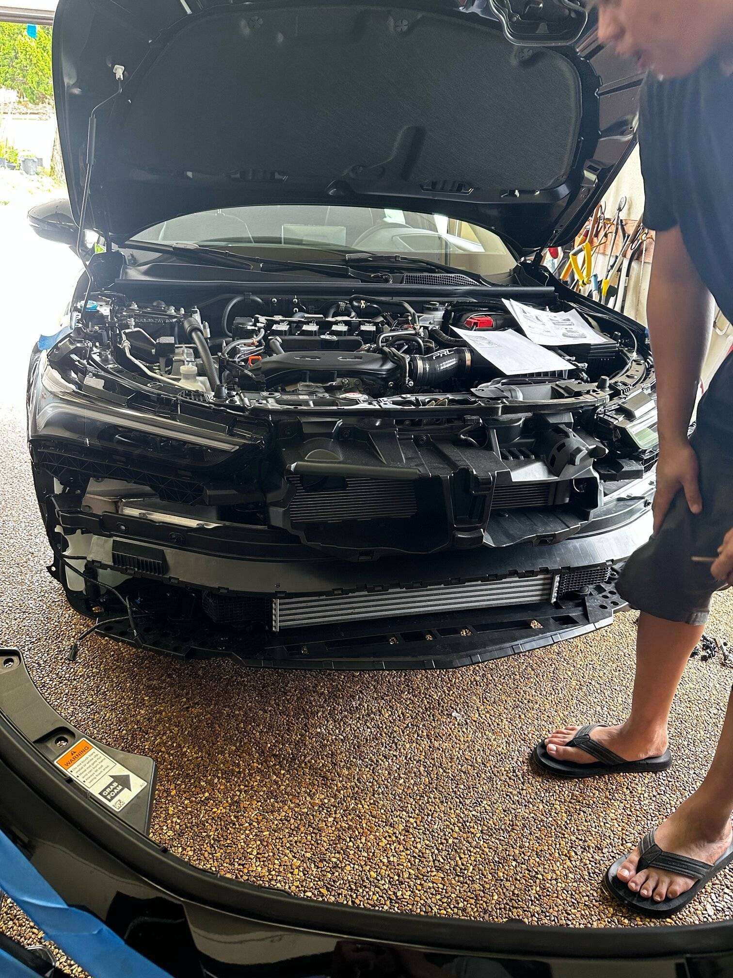

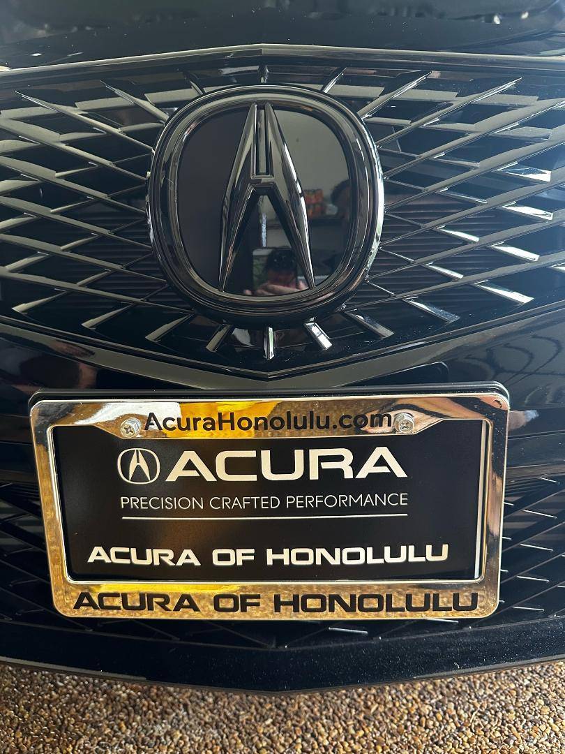

Thanks for the info. I did the job myself and it looks great. It saved me $200 quote from the Dealer to install it.
Acura Integra Front Black A Emblem installation without removing bumper image0 (1)
Acura Integra Front Black A Emblem installation without removing bumper Black
