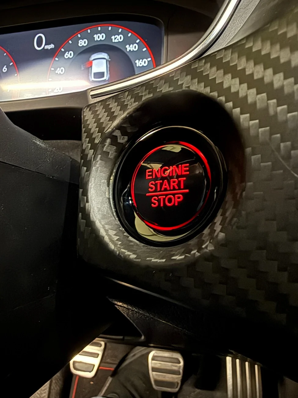

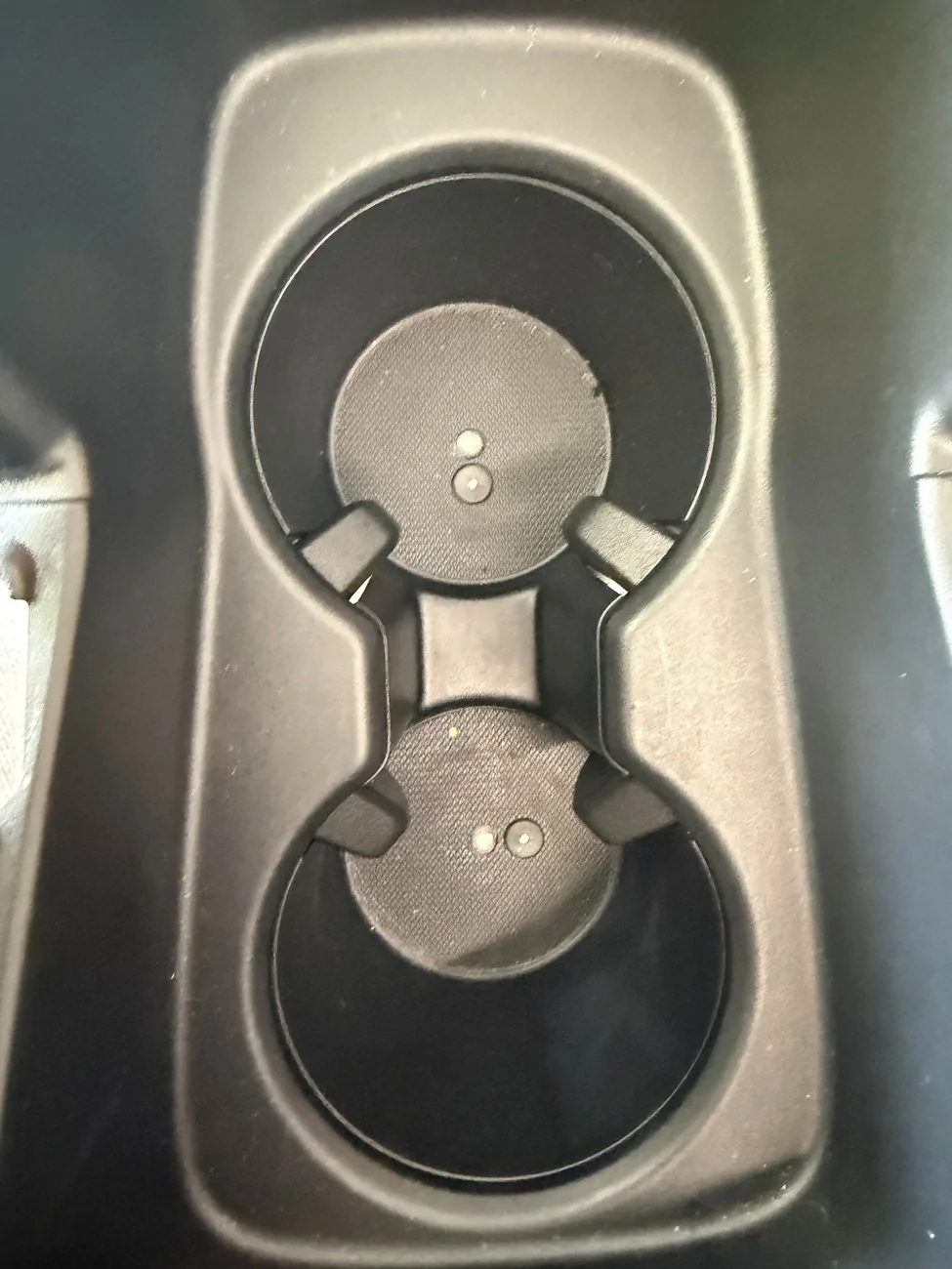

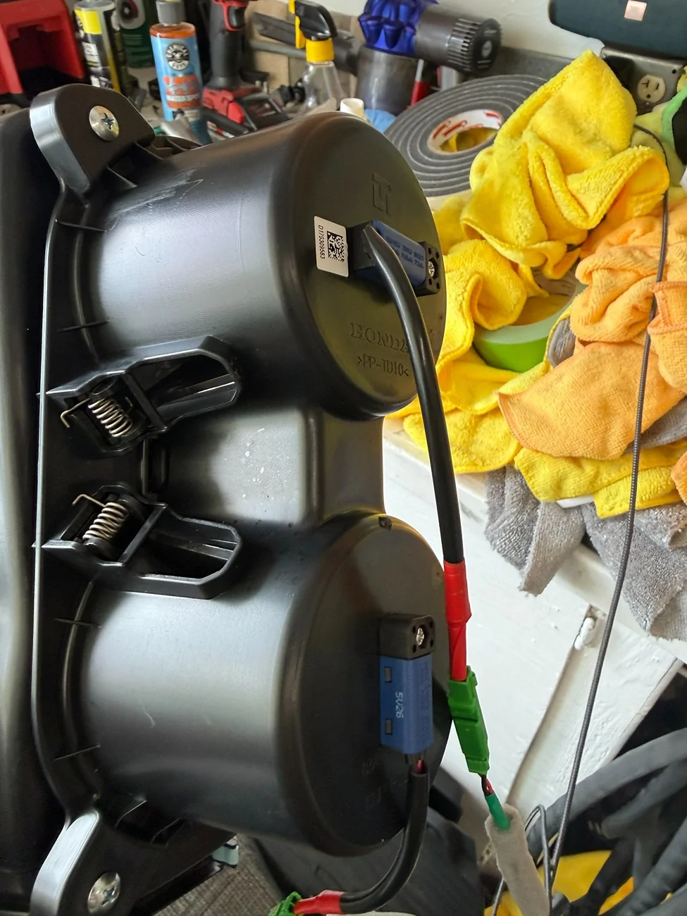

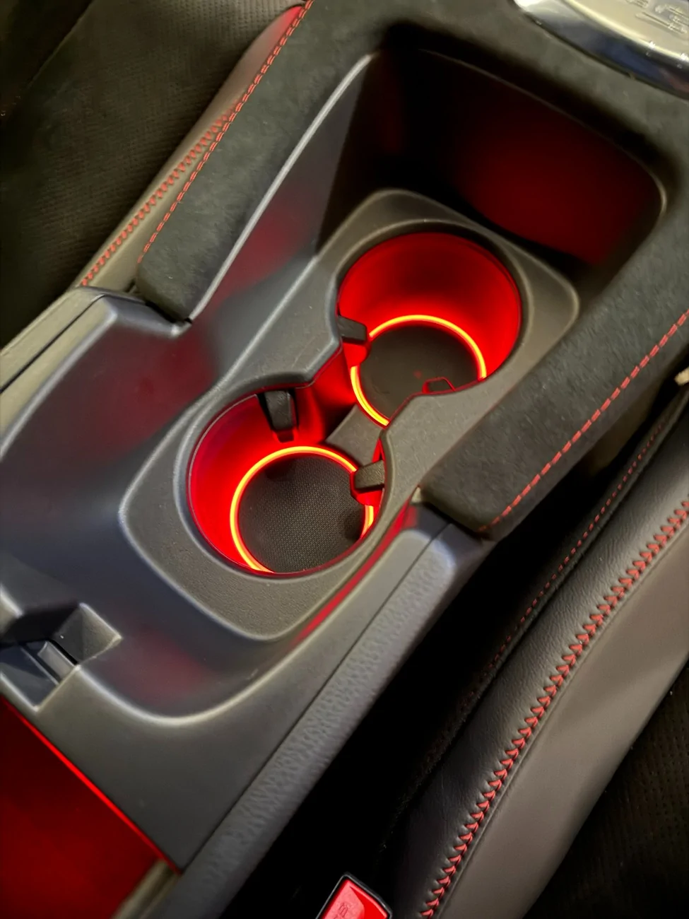

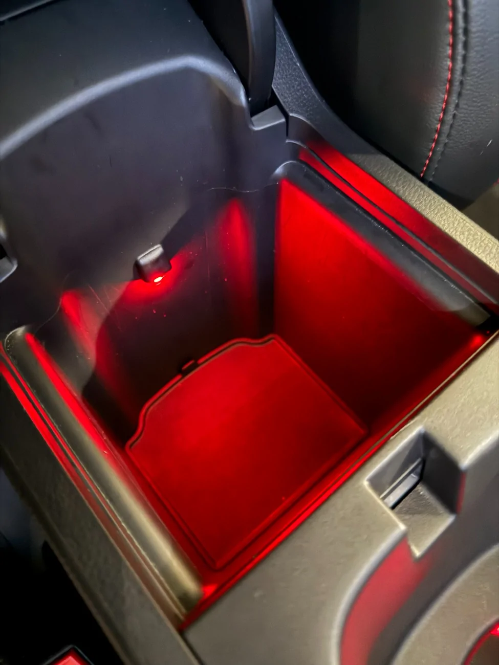

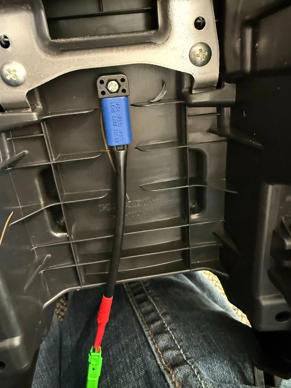

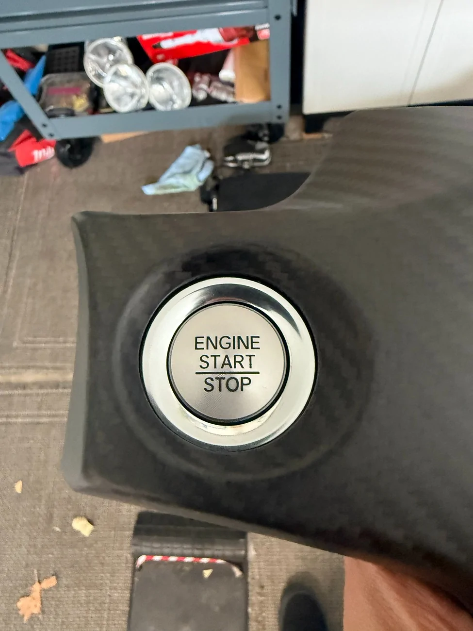

Fresh From JDM Land, got the FL5 illuminated cupholder and console led lights along with an FL5 Factory OEM Start/Stop Button.

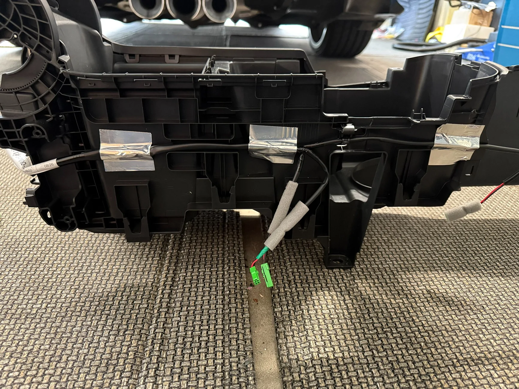

Here is some of the process, tried to follow the directions as best I could given that it was directions for RHD. A/C vent section on the dash needs to come off as it plugs into the harness at the Hazard button. I am trying to black out parts and since I was pulling it off anyway, I replaced the Start/Stop with a Type R one.

Are those jdm FL5 lights plug n play?
Some drilling required, but yes!
I like the cup holder light. That's fun.
Do you have a part number or link for it?
I ended up finding a decent deal on ebay, shipped direct from Japan.
Part number 08E16-T43-B01D, https://www.ebay.com/itm/198192716612 .
They accepted an offer of $180

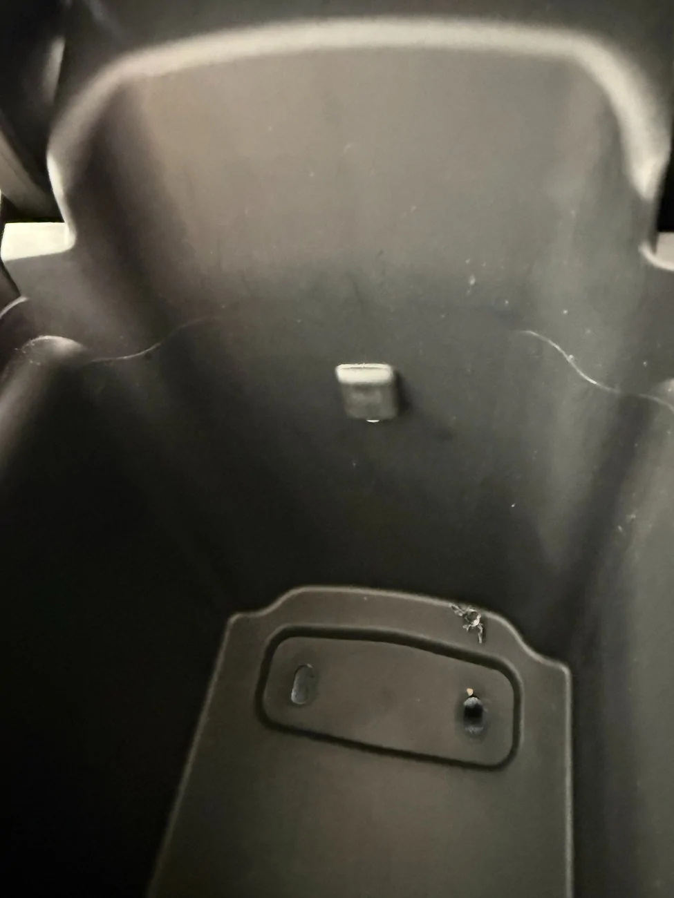

I was going to do the one from Mikstore, but then I found out that the bottom of the center storage console has to be cut out. You see the A/C duct at the bottom, which makes that storage area useless. Does your parts list have this same issue? How much was it, if you don't mind saying?

I ended up buying a full center console from a Type R, it isn't as deep as the Type S and allows for the duct to be routed properly. There is a lot involved as I found out as I progressed with the project.
Mikstore kit: $260
Type R center Console, Ebay: $210
Parts for the OEM Factory rear vents and USB: $220
Bracket and hardware for Type R Box: $20
Grand total was a little over $700 to complete this.
I probably went about it the wrong way and there was probably a little bit better and cheaper way to get this accomplished. However, coming over the pond makes a lot of the cost about 1/3 in shipping.
For Reference, here's the Type S Box:

This is the Type R Box:
