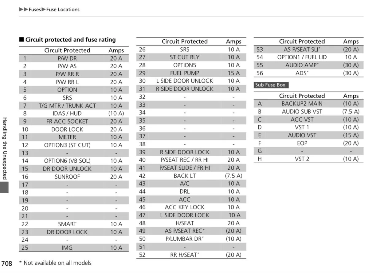

Does anyone know which fuse is for the interior vanity lights?

There is no direct fuse for the vanity lights. What car do you have ?
Base, Aspec, or Apsec Tech?
Cvt or Manual?

Type S. Drivers side does not work but passenger does. Figured it was a fuse.

I would figure it be all or none.
Check the connector maybe it's loose.

Yeah, it’s connected to the dome lights and interior lights. No fuse, just a module relay. Seeing how it’s just the driver side only it’s either a bad connection or looks like you got yourself a new sun visor under warranty. I doubt you want to got through all the testing yourself, but service manual states check continuity at the sunvisor, if none replace sun visor.

Can’t you just swap out the bulbs from side to side to make sure? Seems like a very quick test.

This is the next step. Will report back!

Apparently I was overzealous with my installation. The LED bulbs were pushed too far in to the connector.
Lesson learned.
