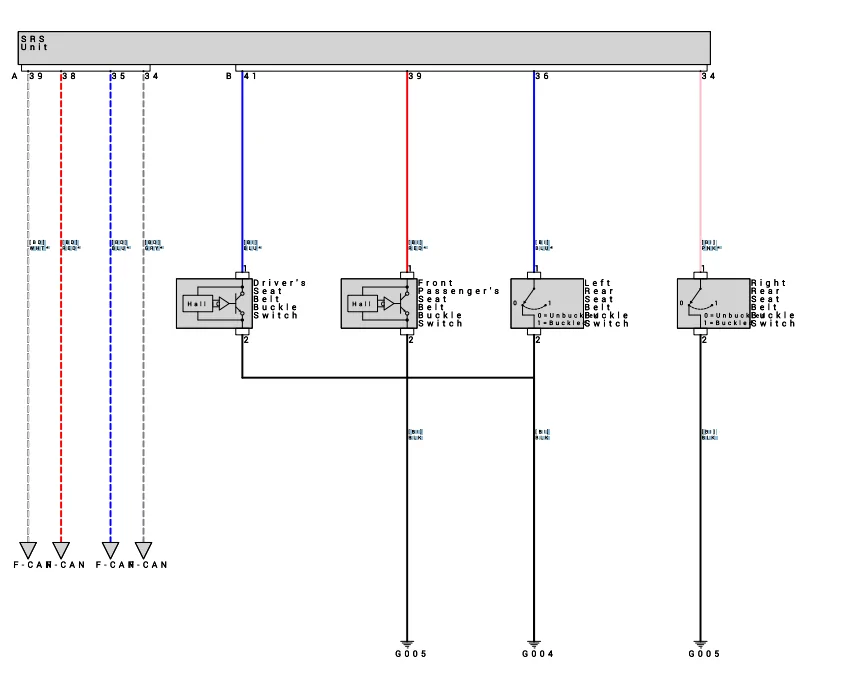

The seat belt buckle should have 1 NO contact and 1 NC.
The NO contact becomes close when the seat belt is buckled. This is the one to jump. If the NC contact should open when the belt is buckled, so the car will think everything is OK
Not that I recommend not wearing a seatbelt nor do I recommend modifying a safety component, but here is your diagram.
View attachment Reminder Systems (KA USA DE5) (Instrument Panel, Gauges and Warning Indicators).pdf
Seems that the buckle switch are not mechanical switches anymore from the diagram. Interesting!

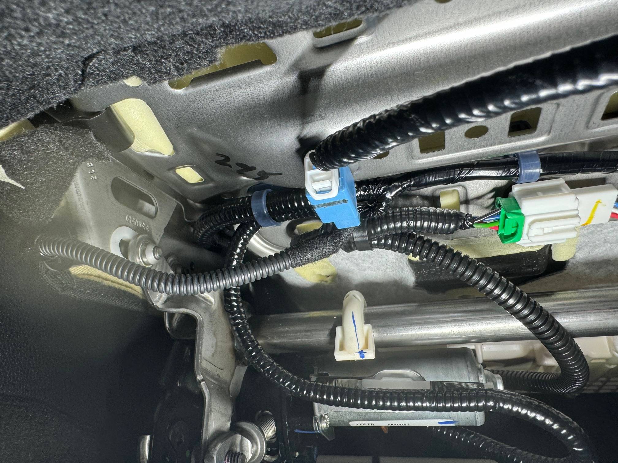

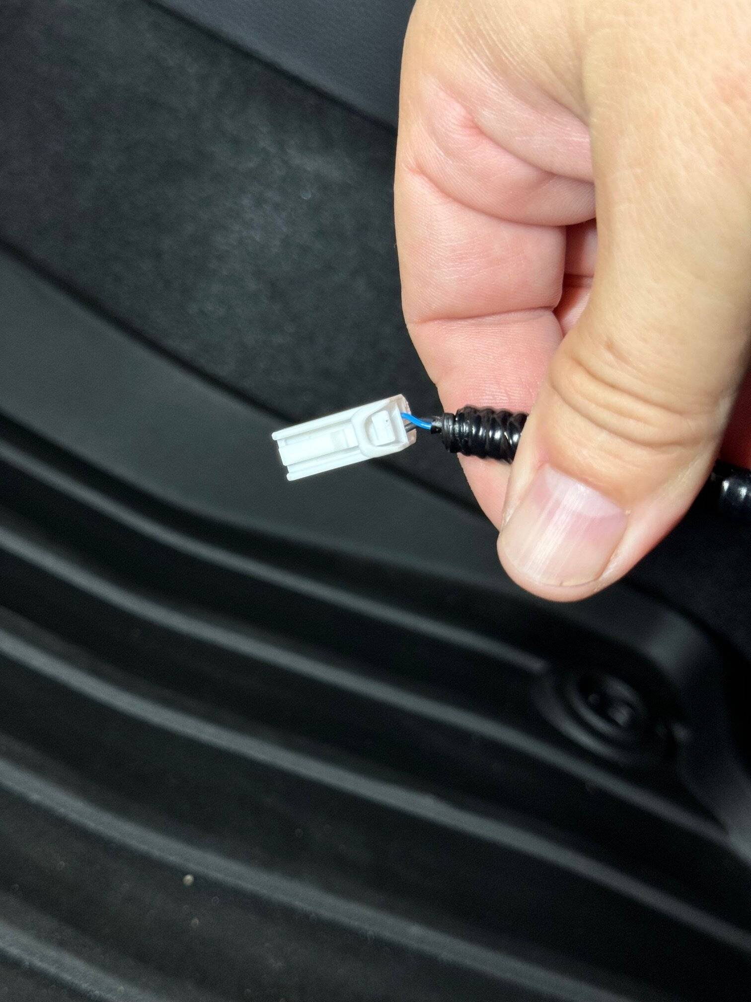

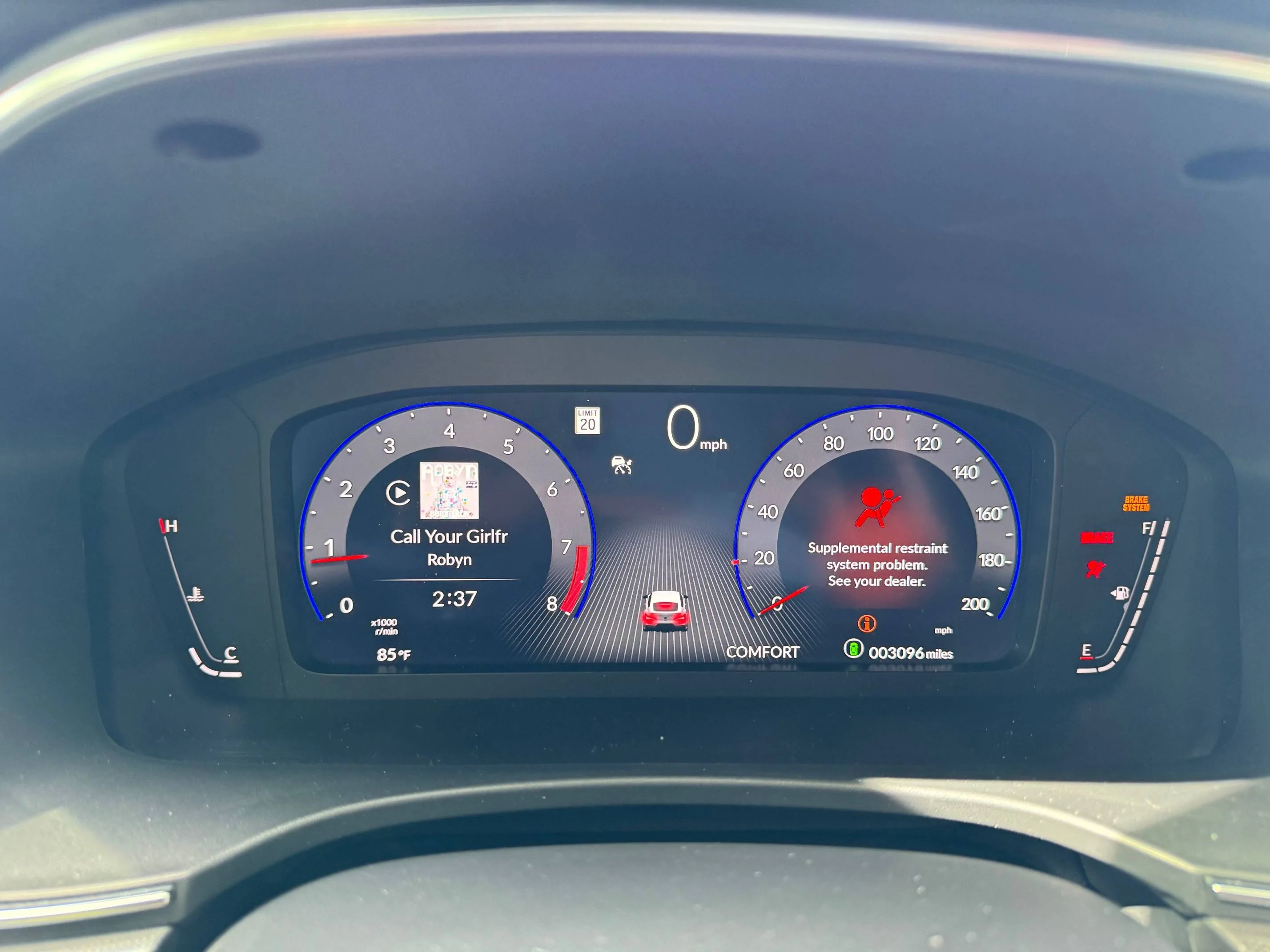

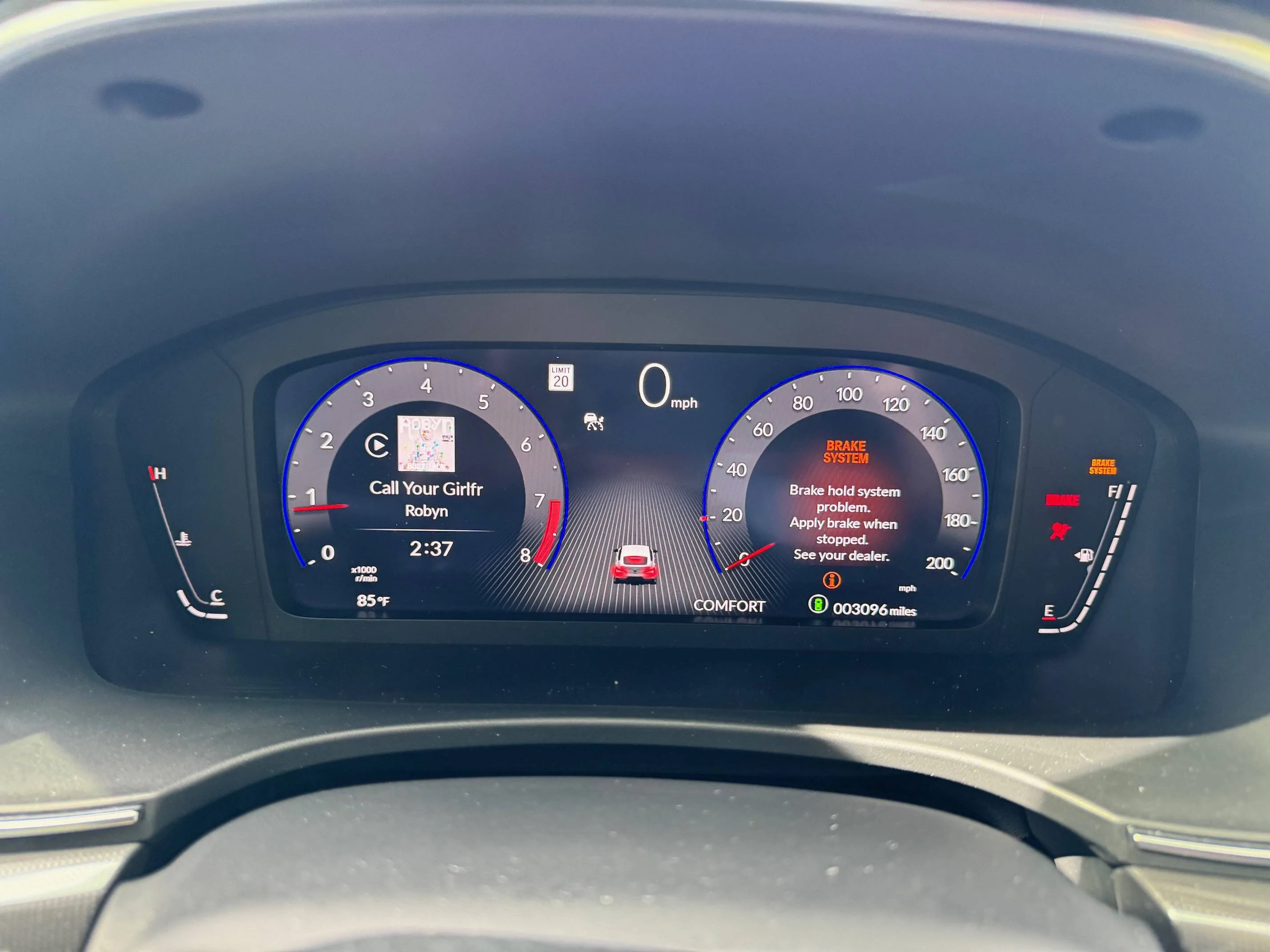

OK finally getting around to taking another look at this. So i unplugged the plug from the socket, and the seatbelt chime did stop ! The little icon (red unbuckled / green buckled in) on the dash showed i was buckled in, however i got two different errors that cycled through. All errors went away when i plugged the plug back into the socket. Can someone help me please understand, who has some auto electrical knowledge what has the brakes got to do with the seatbelt ? Also for the full electrical diagram its posted on #16 above. also most importantly how can i jerryrig this so i don't have to have my sealtbelt on when i'm say going at slow safe speeds and hoping in and out the car.
But here's the seatbelt part of the diagram. Again for the full diagram post #16 has it.
Here's the plug / connector location under the seat (in the blue housing)
The plug itself
First warning of two
2nd warning of 2
I don't like messing with things i don't fully understand. There's got to be more to it, as the seat belt icon was green and it stopped chiming with that unplugged. But then the warnings came about. Trying to get a better understanding.
The plug itself
2nd warning of 2

If you can isolate the wire that is B41, using a multimeter see what the voltages are with the seatbelt buckled and unbuckled. With any luck it's a steady low voltage when buckled (5-12Vdc, and probably 0Vdc when unbuckled) and then you can simply wire it to always have that voltage when the car is on.

Interesting. I wonder if it's something redundant since with brake hold enabled and when your stopped then remove your seatbelt it automatically applies the parking brake.
The car drove absolutely fine. it was just giving the warnings. EPB worked fine also.

I don't think these work on our cars, the clip has a different shape to it. i looked online and couldn't see anything that had a similar shaped clip to our cars. not that i'd want the hassle of such a contraption.
i'll see about the voltage. i don't think a multimeter probe will fit in there. maybe it will, only one way to find out.
