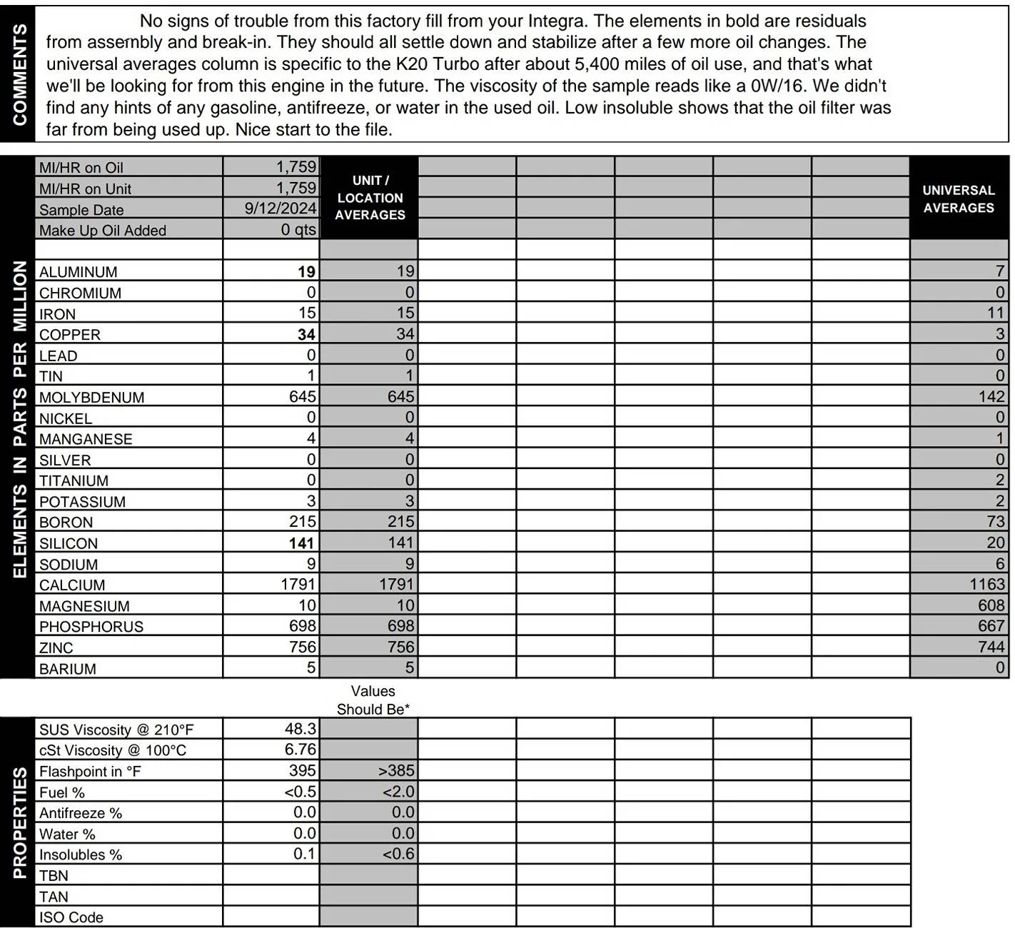

Oil analysis came back. The virgin oil they deemed looks okay. It's interesting how much my oil degraded in weight in under 1800mi, but hey it's breaking in.

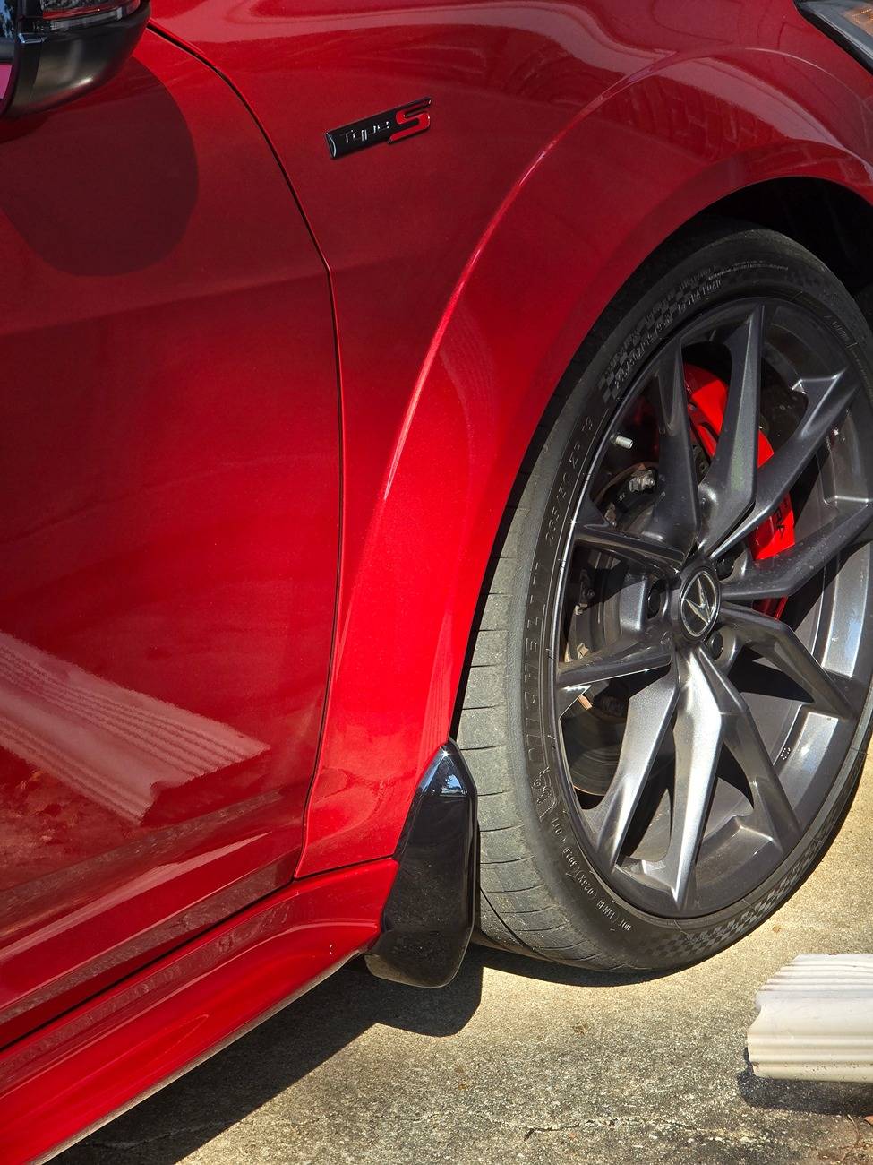

I added the oem mudguard today. I lost my bottle of expensive ceramic somewhere so instead I did several layers of opticoat on them. This is my last bottle of OG formula opticoat from 12 years ago. I have 1oz of the stuff left, which is quite a bit, but every time I use it I get a little sad the supply is dwindling.

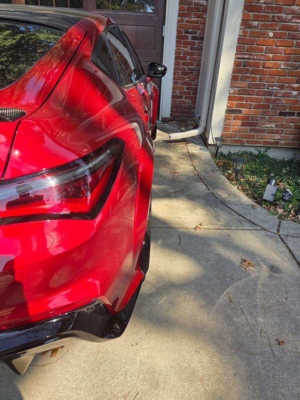

My car might just be cursed...

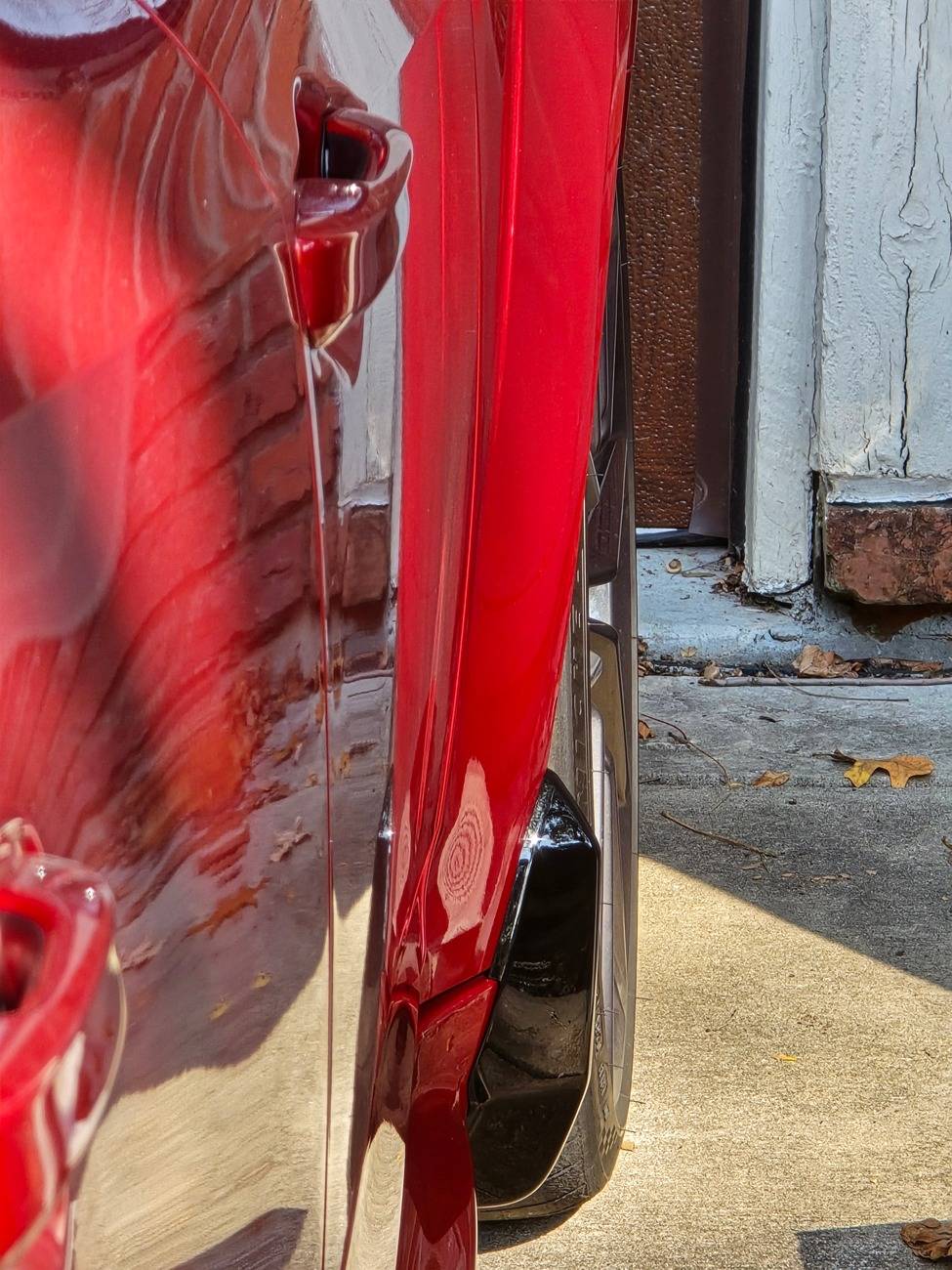

Dropped it off at my ppf place this morning to fix a few issues and redo some areas, and when they did their walk around, they found a bunch of dents on both sides of the car on the structural roof pillar.
It wasn't there on the 24th when I washed the car after the day at i29 raceway, the dealer had it on the 26th, and other than sitting 5ft from other cars in a grass lot at a concert venue (next to a model y) on the 27th, it's been in my garage. I have no idea how so many dents got there and only affected the pillar. Their all pretty much longitudinal, and slightly angular. ?‍?
? What has been seen cannot be unseen...
Now that I have been on the lookout for it, I have seen a large number of civics and accords with identical dents. Not really that many Integra that I spot around compared to Honda so the view is a bit narrow, but at this point I would anecdotally gauge 1 out of every 4 that I see as having the dents (to some degree), and primarily in the c pillar area. It's most evident on a clean car where you can see the reflections in the sun. No other car has been nearly as bad as mine has been, but none of them also looked like they had ppf where someone would have beared a bit of weight in that area when pulling film.
In fact, I saw one driver getting out of his car and asked if I may point something out (explaining I had issues and wondering if he'd noticed them on his accord). Poor guy's face sunk when I stepped him back and showed him the reflections in the sun. He immediately wanted to blame anyone or anything as the cause, but I pointed out the spontaneity of mine. Obviously he was livid, especially after I disclosed the cost to repair on my its. His words, "I'm not taking it to the dealer because they'll blame me and reduce my trade in value since then they'll know... I guess I'll just wait until the 3yr mark and trade it in for a Tacoma..."

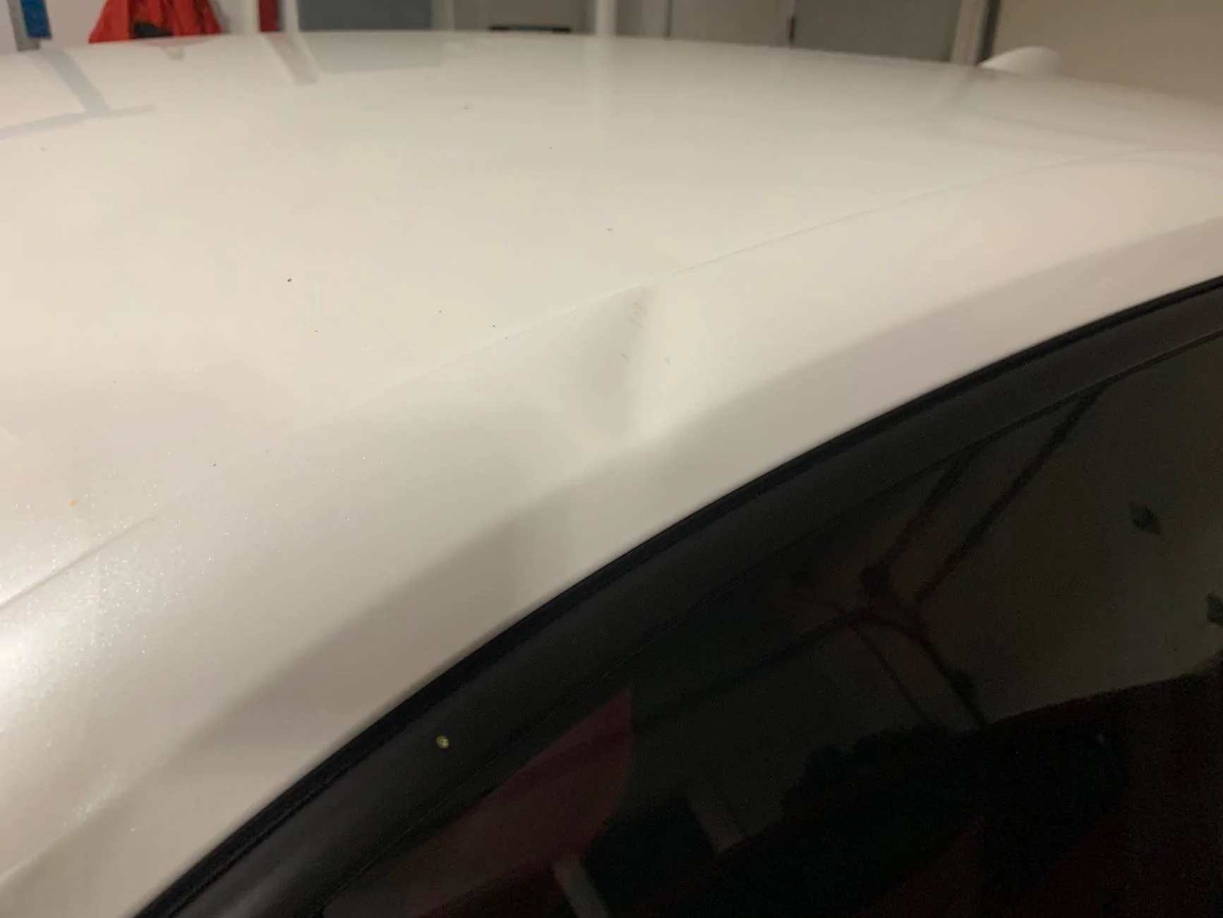

If it makes you feel any better I discovered this dent… after a large branch fell across my roof in my driveway. 400 miles on the car and hadn’t made a payment yet. It’s going in to get PDR’d next week.
Acura Integra Back on Track IMG_7348
I hadn’t heard of it happening spontaneously - that’s concerning! What do you suppose the cause would be? Stresses in the metal?
See your dent definitely looks impact related! The telltale sign is the edge of the dent near the crease. That takes a good amount of force to dent like that.
Mine are in areas and with shapes that you'd expect out of light force like hail, but strangely all directional and zero sign of impact.
My suspicion is that the hollow ladder bracing underneath that supports the structure as a rigid piece in the unibody has relief holes for strength and weight. Then the sheet metal on top is creased and pressed into shape to attach to the bracing structure. I believe the panel forming process was likely done at too low a temperature so it "wants" to return to its original shape, similar to how the little kid popper toys behave when you flip them and then they pop back into shape. I think with temp changes and some light pressure in that area provides the opportunity for the metal to pop back into its former flatter shape, but only in the sections where the ladder bracing has relief areas. With torsional stress, I bet it becomes more prominent. We'll see how the car does over winter in the Midwest...

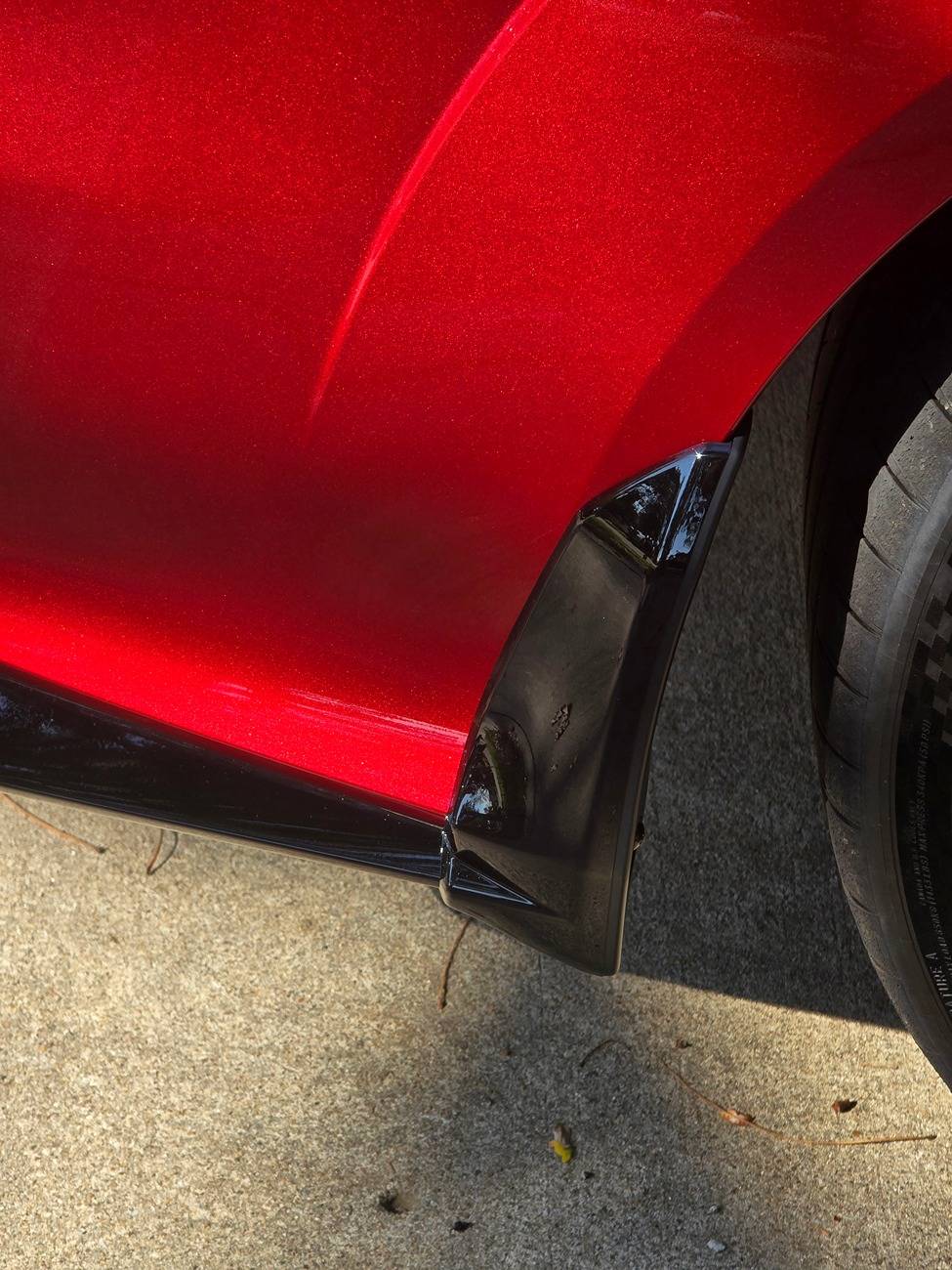

So I somehow pulled off my lower air dam/splitter. Not sure how exactly. I only reversed over some leaves and my driveway curb. Oh well, it popped back in easily, but I also didn't have a clip at the edge. Maybe it broke off?
In any case, this looks like a fairly important aero piece that would reduce drag and improve front end down force. It also looks like it would easily get torn apart on track, especially if you're lowered! Good thing it's really cheap and easy to replace!! https://dreamshop.honda.com/s/product/spoiler-fr-lower/01t6g000005kkqPAAQ
