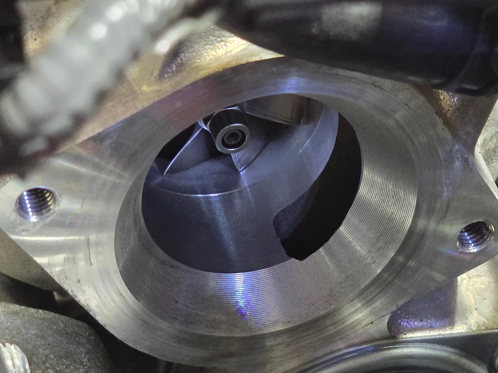

I'll also note, the intake is not the primary restriction, the turbo is. It's opening surface area is teeny tiny compared to every other part before it. If you want more intake sound, then an intake is the way. No tuner will tell you the intake is the limit until your turbo inlet starts becoming larger than the intake tract. There is some heat blocking validity with things like titanium and steel piping, though, the question becomes is it more efficient than shielded aluminum that dissipates heat faster. That's something that hasn't been fully tested or proven one way or the other yet.
Here's a photo of how teeny the turbo inlet is...
Acura Integra What am I missing?? My 2026 DE5 ITS story/build. Help me write her story.......I've named her, Kandi! 20260531_130152
