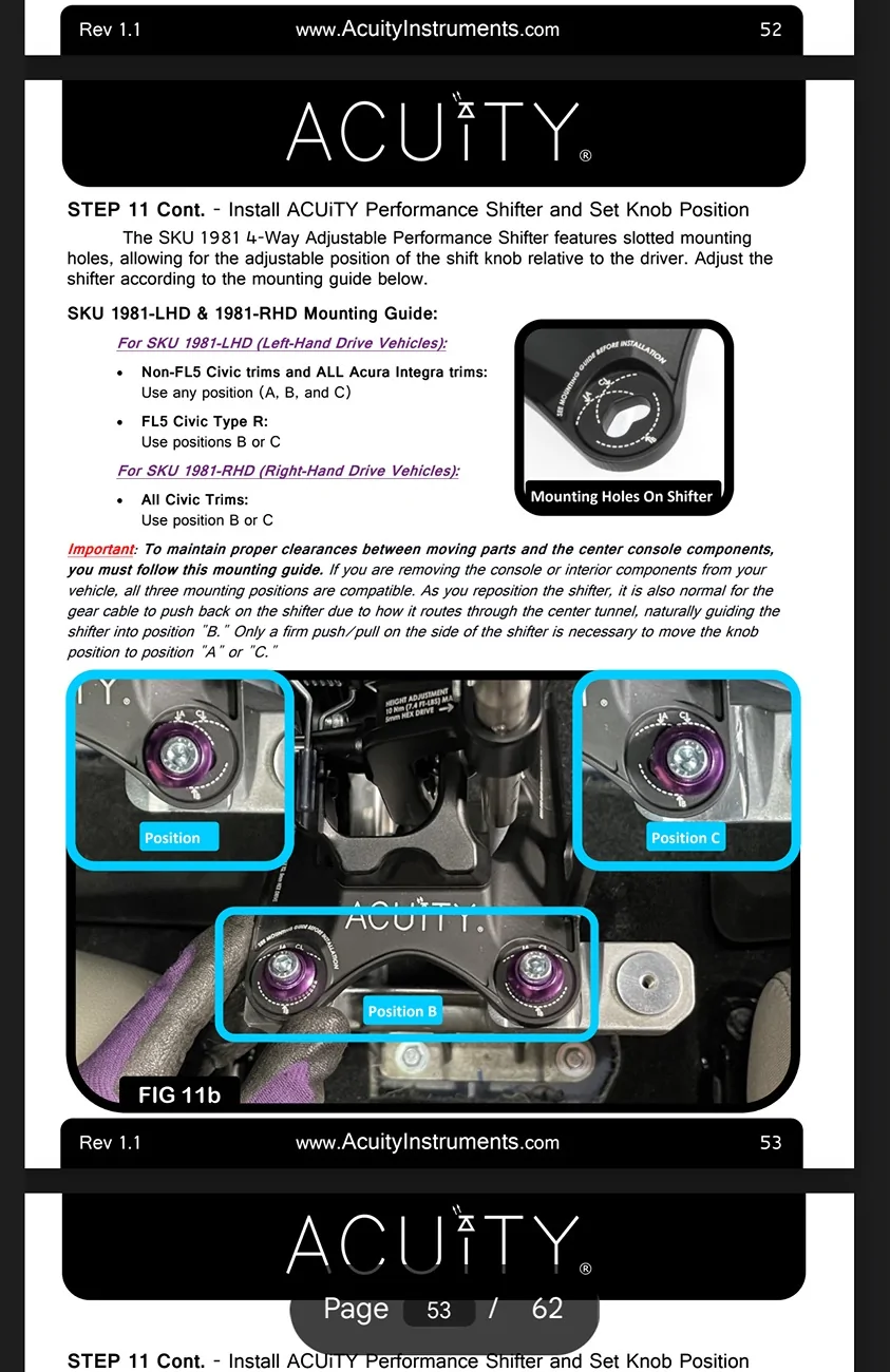

I was kind of hoping for some sort of adjustment to move the whole shift pattern rearward. I'd like to reduce the front/back throw but only very minorly - perhaps a 20% reduction?
Is it possible to "pitch" (in the sense of roll, pitch, yaw) the whole shifter assembly back a small amount? Or to adjust the cable controlling the fore/aft movement of the shifter so that it sets the shift pattern up further to the rear?

It allows for shifting the entire mechanism slightly. You could try adding some washers to "pitch it". I'm not gonna say "I recommend it", haha, but I wonder if a minor change would be enough to avoid problems.
Acura Integra 4-Way Adjustable Performance Shifter for the LHD 11th Gen Civic and 5th Gen Integra IMG_5319

I kind of wonder if positioning it on the furthest forward option and then pitching it back might net you more rearward adjustment. Obviously you have to work within the confines of the shift boot area.
I actually have some precision washers from one of my other hobbies that I could use for this purpose.
