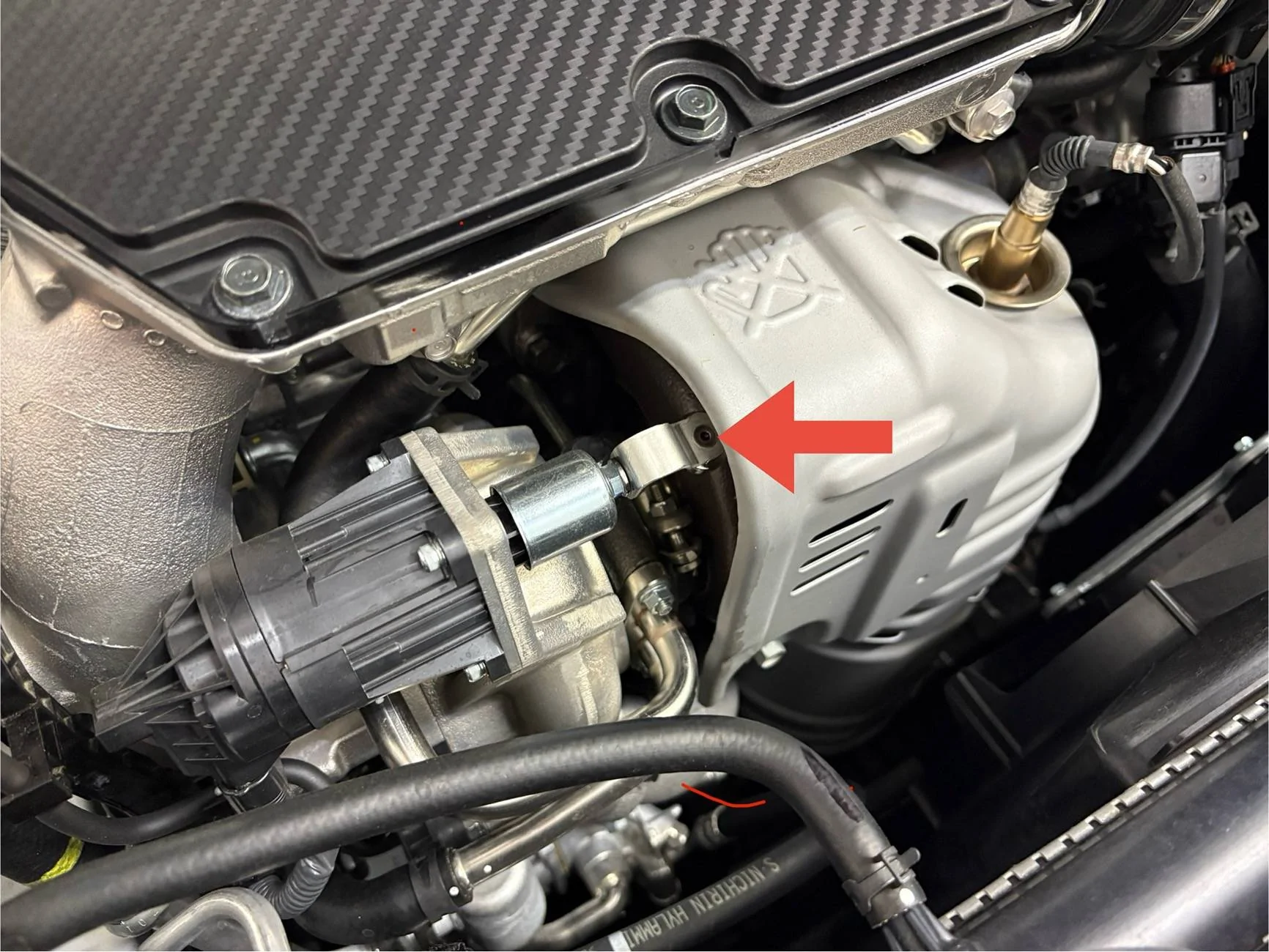

Agree with this. My car has had the exact same symptom since new and I was pointed towards the wastegate rattle. As soon as I gave the wastegate linkage a jiggle it was obvious that it’s bouncing around when not under any load. If it wasn’t directly over the turbo I’d just hit it with some thick grease. I haven’t looked closely enough to see if there’s another way to quiet it down.
Acura Integra Whistling/Subtle Metal Rubbing Noise when Coasting In Gear IMG_7939
some people have fixed their wastegate rattle on other car forums by adding a spring
