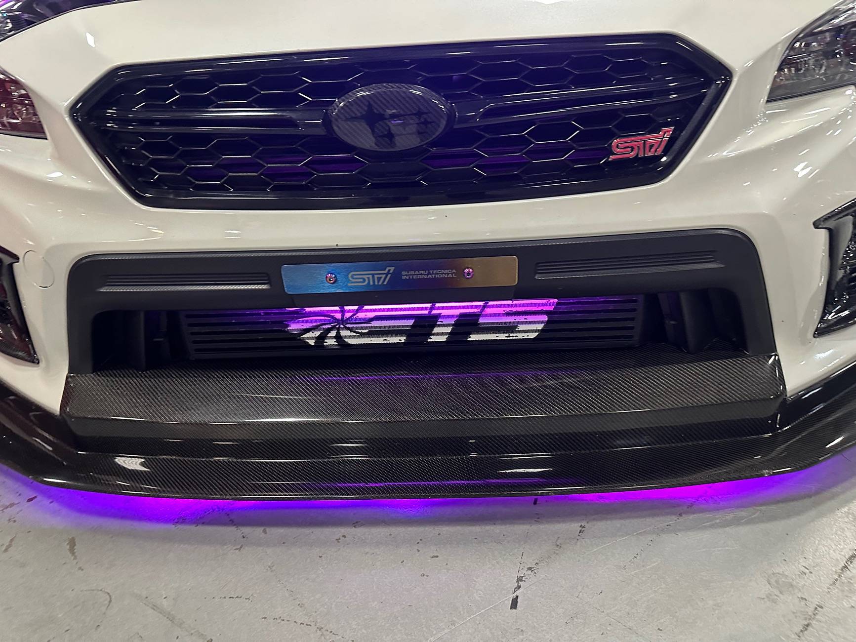

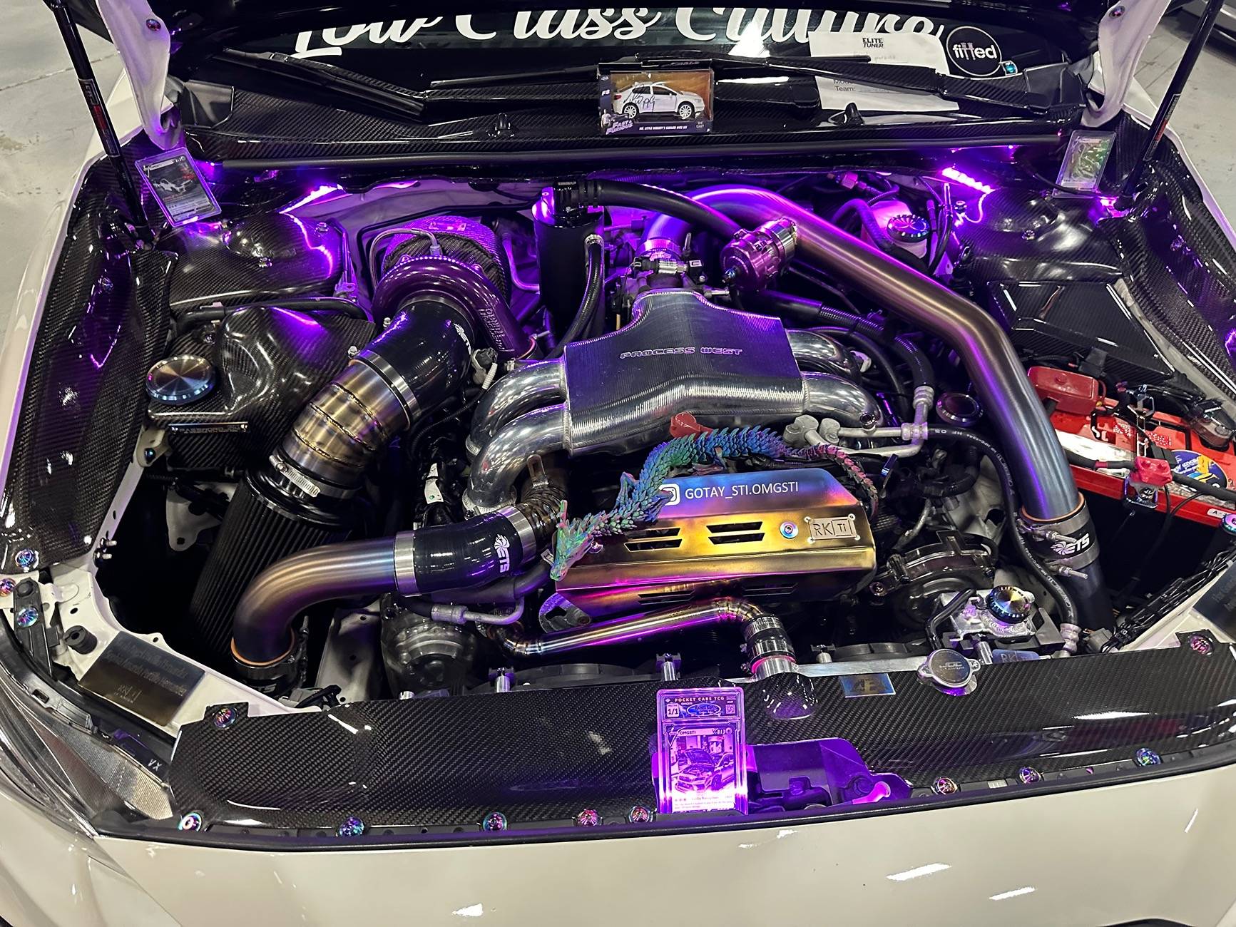

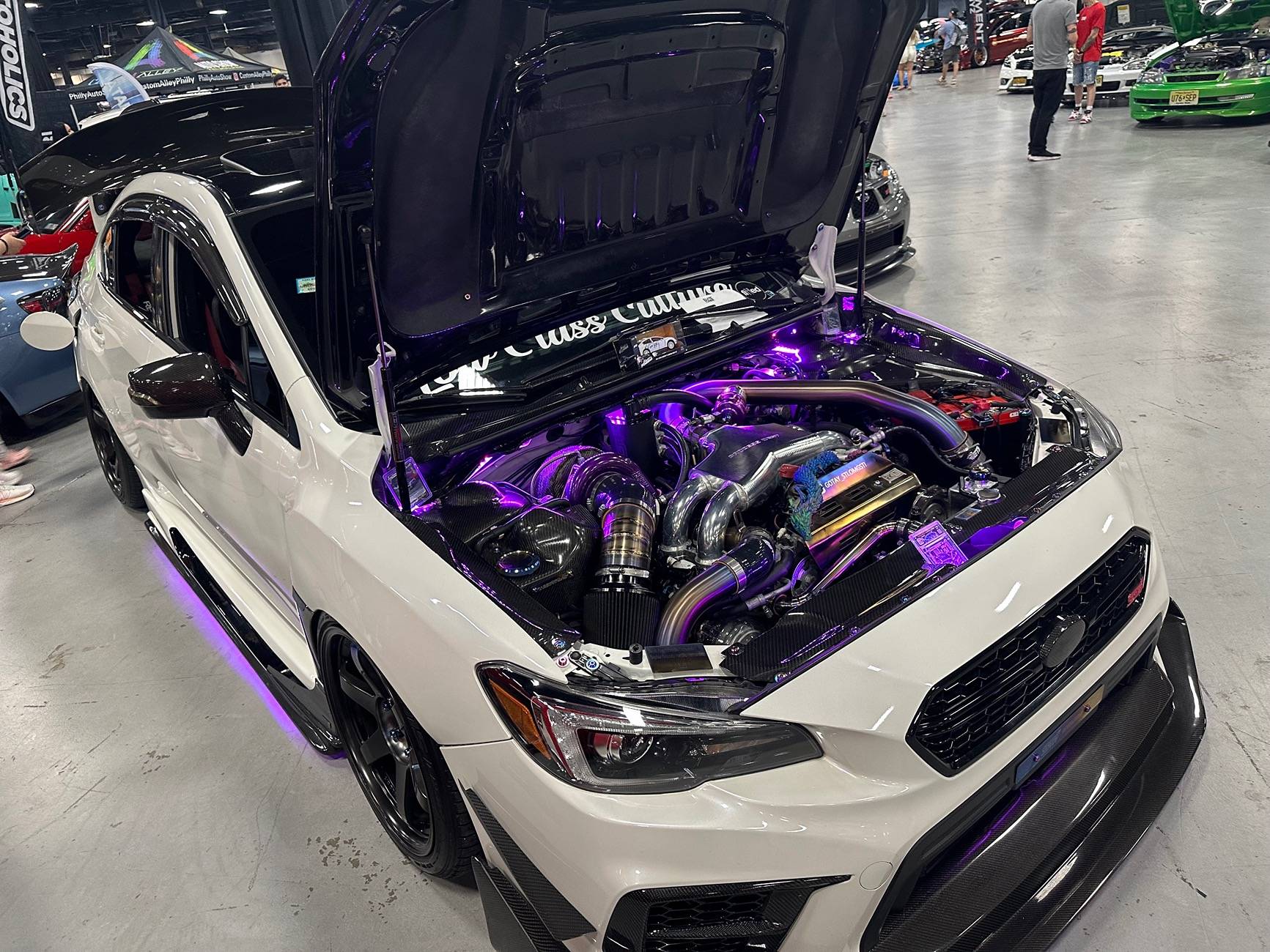

I know, just enjoy the building process, esp as I want to add a little flash to it after seeing this at a show
Yeah that's a totally different use case, knock yourself out. @keAiko18 has done the best with the comprehensive aesthetics I've seen to date on this platform.
