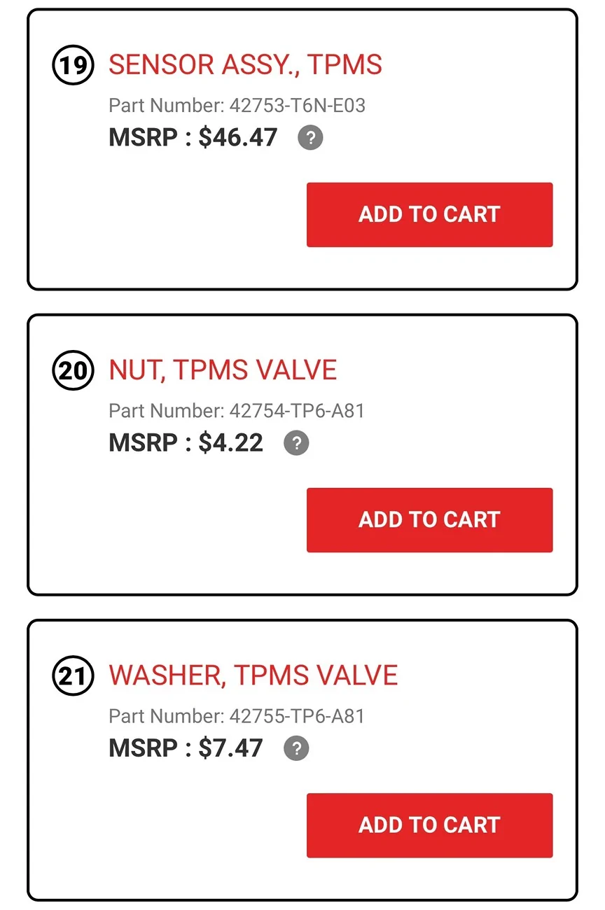

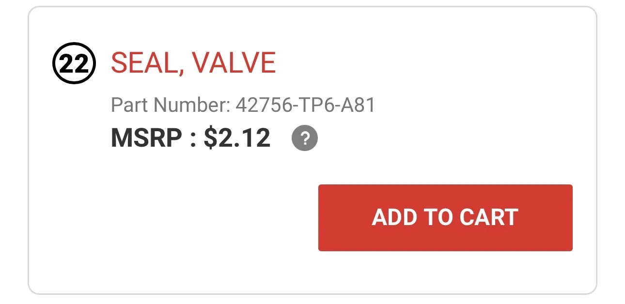

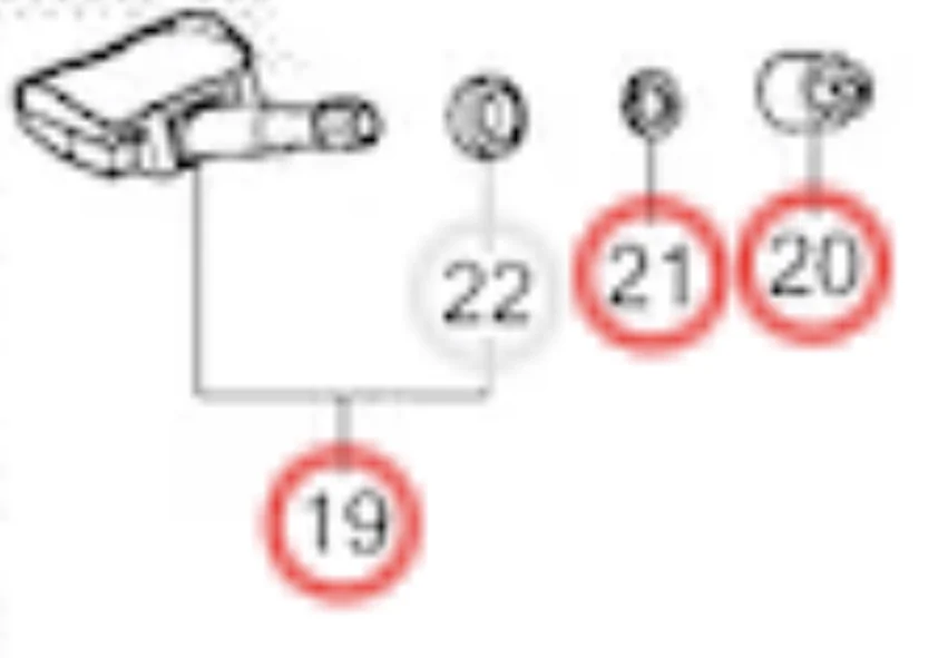

Do you know if I need to pick up #22 separately? I would assume it's included in #19 given the diagram.
Acura Integra Wheel Fitment Considerations: F vs R Offset (when does this become significant)? IMG_5835
Acura Integra Wheel Fitment Considerations: F vs R Offset (when does this become significant)? IMG_5836
1,903
1,336
Nope! It all comes together.
I will also note, it's not a screw in style valve, it's a clamp style. This means you don't screw a sensor onto the valve where you can position it in different ways, but instead you put the valve through, hold the sensor where it needs to be and then tighten to torque spec. You MUST follow torque spec here or the sensor or valve could easily be damaged. A third of an ugga-dugga is not a spec 😂 😅. I do not trust typical tire shops on this... I do this part myself. I would not let a shop "replace the valve core" as part of their installation service unless yours is damaged. I forget the exact service life, but it's something like 80k miles...

Do you happen to have the torque spec handy?
ABPDE5
787
642
ME
I do not, but I do recall it's written on the baggy or in the conti instruction sheet. It's not a lot! Like 7 or 8Nm. About 1/4th what I typically consider "hand tight".
