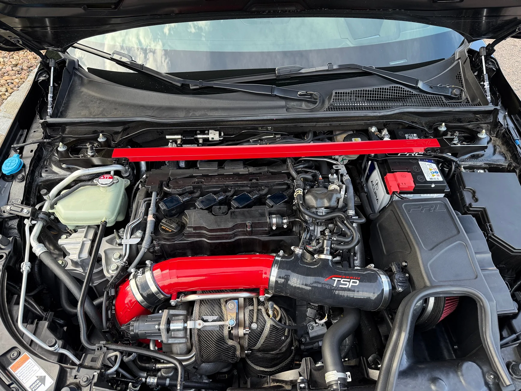

That's a great photo to show people why the wastegate rattles are so common.
You didn't want to put the heatshield back on after wrapping the turbo and downpipe?
The turbo/downpipe blanket replace the heat shields. Also, you can’t really mount the heat shields once the blankets are on.
Why can't you mount the heatshield back on? Covers the bolts?
I've got blankets sitting on a shelf waiting for me to make time still... And mountains of gold foil.
I'll take anything to cut down the heat transfer to the intake and surrounding bits. If that takes a custom shield, we'll just have to find a way 😊.
Correct, all of the mounting is covered with the blankets.
