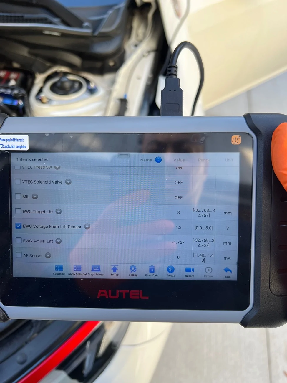

You need to reset the PCM/ECM and then adjust the screw to the wastegate actuator to read between 1.27 to 1.43. Volts. They probably removed the EWG from the turbo when drilling out the broken studs.
At startup, if voltage is not between that range the car will throw a P003A DTC and can’t calibrate the EWG.
I used an Autel Maxipro to clear the codes first and then reset the PCM/ECU with ignition on and engine off and adjusted the external wastegate actuator down to 1.3V, started up the car and it was able to read and recalibrate the EWG. Had to do this when I installed a Kuro in my FK8 and Kuro+ on my DE5.
Without resetting the PCM, I could not get voltage down between 1.27-1.43V. You will hear the EWG actuator extend and retract when you reset the PCM. It stays extended without resetting the PcM and you cannot get voltage down to proper calibration range for the ECU/PCM at startup.
