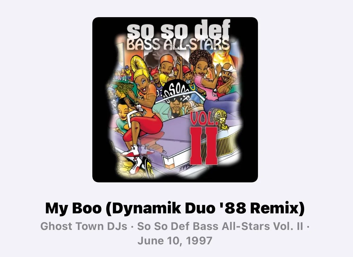

I have been unhappy with the bump in the ELS system and wanted to upgrade the woofer to get a little more umph but did not want to modify the stock box. I wanted some performance upgrade with very little work. So, when Palindrome Labs announced they were working on a kit, I jumped on the pre-order, and it arrived today. I just completed the Stage 1 upgrade of the stock ELS woofer to an AudioControl SPK-8S2 with the Palindrome Labs Subwoofer and Grille Kit. Here is a sound snippet before and after. I honestly feel it sounds a lot better and am happy with the outcome.
