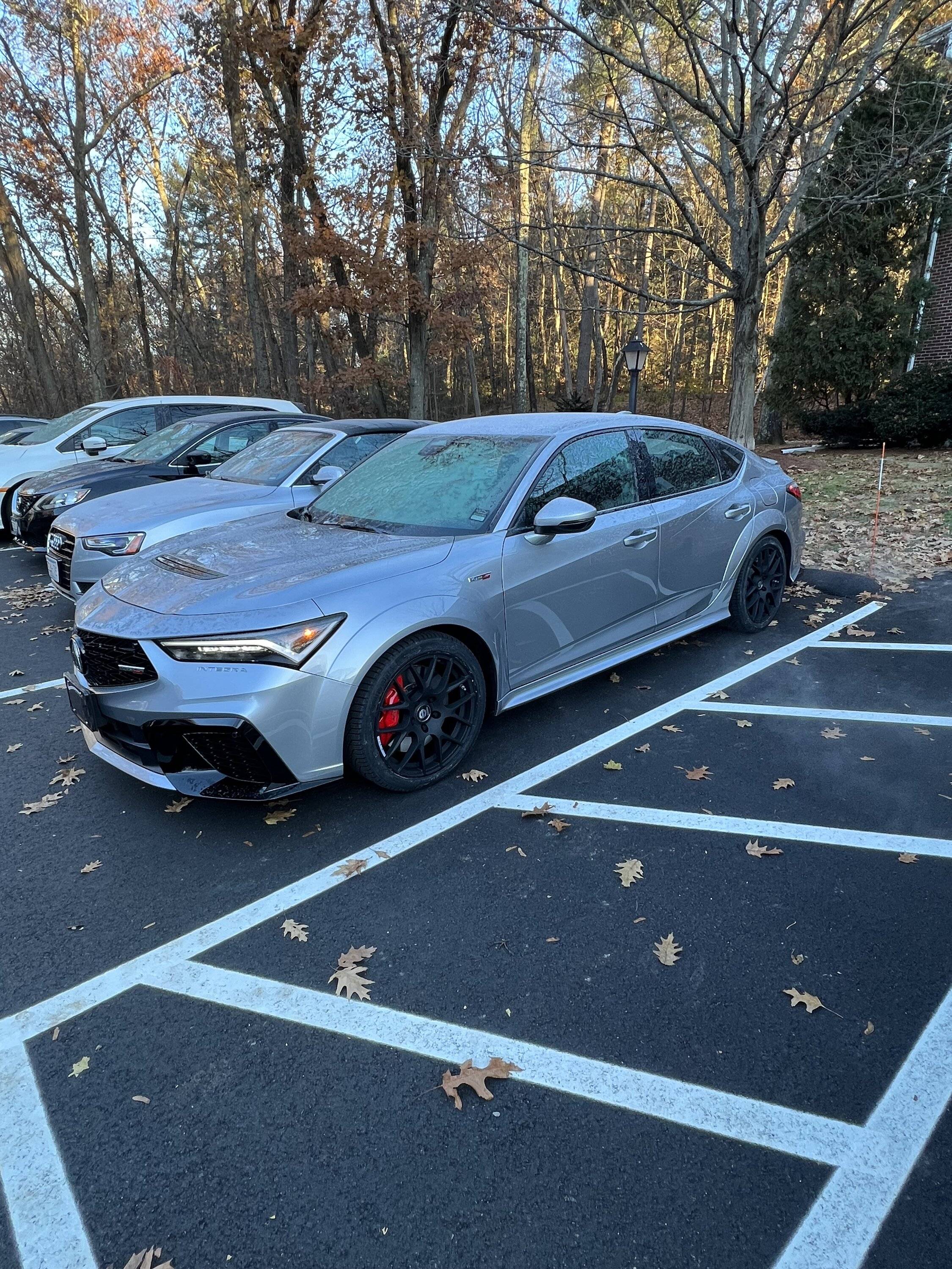

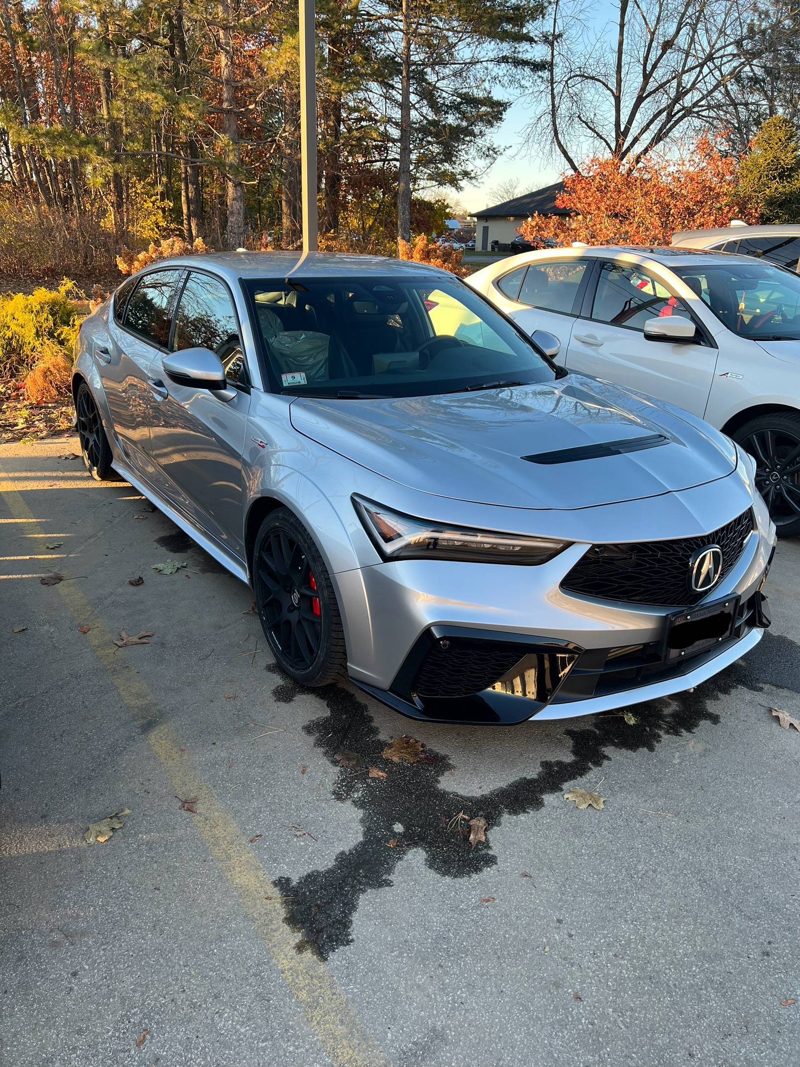

Just an FYI - those looking for winter tires for the OEM Type-S 19" wheels. I bought some Michelin Pilot Alpin PA 4 size 245/35 19 and they fit perfect. Some ppl were saying 245 would need to be stretched onto these wheels but they're wrong. After installing them Acura senior tech said they're perfect, 0 stretch. I bought them from kijiji for $550 with 10/32 nds, would have cost over 2k new.
Anyway, just a heads up if anyone comes across these and is wondering if they'll fit the stock wheels.

Interesting, I have the same tires, same size, but the rims do not stick out like that . Wondering if the installation at Acura by "thier superior machine" (service managers words) mitigated that.
Mine were also installed by the dealership.
