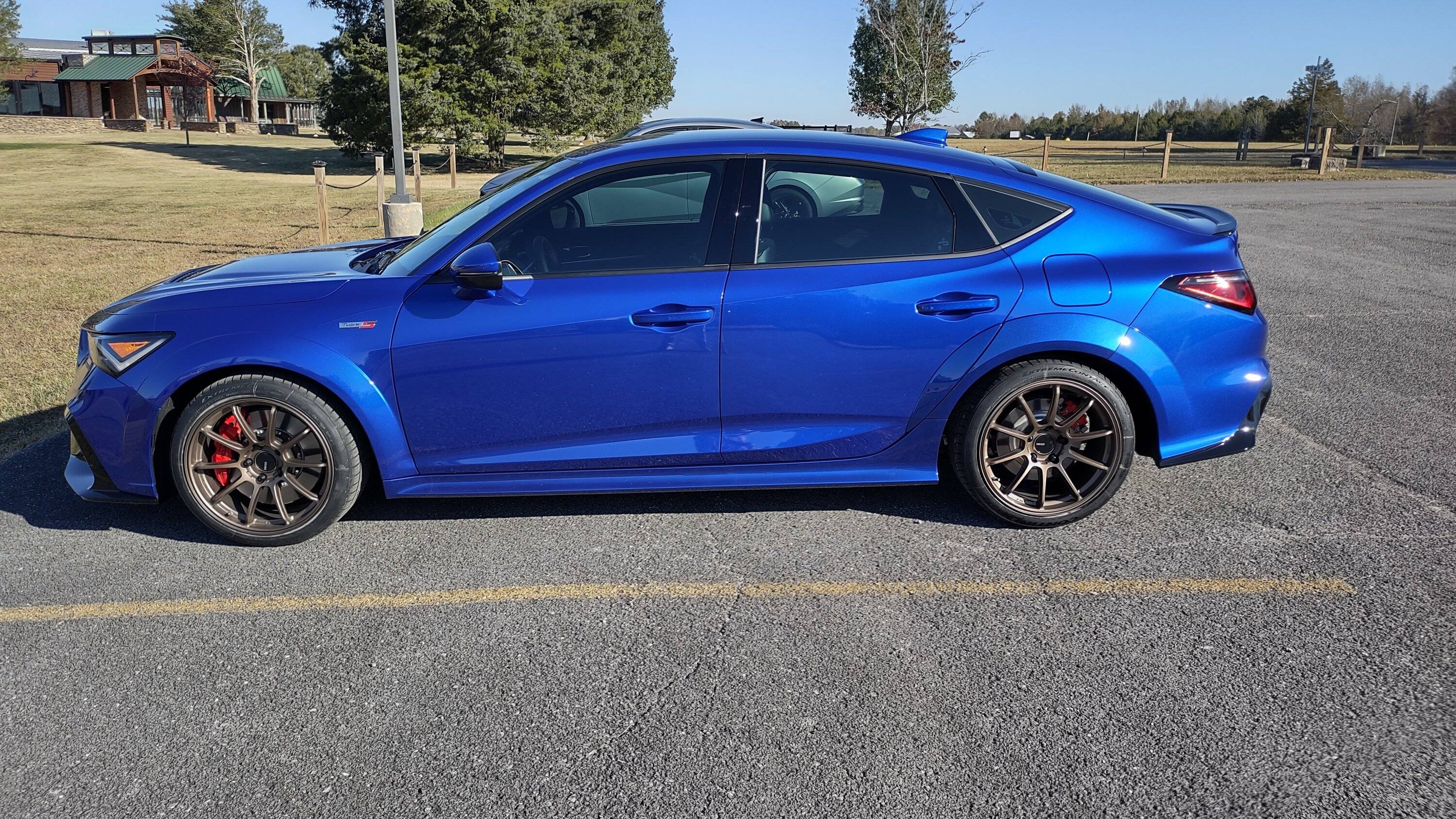

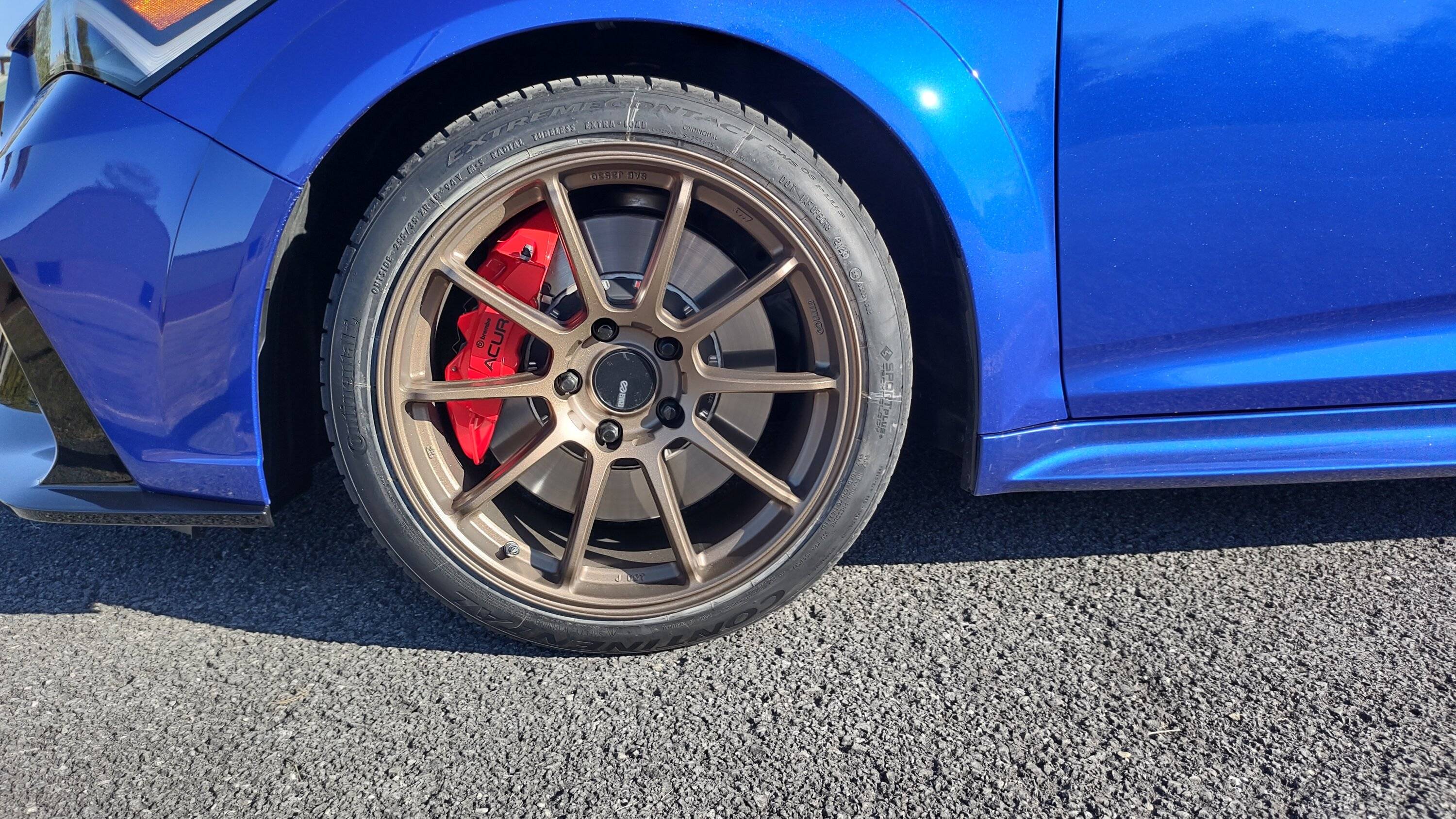

Got my TN Winter setup yesterday, bought the combo on Tire Rack, shipped it directly to my Discount Tire Store as they now own Tire Rack as of a couple of years ago. They only charged $20 for the swap install. Enkei Triumph in Matte Bronze, 18×9.5 +45, Continental Extreme DWS06's 255/35/18.
Acura Integra Type S Winter Wheels / Fitment Specs IMG_20231103_094919871_HDR
Acura Integra Type S Winter Wheels / Fitment Specs IMG_20231103_094904913_HDR

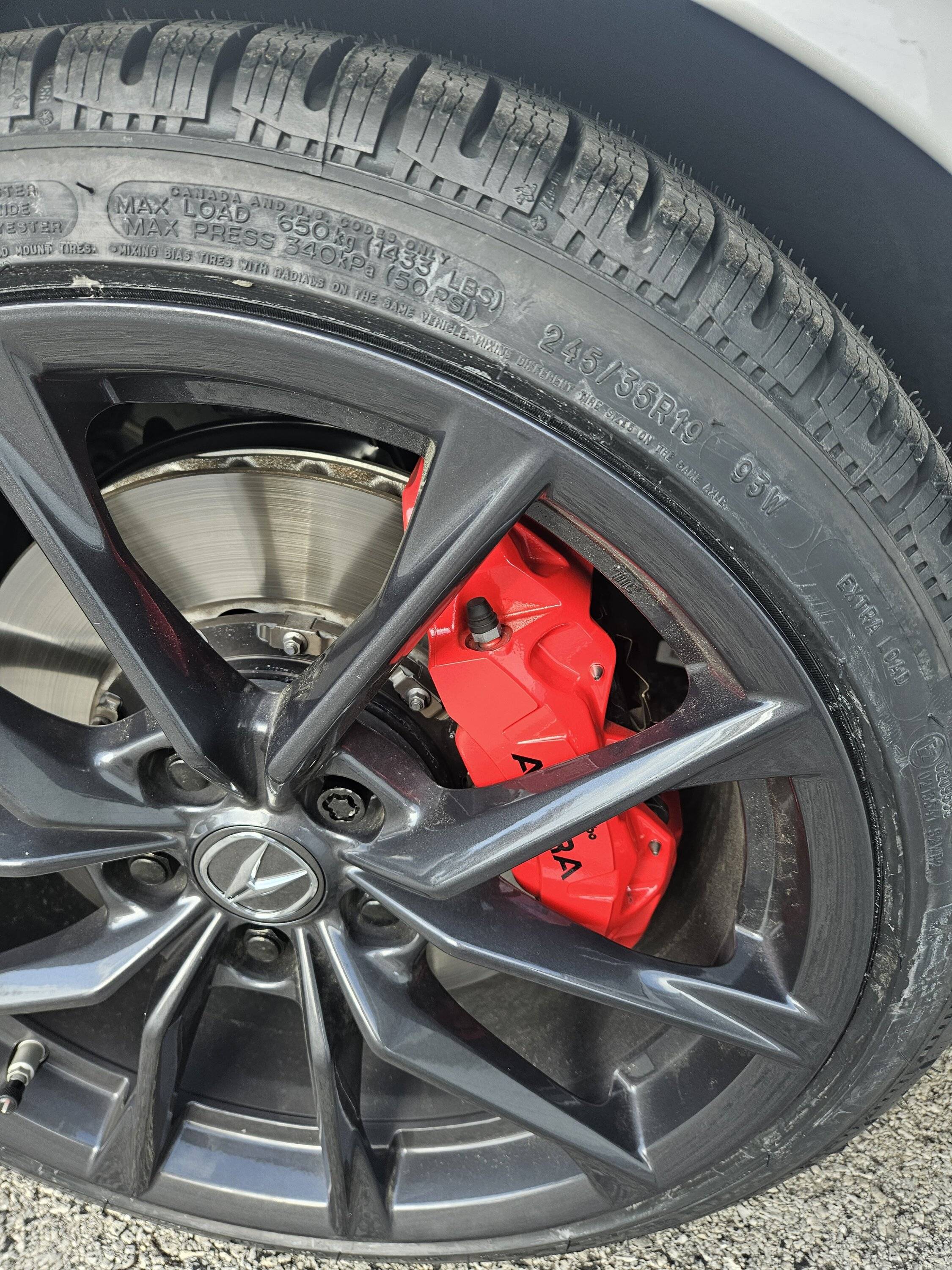

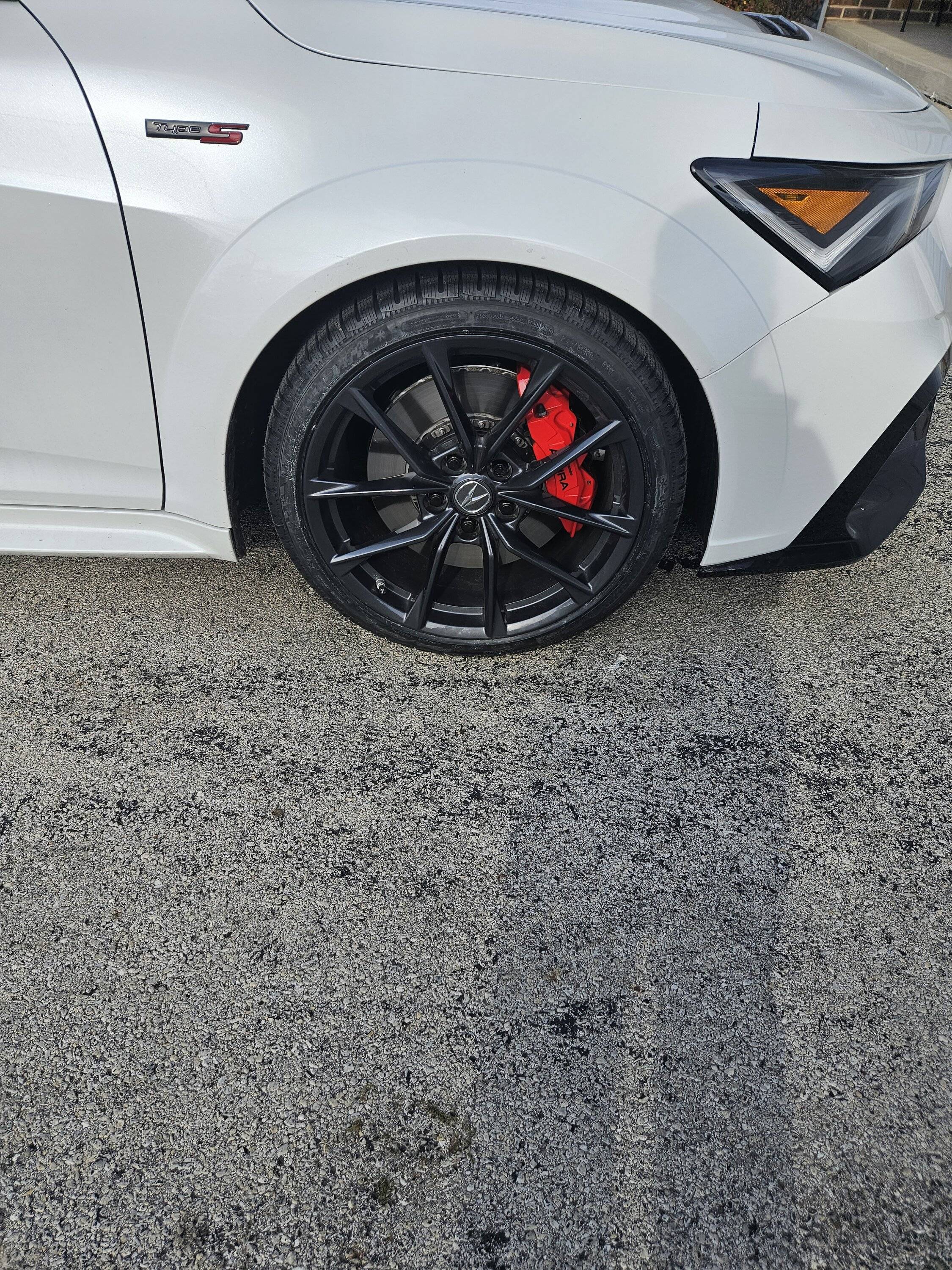

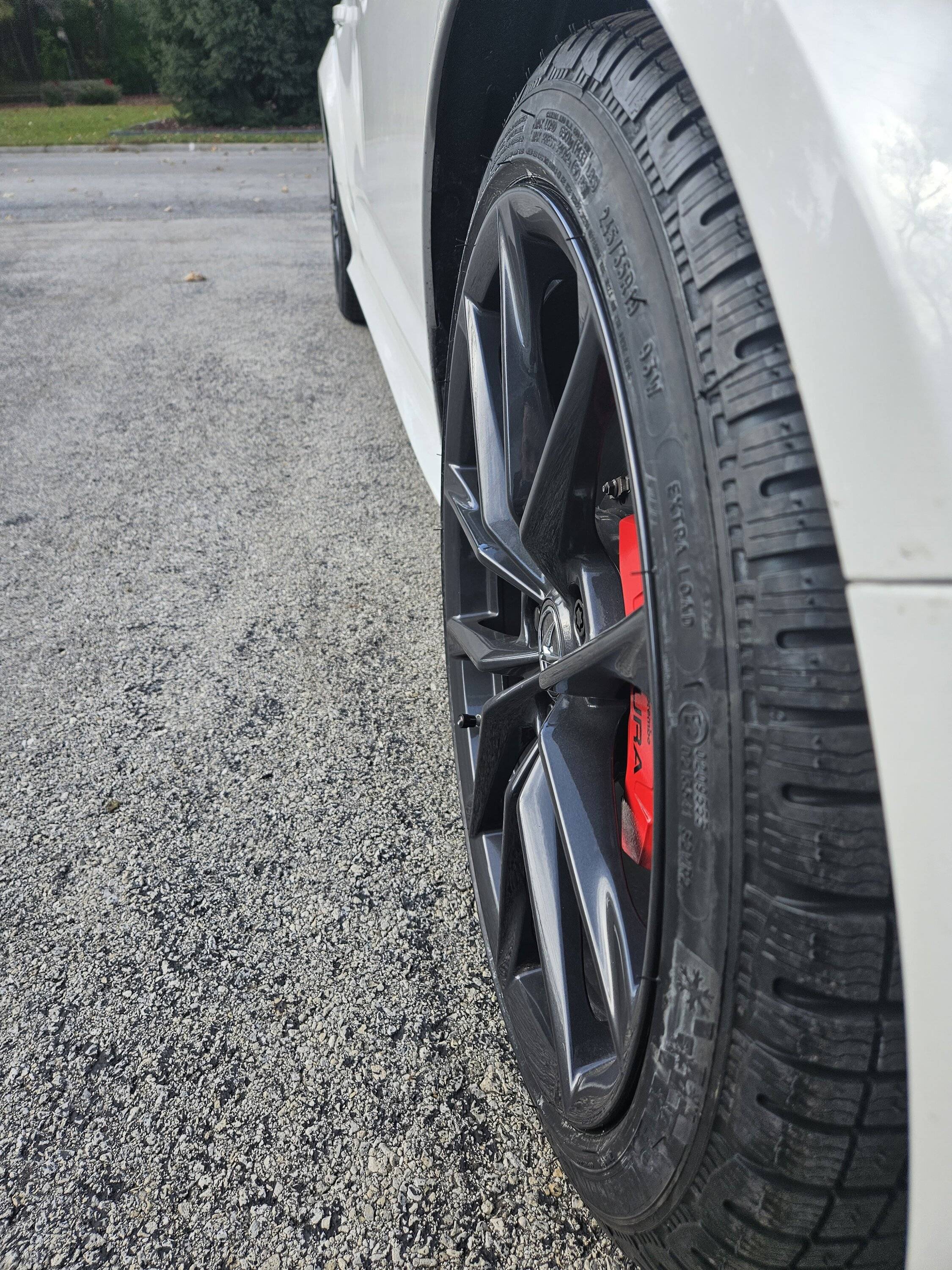

I spoke with a representative at Tire Rack who suggested Michelin Pilot Alpin PA4 XL in 245 35R 19. I had them installed today on the spare oem wheels included in the "launch package".
Acura Integra Type S Winter Wheels / Fitment Specs 20231106_122119
Acura Integra Type S Winter Wheels / Fitment Specs 20231106_122112
Acura Integra Type S Winter Wheels / Fitment Specs 20231106_122058
Wow that's narrow.

Tire Rack called me personally when I ordered 255/35/19 to question my choice.. Odd they recommended 245/35 :hmm:
That's exactly how the conversation started. They wanted to confirm my order for 255/35 19 wasn't a mistake. I explained what I was looking for (winter setup on oem) and he suggested the 245/35.

Mich Alpin 4 rocked on my 4x4 Focus RS...Narrow tires are whats needed for the deep snow cut threw instead of riding on top...Being in Chicago I'm sure they will come in handy
