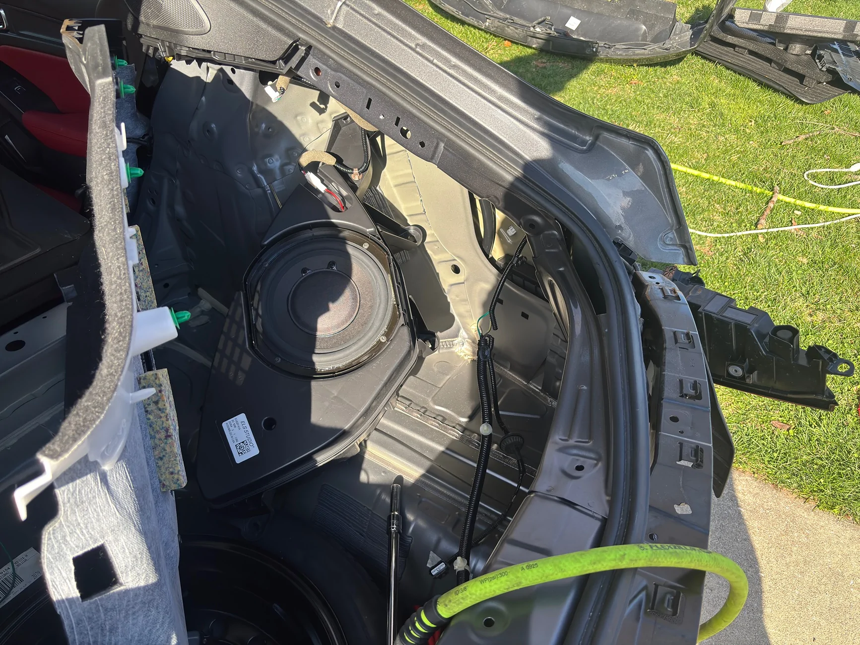

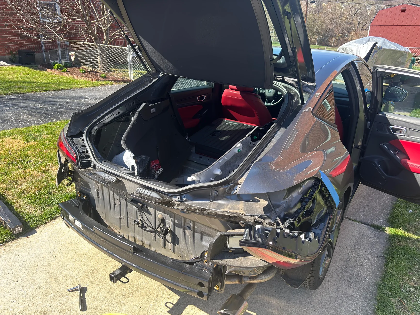

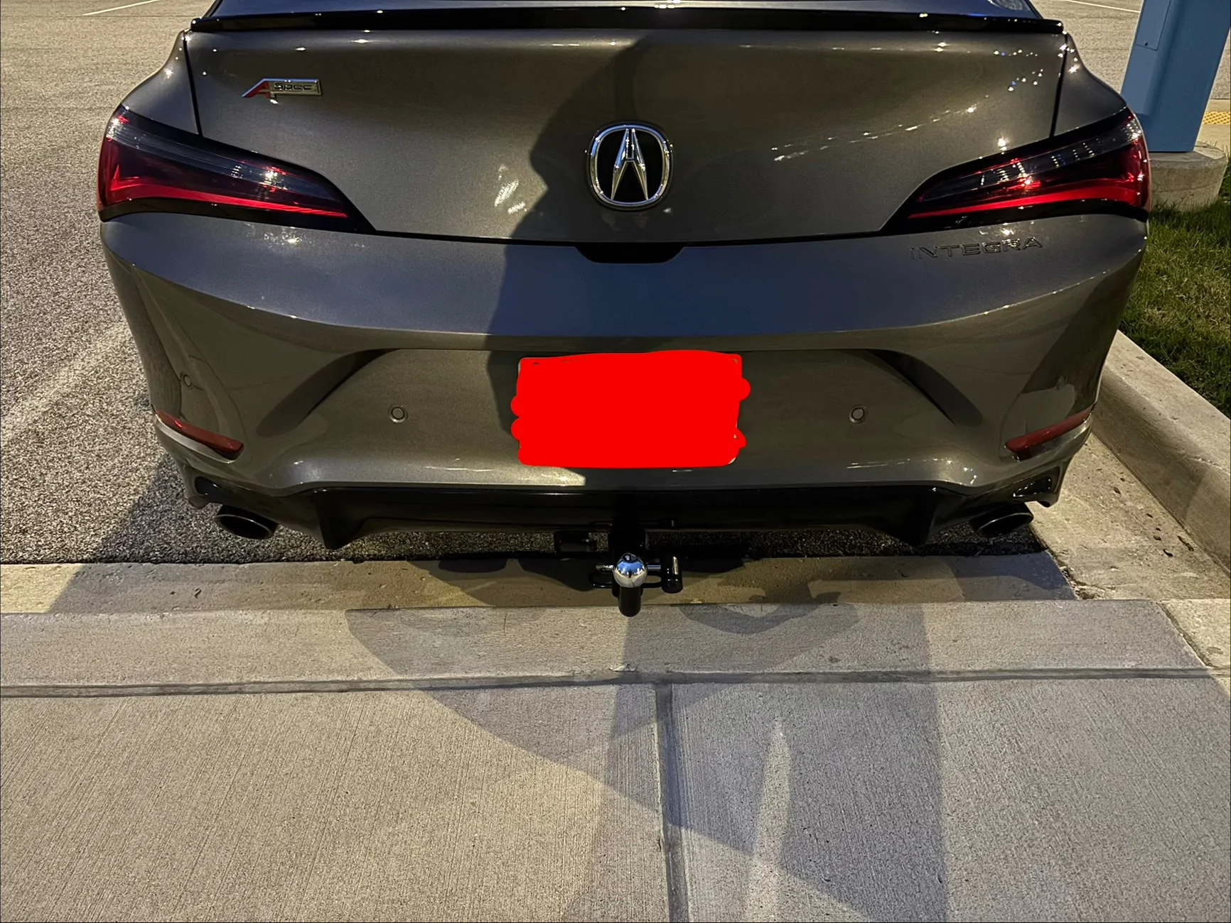

I installed Curt hitch 11591 (for Honda civic) on my 2023 Integra this week with no issues. I did not have to cut the crash bar, I didn’t have to bend the metal tab out of the way etc. It was straightforward. I cut the same size slot in the Integra diffuser as what the instructions specified for the civic and everything fit properly.
As far as electrical wiring goes, there’s no plug-in solution for tapping into the tail lights - I had to tap into the wiring. On the left tail light, the sky blue wire was the left blinker, green wire is the brake light, and the yellow wire is the tail/running light. On the right tail light, there are two green wires, one of them is the right blinker… I couldn’t tell a difference in color between the two wires. You do not need to remove the tail lights, and I’d recommend not removing them. I broke a plastic piece on one of mine, and removal was unnecessary. If you do decide to remove them for whatever reason, pull it out from the side of the car. I pulled rearwards on the right tail light and broke a plastic piece. On the right tail light, I found it easiest to unbolt the subwoofer and move it, and unclip the blind spot sensor and feed it into the car, to give me more room to work on the wire harness. For the trailer wiring, I cut the trailer wires and fed them back through the center grommet, and left 6” of wire on the inside of the car to reconnect the wires there.
