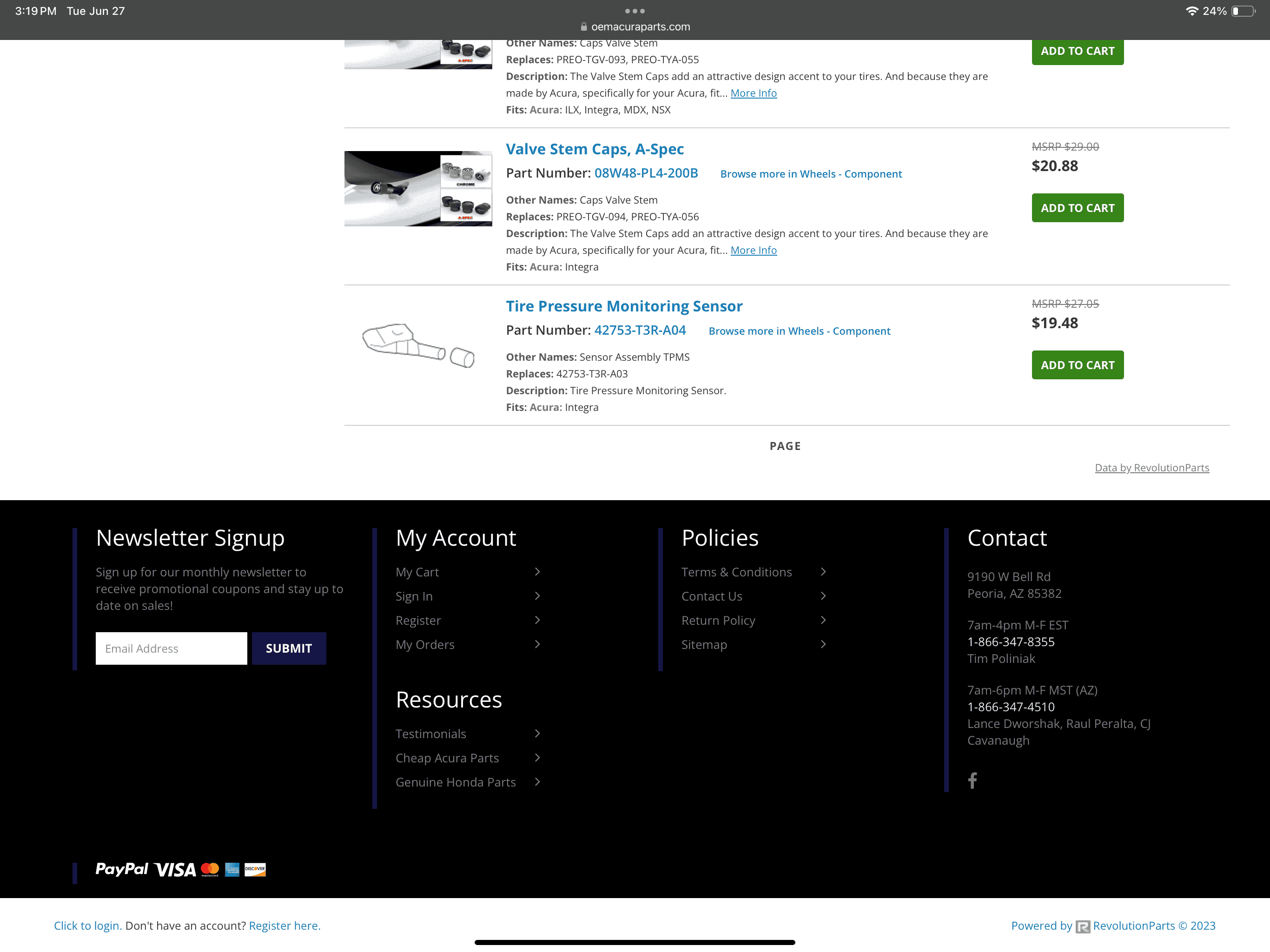

Let us know how it works for u and what you ended up going with tpms sensor wise. I'm also confused with which TPMS sensors to get as the official part number for the ITS is different from other ones that acura uses. I don't think they need to be programed. When I was reading about others with Acura s they just bought some tpms sensors off ebay and the car reads them just fine.

This was what I was talking about with the two part numbers for tpms sensor. One was when I just looked up integras one was specifically for ITS. First part of the part number is the same before the first dash. Maybe someone knows if the other parts actually mean something.
