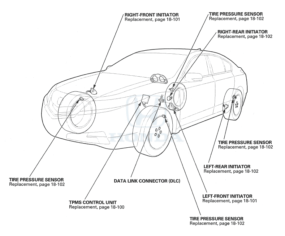

Thanks for information. I found some additional information regarding TPMS for Acura vehicles but wasn't sure if it was also applicable for this new Integra model. Based on your experience, it would seem that each TPMS Sensor on the wheel transmits to the four Initiators which sends the info back to the TPMS Control Unit. No programming needed as long as the TPMS Sensors are the 433Mhz units.
Your TPMS from TireRack is this one with rigid aluminum stem and not a rubber stem, correct?
