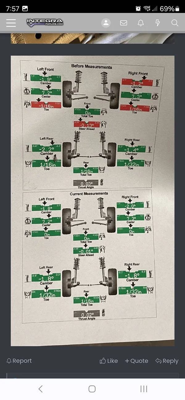

They've lasted 25-30k for me on other cars. About 17k on my wife's q7 now and still at 5.5/32nds or so, and the Q7 has far more torque and hook off the line (where a lot of wear occurs). Not to mention weight.
When I took my summers off at 4.5k mi, the wear was 1/32nd or so, and that includes one day at the track, which is surprising since I've eaten a whole set of new ps4s on a cayman during a private day before. Granted the alignment is aggressive on the street and the factory toe I had was way out of spec in the its. It was aligned at 1200 miles by the dealer with the alignment pins pulled before the track event. 0 toe front and 1/32nd toe in in rear, -1.9ish front camber and -1.8 rear.
I'd recommend an alignment for any new or used car purchase... Just look at the "before" on this car. It's pretty atrocious.

I am not 100% sure, but I think I’ve seen worse premature wear with out of spec toe than out of spec camber.
