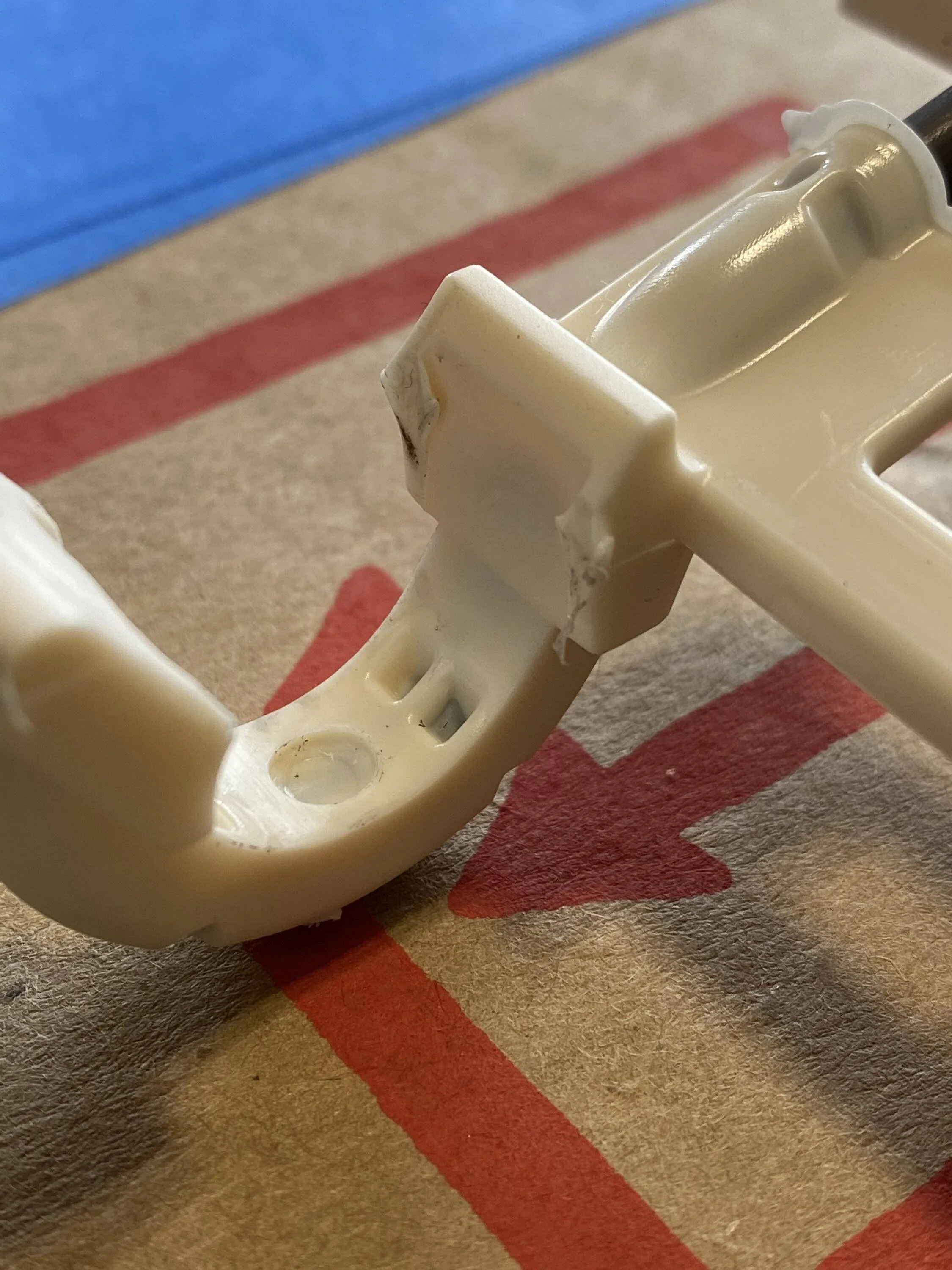

Third attempt (where we are now): I dropped off the car last week. The manager had ordered a new seat and frame to install. He called me yesterday saying the completely took the seat apart and saw a plastic piece that was broken up (see attached picture). He thinks it's a design flaw and contacted corporate. This info may be useful to you if you're getting push back from your local dealership. He said he should have a solution by next week.

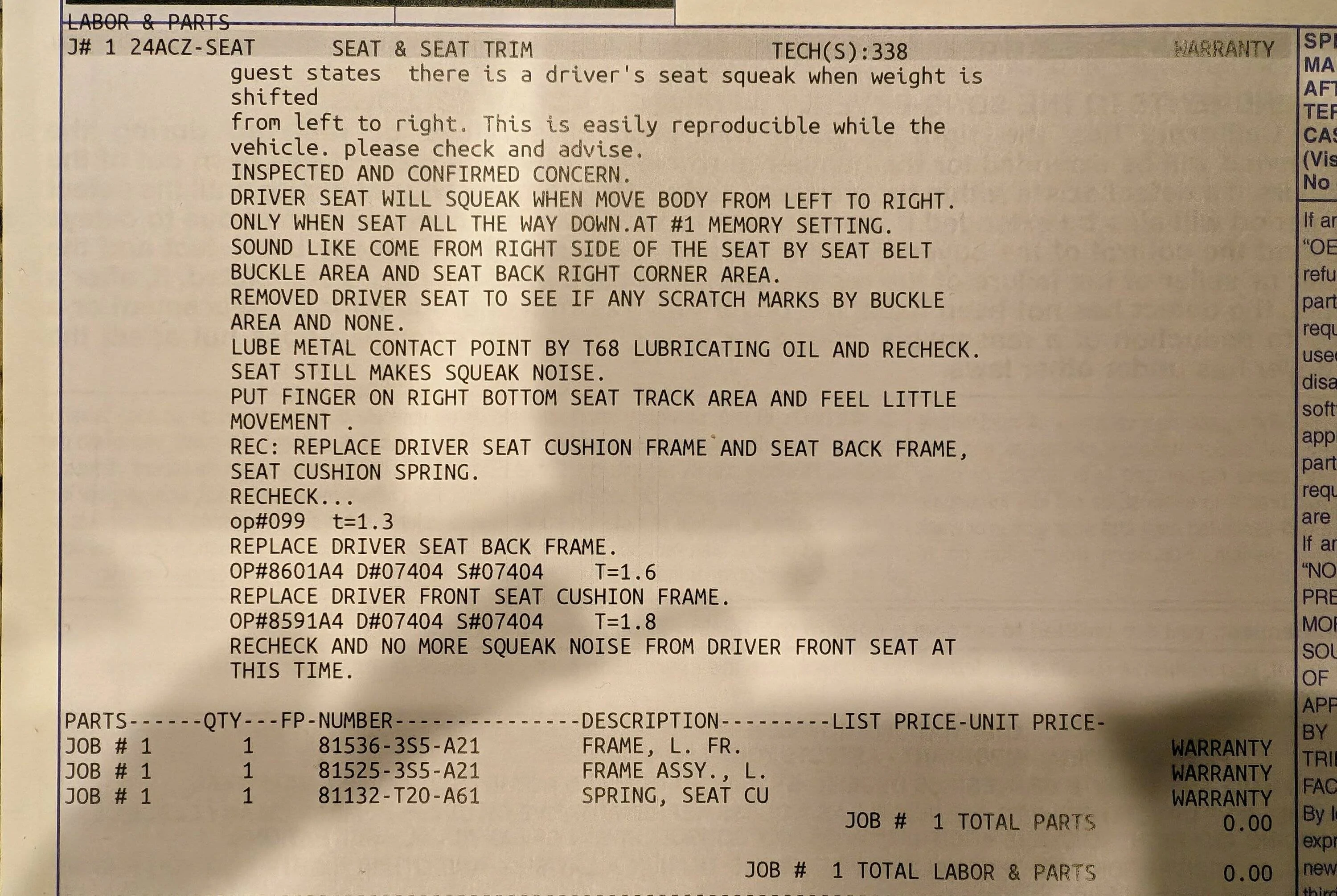

2024 Acura Integra A-Spec w/Technology 6MT
Chiming in as a 2024 A-Spec owner, my dealer took the car with no hassle and within the day ordered the parts to replace the seat frame and seat cushion spring. It's only been a week since I got the car back but the squeak seems to be gone.
Acura Integra Squeaky / creak noise from driver seat? integraSeatWarranty
