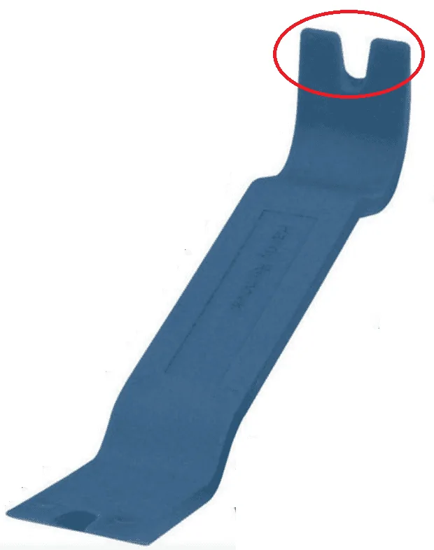

I used this plastic panel/trim removal tool and gently forced the circled two prong end between the silver and black rings. It seemed pretty easy doing it this way.
Acura Integra Shift knob removal prytool

Thanks acurax, I have a similar prying tool.
Stupid collar broke. Let it be known that I did not gorilla the collar off. Instead, I carefully pried different areas, angles, and even rotated the collar in various positions. I incrementally added more force with time until the collar gave way, but what really happened was that the plastic clips wore down and broke from stress. Hate to spend $$$ on the entire boot assembly, so I'm going to attempt to repair the collar, but does anyone have a spare lying around? In any case, l will attempt to show what broke to save the next person some grief.
