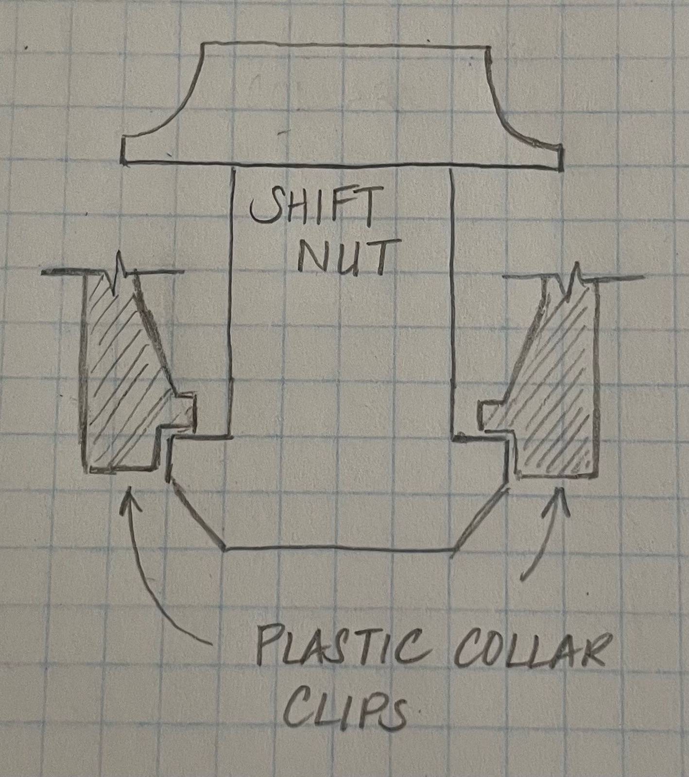

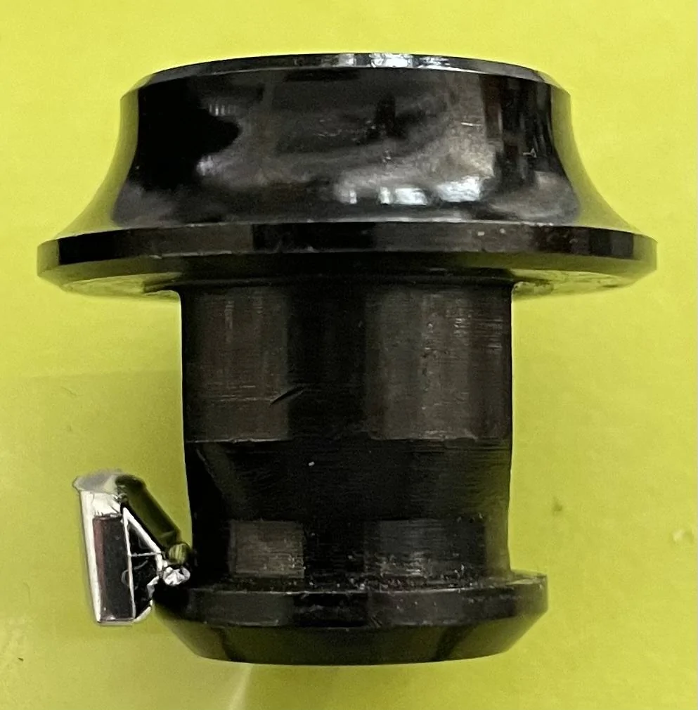

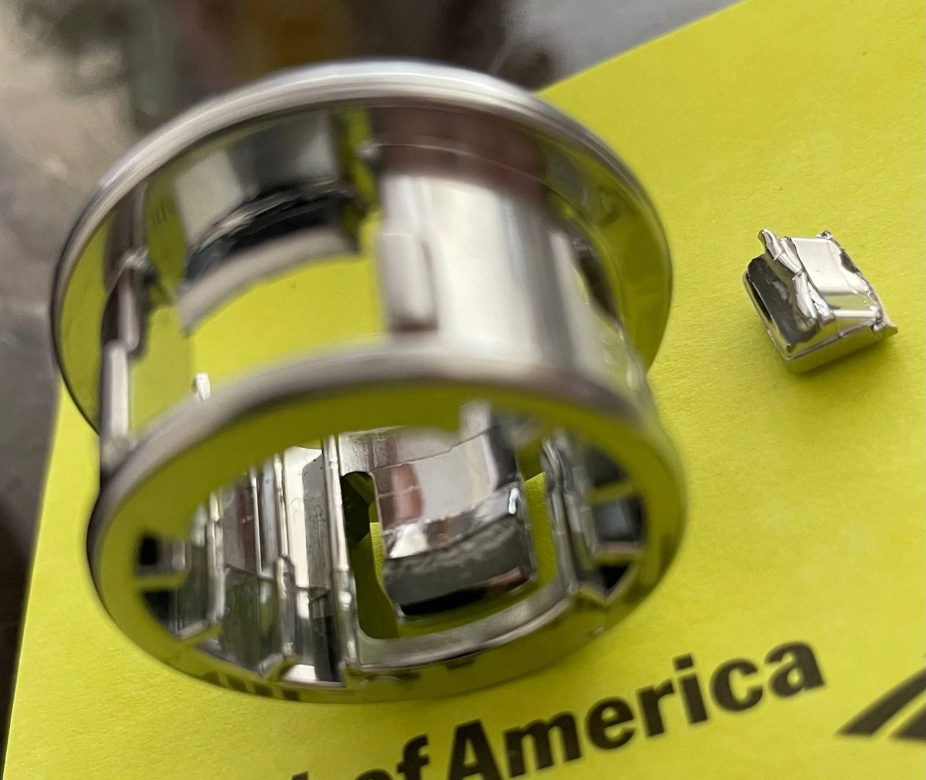

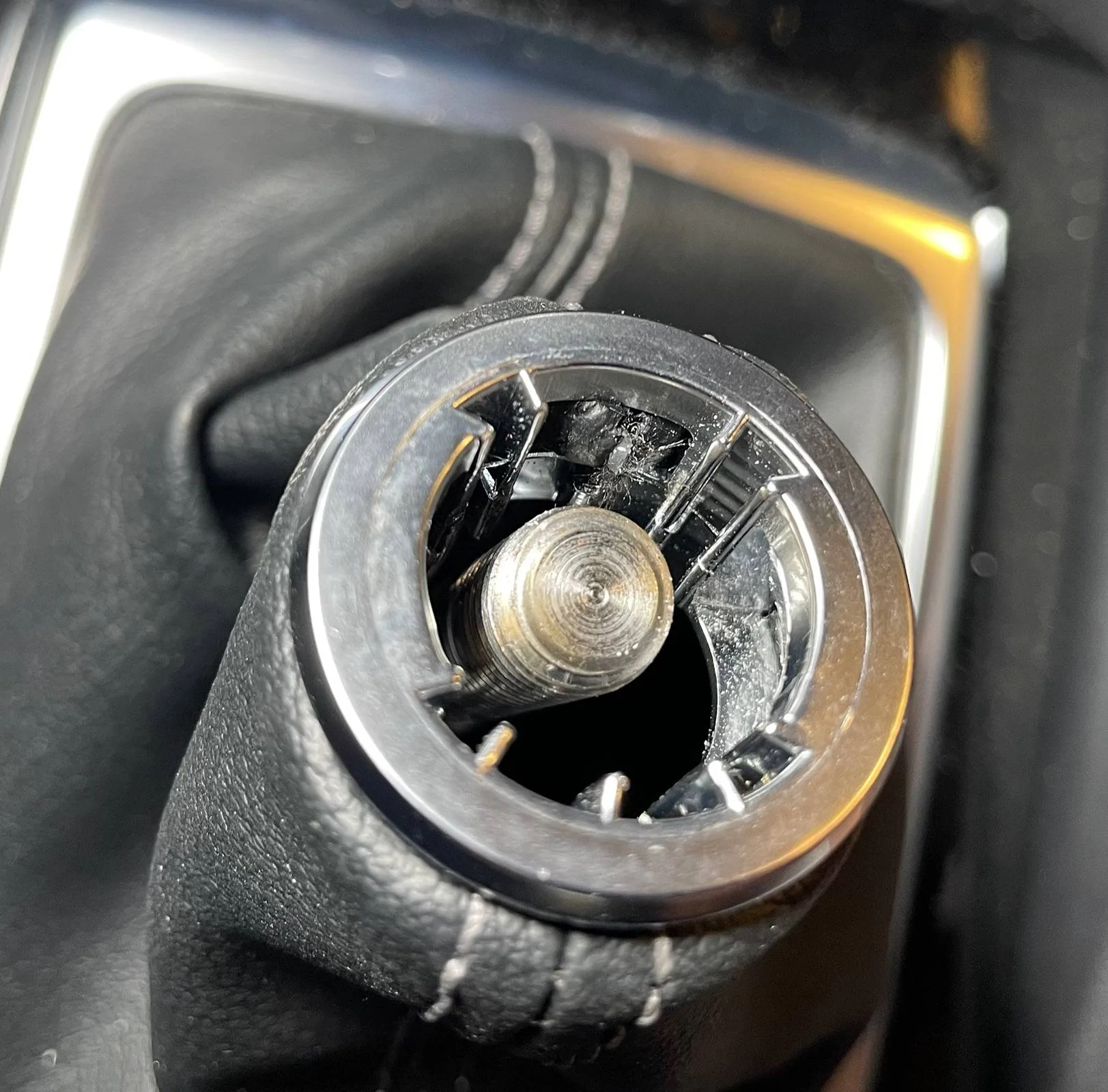

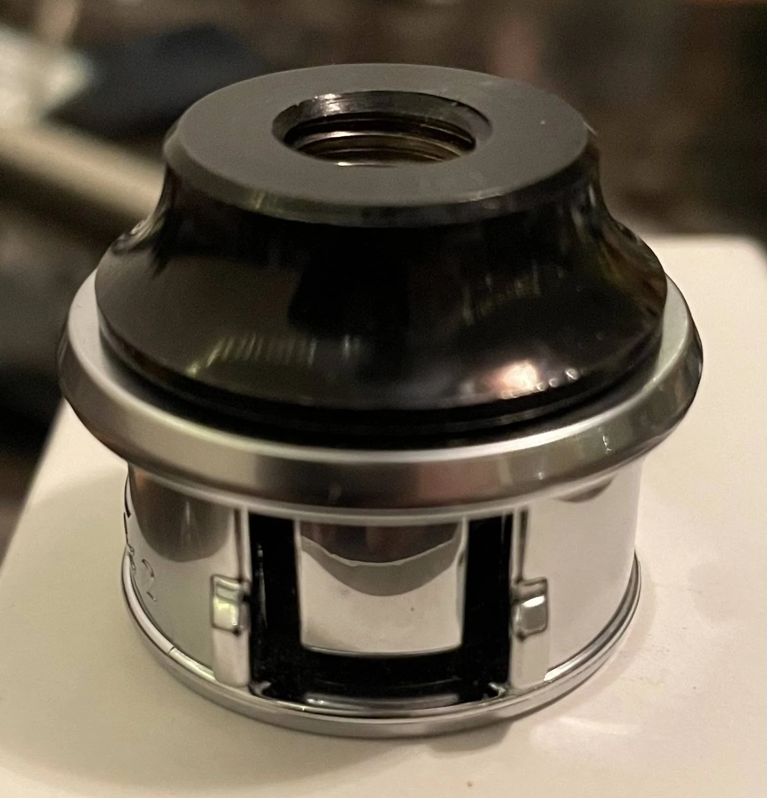

Here are some close ups of the interface. Clips are located at the 9 and 3 o’clock positions, and if you can somehow access and assist or pry from the shift nut, it will minimize the chance of damage.
