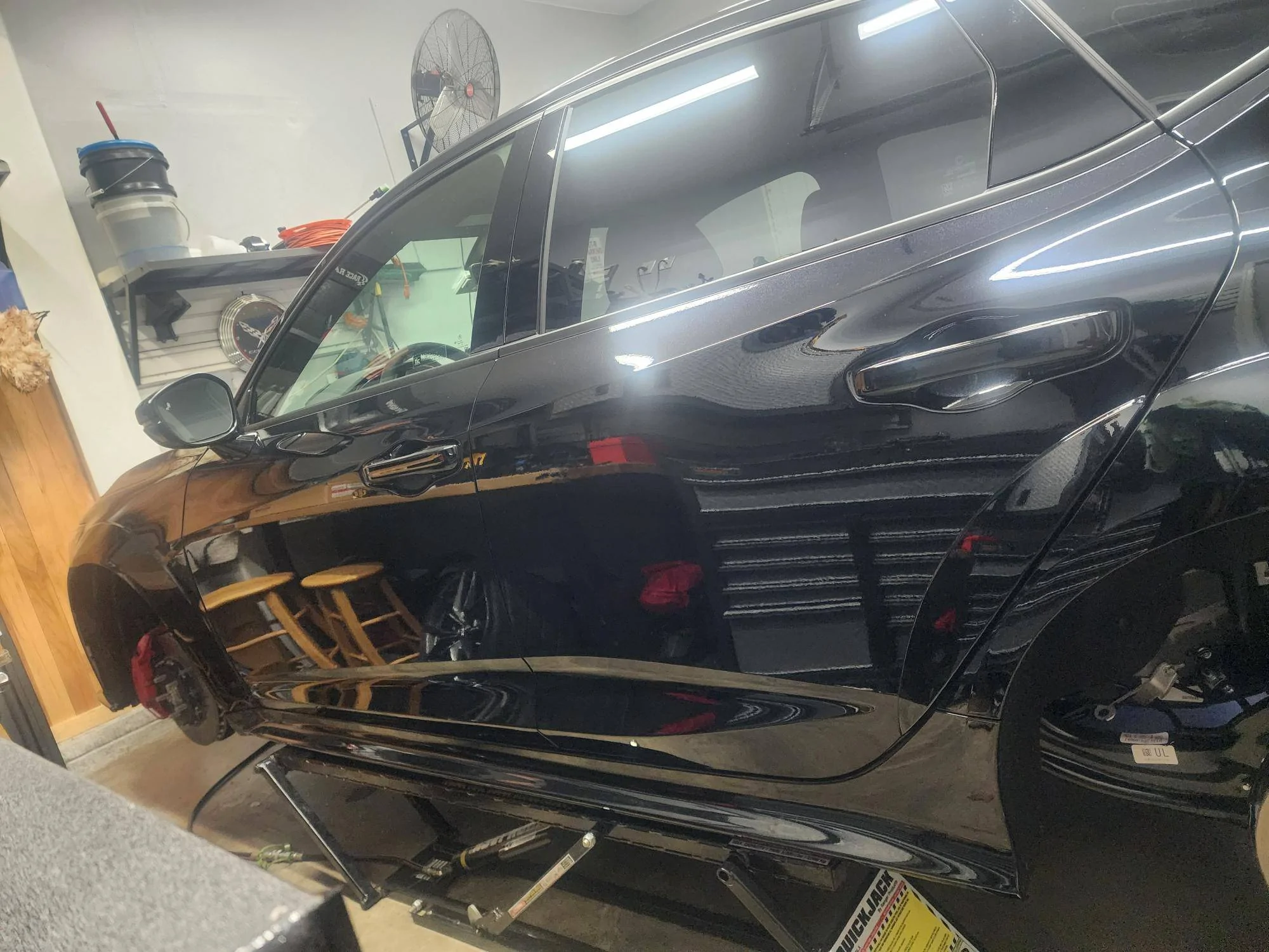

crepr12
Sep 2, 2023
261
153
North East
24 ITS Black on Black
Get the TLX...mines the standard length and its a lil sketchy...I'll most likley get the extenders

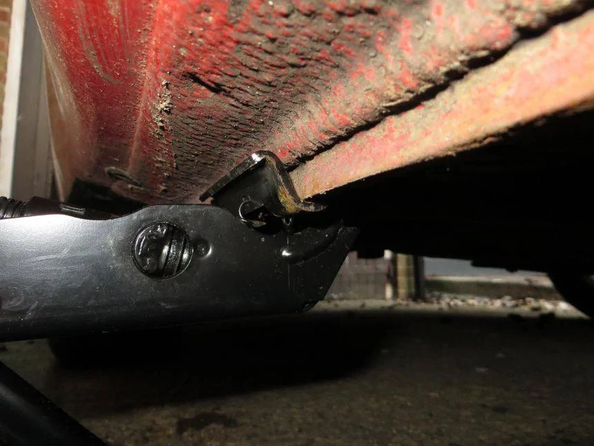

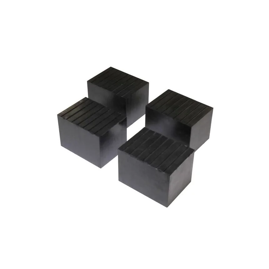

right but people were stating that the rubber blocks that come with it dont fit the lifting points on the car
Standard blocks just have these little dimples.
Pinch weld blocks have a cut in them.
It's not a picture of the ITS and it's a professional lift, but it's probably the easiest picture to demonstrate how the blocks would go around the pinch welds.
