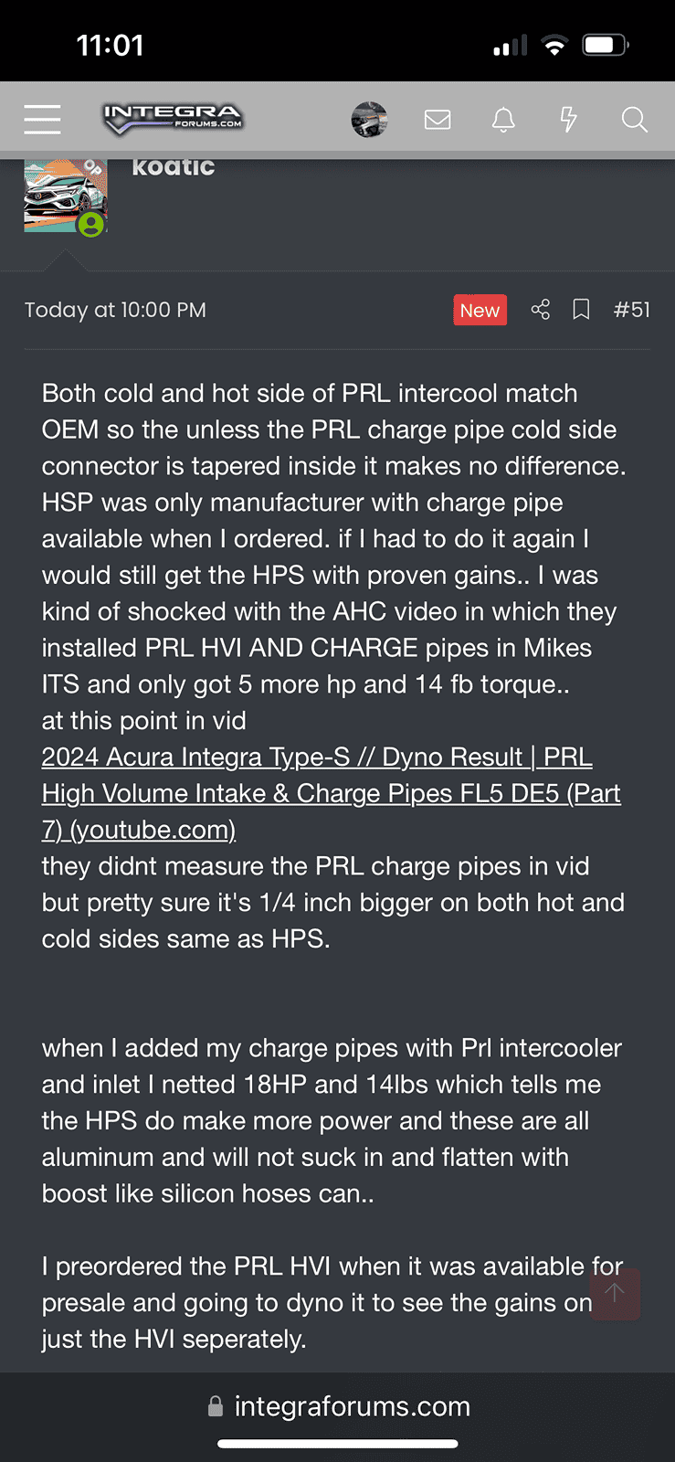

@koatic did a dyno pull with the HPS though and pulled 18 HP and 14TQ.

I have videos of installing the intercooler which included the front emblem on mine..
Beware of the side clips labeled incorrectly in the instructions..
you can see my video below to see the clip I broke if this helps you.
was only about 4 dollars to replace but it is required for bumper to be flush.
my HPS charge pipe install and dyno numbers vids on the channel too if your curious about the charge pipes.
