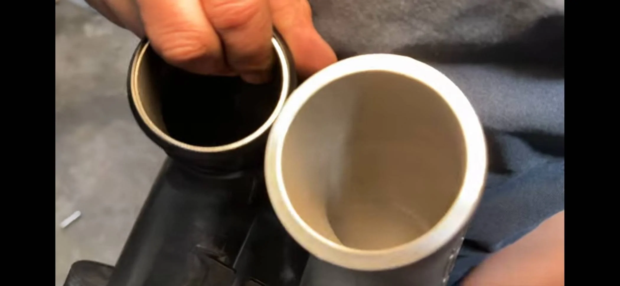

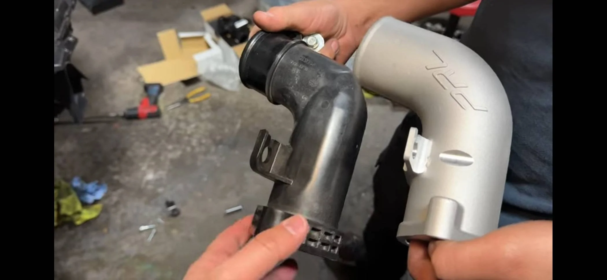

Close ups of the additional PRL cold side inlet for reference.
I still feel like the rigidity of the full aluminum HPS set would be more beneficial at higher hp applications, but that inlet size difference seems huge.

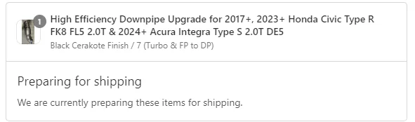

Yes its the TSP and I ordered it black Cerakoted with the 7 titanium studs.. Just checked status and of course still preparing for shipping..
with the studs, do you have to torque them into the turbo? Or just tighten them, then torque the downpipe
