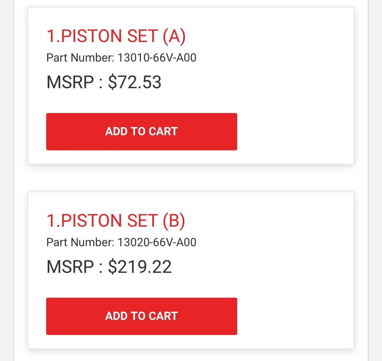

K20c8 is same as c1 as far as part numbers between honda and Acura parts catalog expect for pistons. Block, head, cams, rods, and more are same part number.
ABPDE5
796
650
ME
Interesting... where did you get this info?
I had been under the understanding they were identical. When I check Dreamshop, the piston part #s are the same
Piston Set (A) - 13010-66V-A00
Piston Set (B) - 13020-66V-A00
Shows for both the Type-R and the Type-S.
I’m a Honda dealer tech. The pistons are compatible. So yes they would fit a type r.

Both cars show both piston sets, though. When I look in the parts catalogue under: Engine > Crankshaft - Piston... all parts in the Type-R catalog and all parts in the Type-S catalog have the exact same part #s (i.e. both Type-R and Type-S show as in the attached).
Where are you seeing varying part #s? Are you suggesting one car uses only Set (A) and one car uses only Set (B), even though both sets show up under both cars?
The DE5 and FL5 motors are the exact same, tune is only difference from what I understand.
I was comparing to fk8 (I own a 10th gen civic), I will check for fl5 when I get off lunch.

11th gen c1/teggy c8 is same everything just stamped different. Fk8 is same everything but pistons (13010/20-rpy-g01). Not sure what’s different about these new ones.
Interesting! Thanks for checking.

Follow up... any chance you can use your inside info to find out what was changed? Just curious.
3,443
2,932
I believe they coated them differently in the FL5/DE5

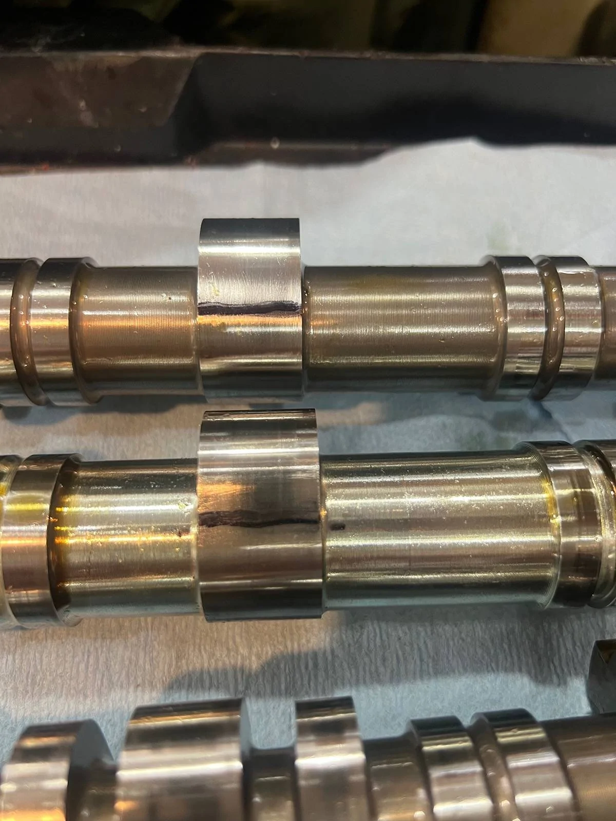

This statement about the rods is in accurate and it’s all tuning error. I’ve pushed well over 100 of them beyond 400ft lbs and up to as much as 450 torque with no issues. I’ve even got customer with 95k on the clock making 620whp and 445tq on a dynojet. Not some hub dyno. The trans will break first if tuned right.
The camshafts have nothing to do with hp it torque. It’s people banging the rev limit all day and miss shifting causes the intake cam reluctor to move which is only pressed on. Since the DE5 Fl5 and fk8 all use the same exact part for the intake camshaft they will have the same issues.
One of biggest issues are filter assemblies clogging from ethanol causing misfires and lack of understanding of direct injection again having misfires and people just beating on them in that state rather than figuring out the issues. The problem is both direct injection and bad spark plugs can cause misfires, however understanding where it happens in the RPM range will give a legitimate tuner who understands direct injection as to which is the actual problem.
When you push a direct injector too far it misfires, and when you misfire under a heavy load you can cause severe damage because your engine is no longer in a balanced state, and you will literally shake it apart.

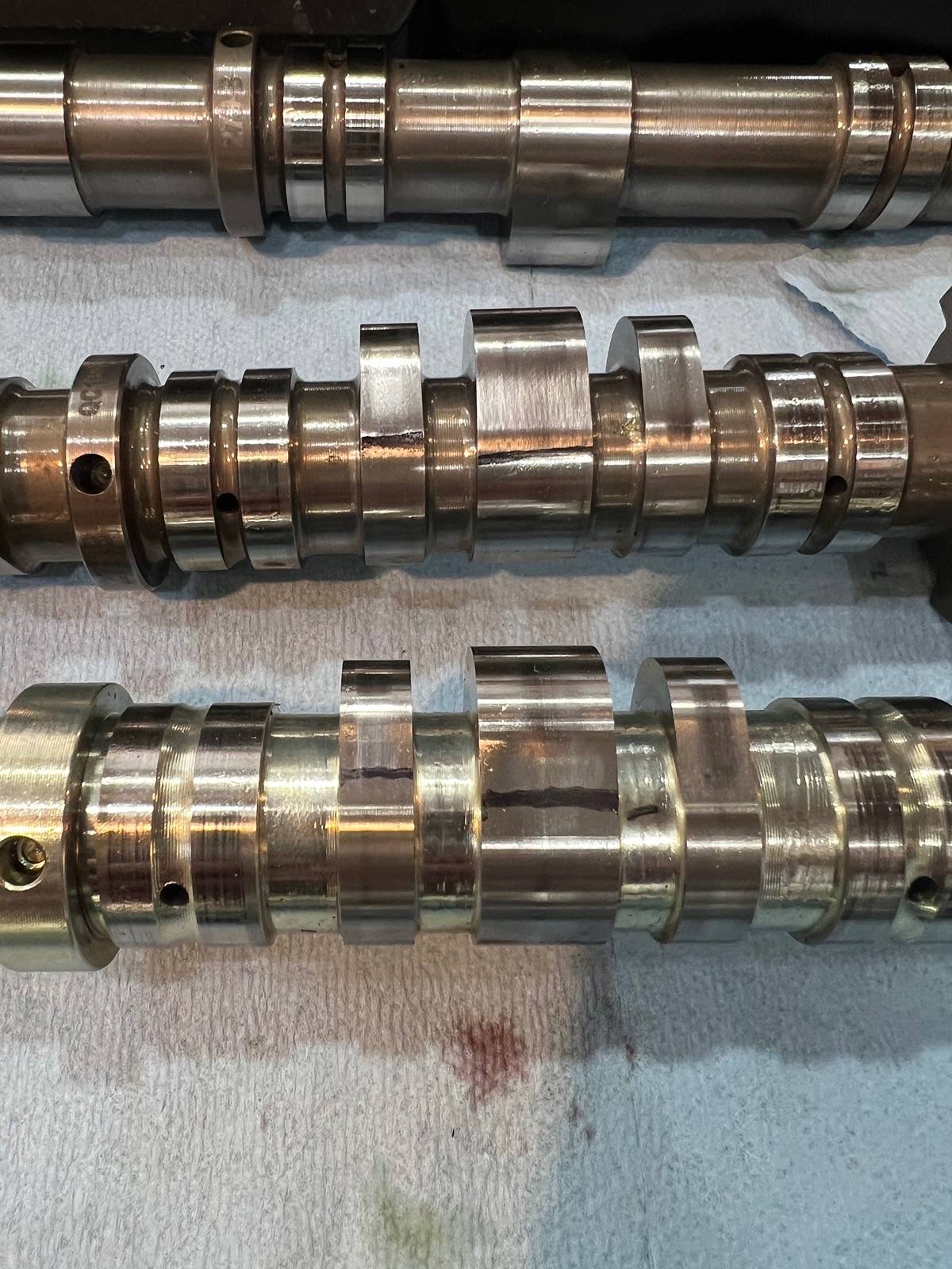

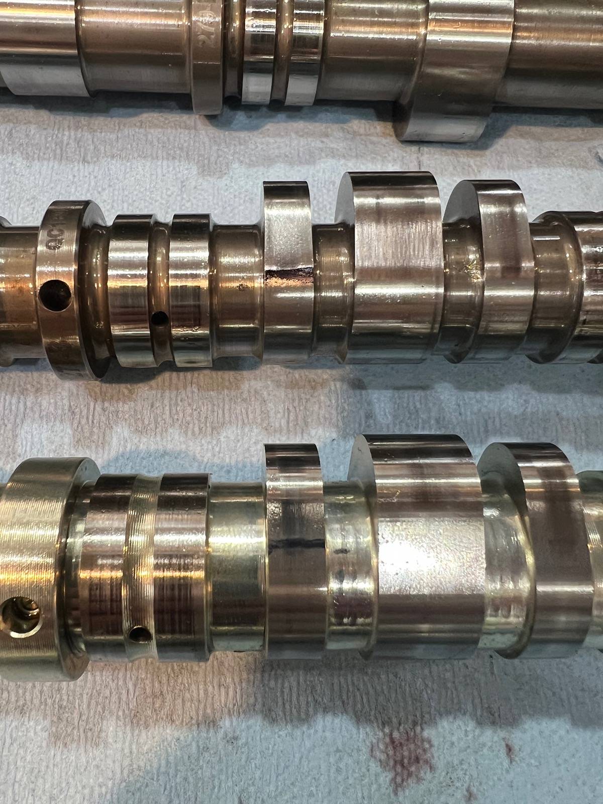

I actually tuned Honda pro Jason’s Fl5. I was conservative so to keep a safe tune for 93 yet made sure it was ultra responsive. That fl5 turbo didn’t have much more in it anyway without turning into a hair dryer. I can assure you the k20c8 doesn’t have any advantage over the k20c1.
Separate non related note on the 400 hp limit is a myth for those who don’t know. It’s 400 ft lbs if torque below 4k is dangerous.
The biggest weak point is the intake cam reluctor is pressed on and will eventually move regardless of rpm but mis shift and hitting rev limit a lot will make it break sooner. I’ve tuned at least 75-100 over 500hp and no issues with rods. Its lack of maintenance and understanding pounding the rev limit is not good for an engine. I seen a guy blame mobile one for ruining his engine but he didn’t change the oil for 10k on his built engine. I run 15w50 mobile at 843whp and had no issues.
You can’t make 75 percent more hp on stock engine and expect to do stock oil change intervals. You can’t run ethanol in a non flex fuel designed car and let it sit for a week at a time.
I think the best way to look at this is I have a customer that has 95,000 miles on his stock Bottom end. Making 620 hp on e50 DI only to the wheels on a dynojet and trust me when I tell you, he is hard on this car, but he maintains it very well.
As far as upgrading the camshaft while keeping tuning easy get a Kelford drop in can. Good for about 20-30 hp over stock on bigger turbo and easy to tune. No VCT limiter pins required it’s a true drop in cam.
Also Kelford cam stage 1 is NOT a copy of a tr2 and Kelford stage 2 is NOT a copy of tr3.
They are totally different. Stage 2 Kelford has 15 degrees more of in car actually lift. You can’t go by spec sheets alone. I measure using wear patterns on the cans that show actual lift contact.
They do have a bit less lift area at peak but you spend almost no time at peak lift compare to low lift area. Also airspeed is higher at lower lift so fuel mixes better on a lower lift high duration cam when working with DI. Last point is Kelford non Vtec lobe is waaay different. They use a larger non vtec lobe and still get great street manners.
I’m not saying tr2 or tr3 cams are bad they aren’t. Kelford just didn’t copy them is what I’m saying. Kelford are the brown colored cans. The pics show tr3 be Kelford stage 2.
The only cam I haven’t tested yet is Kelford stage 1 due to back order.
Trust when I say unless you have a gigantic turbo don’t buy a stage 2 Kelford or a tr3.
Head porting makes a huge difference don’t be fooled as I spool a g35-1050 by 4500 rpm without nitrous or any crazy anti lag tricks. Just straight cylinder head port work.
