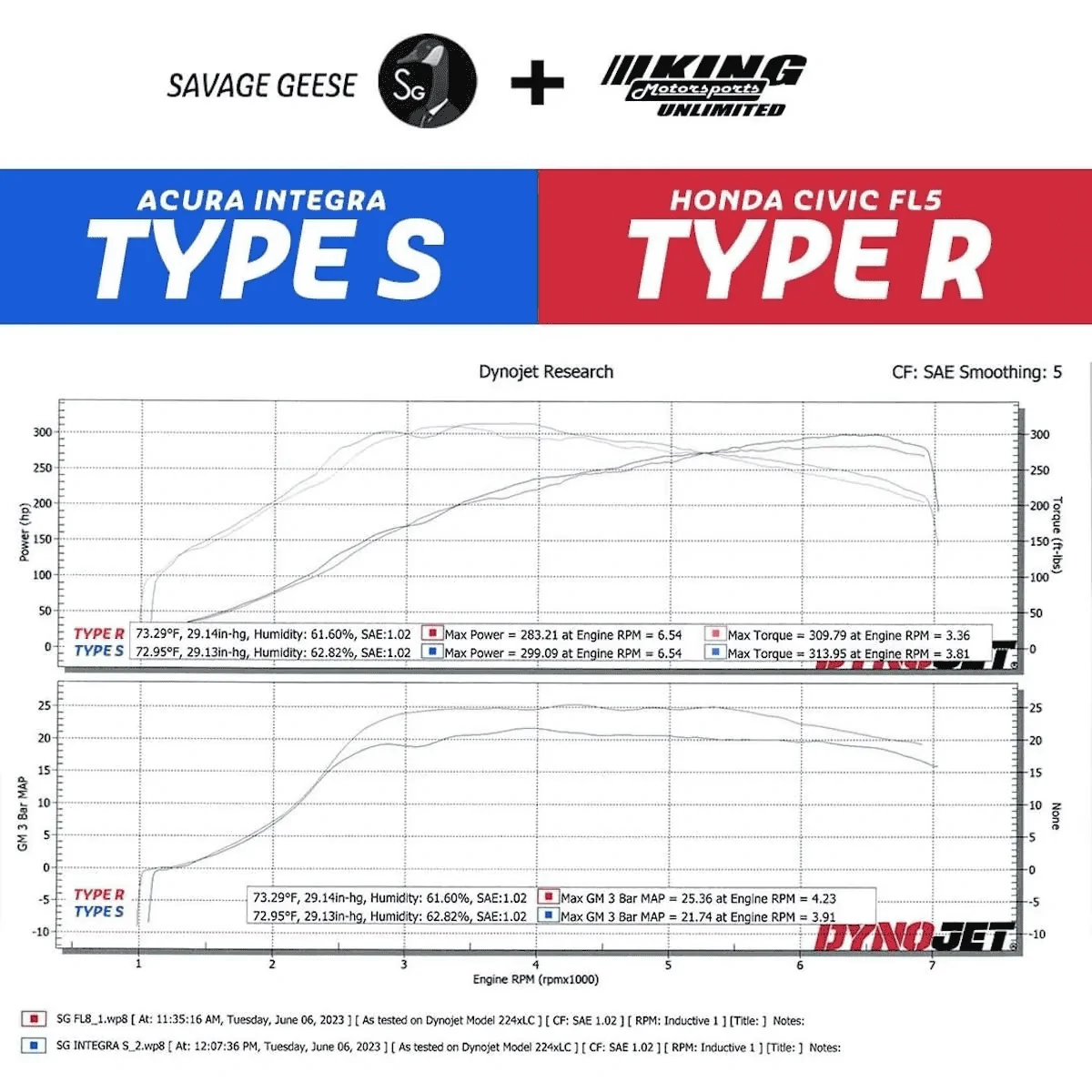

where is the 300 hp at the wheels dyno chart?
Pretty prevalent. The one that first jumps to mind is the Savage Geese video (dynoed the DE5 and FL5 back-to-back).

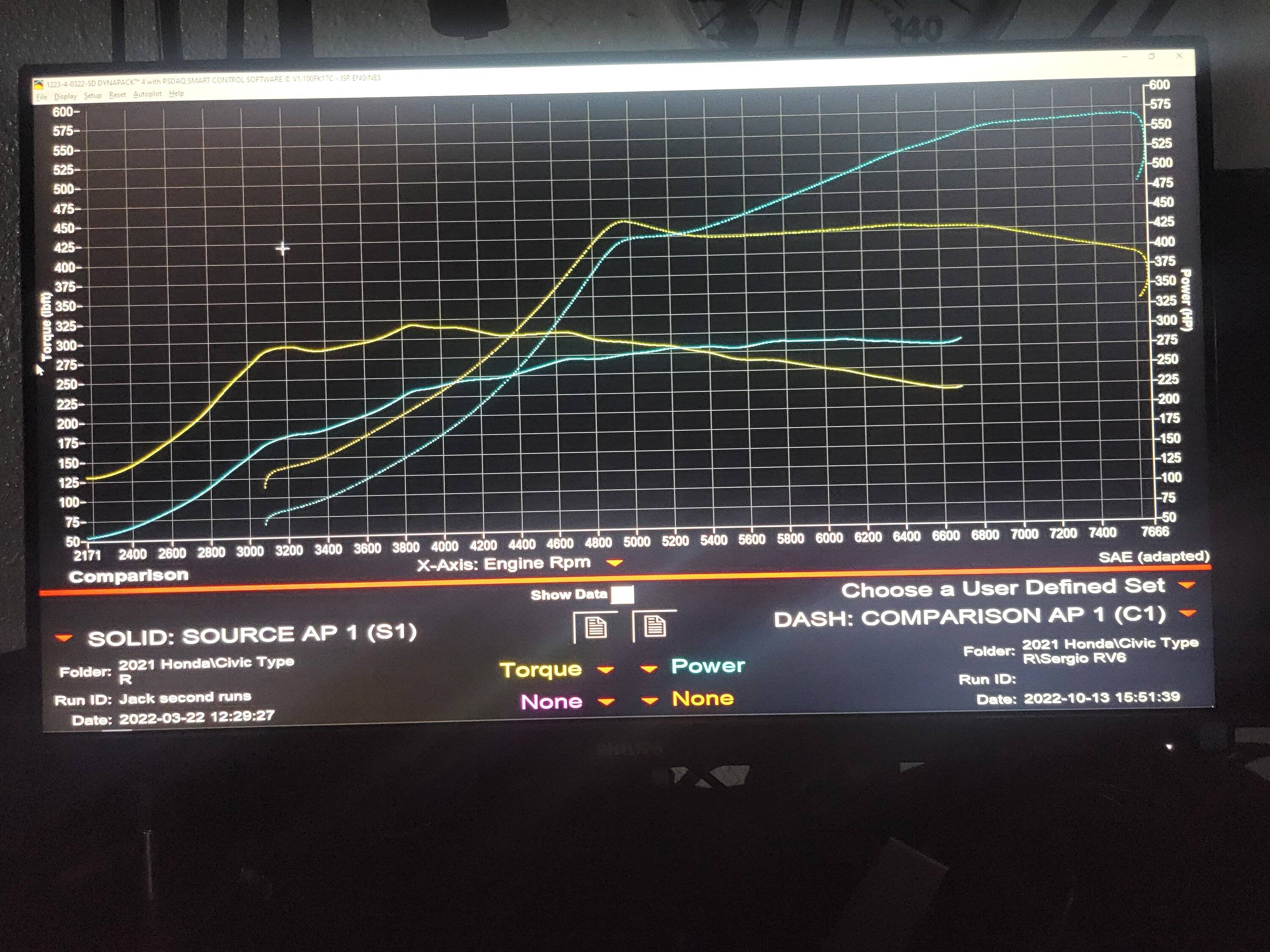

this is a good dyno chart. We see peak torque 2.5k-4K+ before tapering off while HP steady to 7k.
compare this to a stock civic type R FK6 and an rv660 turbo upgrade from @speedyserg :
Acura Integra Integra Type S K20C8 Engine? 3F1DBDBC-AC99-4FA7-868E-FFE1144D5C3A
In both cases stock torque comes on linearly with RPM.
The larger turbos spool slower than the stock MHI turbos. So you’ll only see the huge gains from 4500rpm and beyond while HP pulls hard through redline. This is ideal for FWD cars that want to go fast on straight lines. Having a rapid onset of torque low to midrange can potentially give us too much wheel spin at wide open throttle. Larger turbos makes up the HP on the top end for what it lacks down low.
For folks that want maximum power your turbos will kick in at 5k rpm, you’ll lose the lightning quick response on the low end in exchange for a huge rush on top end revving. This brings the experience back to the Integra type R /GSR days where Vtec kicks in with high rpm capability. However, this means your driving habit has to change to drive in the 4K-5k to redline more to keep the turbo spooling.
with this setup, tracking and spirited driving on twisty roads means that you’ll be downshifting more to get the revs up and taking advantage of the large turbo.
the other option is to bring in the torque sooner with large turbos, but your clutch and engine rods will not hold as well beyond the 450lbft torque. Those will need to be upgraded along with stickier tires. This introduces the reliability issue whether having too much power low-mid range or consistently revving the engine high. Of course Honda engines like revving but none of these upgrades are mutually exclusive, everything needs upgrade consideration for making power safely and keeping car reliable.
in the end, it all depends on what you want out of the ITS, your personal driving habits and how much you’re willing to spend to maintain reliability.

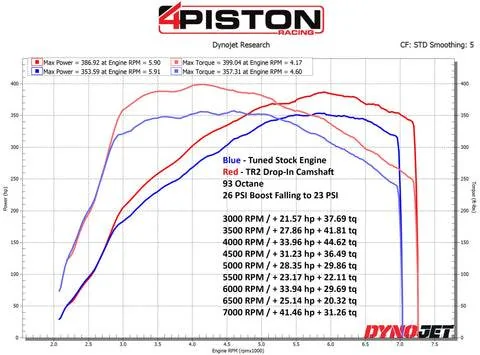

Let's just say I'm curious as to how much cams would impact the overall performance of what this car is all about.
Going by 4pistons TR2 cams and their tuning, you’d be getting +44.62 torque in the 3k-4k RPM range. Then you’re gaining an average of 30HP across the powerband.
Acura Integra Integra Type S K20C8 Engine? 41551AE9-B9CE-437C-88D8-AF36B178F560
In practice, you’ll be instantly gaining a more powerful response on the low-midrange. This is where the experience is enhanced for twisty roads, autocross, tracking or daily driving.
Powerband is broadened so you won’t feel like there’s a sharp falloff after 5k rpm.
This extra burst coupled with some basic map tuning could really shine when you’re powering through corners. you’re not losing anything down low and still keeps door open for large turbo later for those that are into that.
