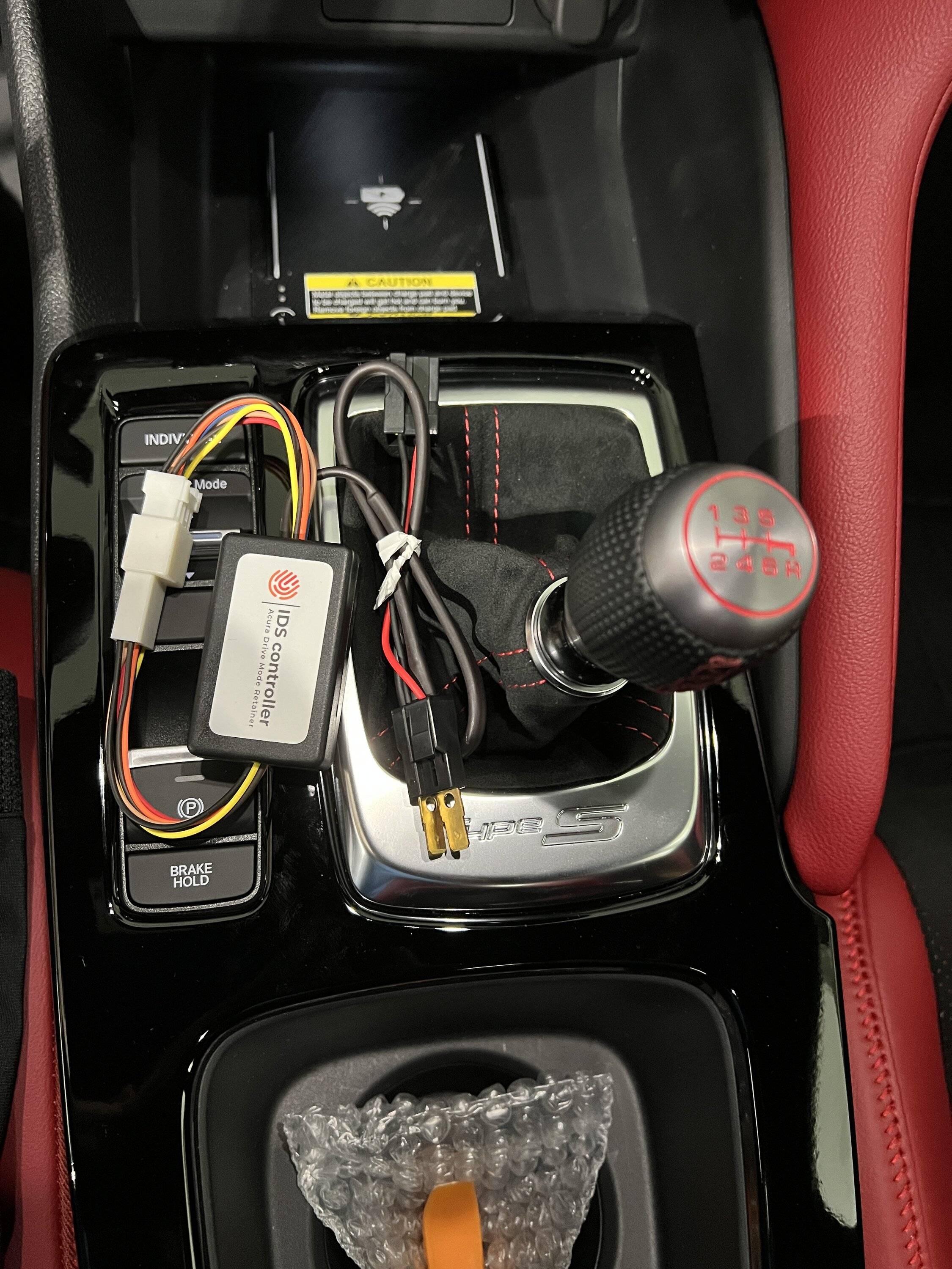

I just installed it just now. Does it work? Yes, but like everyone has stated already it does take about 3-5 secs after start up for car to go from comfort to individual. How’s the install? For anyone that has remove the center console for shifting upgrades like the base bushing it’s basically those first steps. It takes longer than “minutes” unlike they say on the website. It takes a min or two just to remove the shift knob if you haven’t removed that before (that sucker is on there tight your first time removing, defy need a flat head n wrap it on cloth to prey the collar stay down). Took about 30 mins or so honestly but I’m not super skilled. I like to take my time as I’m not being paid flat rate, but I have done a bunch of modding on cars so I’m no newbie either. I install the acuity full cage shifter on the fk8 so these first few steps were basically the same. After you get the device in and all plugged in. I would look at it close to make sure it doesn’t interfere with the shifter. I didn’t love the fact it was right around the shifter area. I used a zip tie to tie it back some hoping it doesn’t interfere with the shifter at all. Don’t think it will after I tied it back but wanted to share.
Is it worth it? That’s a personal question everyone has to answer for themselves. I can see people saying $100 plus 30-40 install time. I rather just press one button every time I start the car which takes 1 sec. I’m still not 100% sure it was worth the time n money but I’ll have to use it some more to truly tell. I do like that this company is around n has solutions to these bad OEM designs.
Last thing if do order it and it looks different from the unit on their website they didn’t send you the wrong unit (I guess they could still have but not likely). They changed the design of it to look like the auto stopper disabler. Bc of that tho there is no longer a red jumper to pull out if you want he car to start in Sport mode. For our cars it’s individual mode only. Hope this helps anyone trying to decide is it for them. I’ll post other things I notice as time goes on n using it more.
