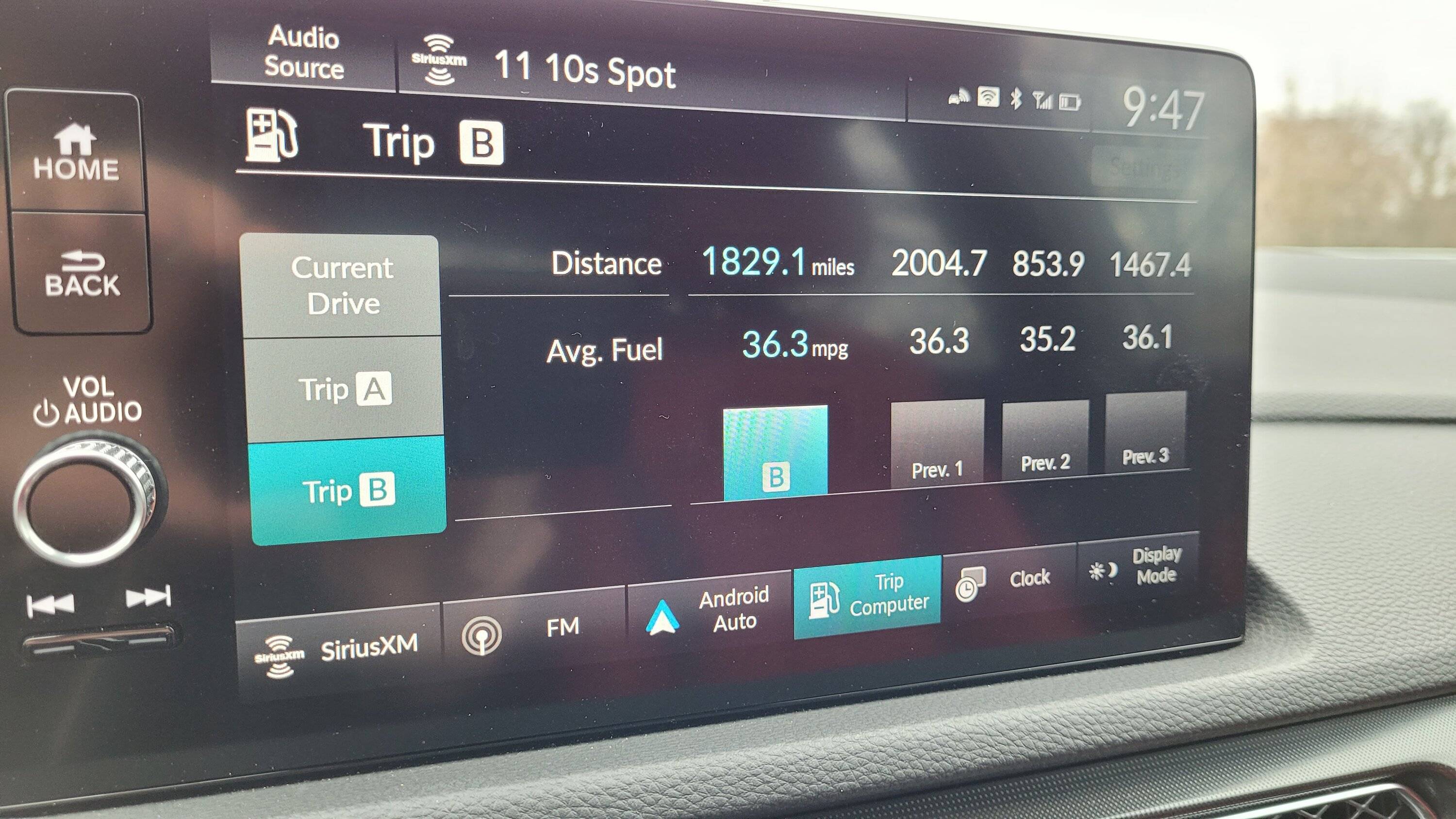

Did a little 2k mile comparison on regular vs. premium fuel over my standard commutes/vehicle usage. Where I am in Tennessee that's 93 octane for premium vs. 87 octane for regular. The first trip was the break-in mileage on 93 octane, because it's break-in we can throw it out, the next 800ish miles were a road trip where I was doing a lot of higher-speed driving on 93 octane, so I'd ignore that as well.
So really the most recent and current trips are the ones to compare. Haven't been paying attention to it but checked this weekend and was surprised to find that my fuel economy on 93 octane and 87 octane were identical!
Driveability wise, I've really only noticed 2 differences between the two fuels:
1. The rev-hang at high rpms is a little worse on regular fuel
2. The VTEC engagement is more noticeable on regular. I assume that makes the car a bit slower, but the VTEC is fun so I really consider that a bonus?
I'll be doing another 2k miles on each to verify these results, just wanted to post the initial findings!
Acura Integra Fuel Survey 20221113_094719
