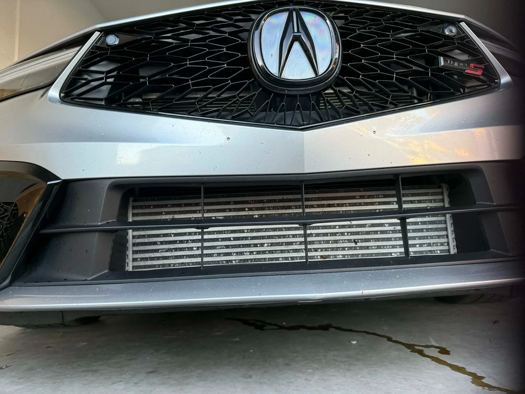

I feel you. I went to my Acura dealership for an oil change and they forgot to tighten my drain bolt. Found this little gift later that day when i went to take out the car again. It scares me that something so basic can be missed, which could have caused engine failure. The bolt wasn't even "hand tight", just threaded ~3/4 of the way on. The dealership is also 45 mins from my house, so im happy it didnt fully back out.

That's crazy.. Glad this didn't ruin your engine.
