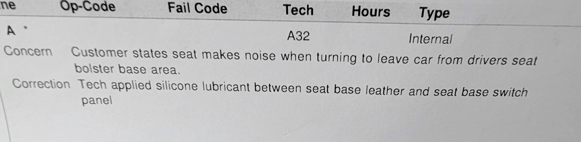

I had the creaking noise on my '24 ITS. Took it to the dealer. The noise stopped after the visit. I don't remember exactly what was done, but no noise since. I bet there is a TSB on a fix.

Just make sure your concerns about the noise are documented on every repair order. If you go beyond your warranty ending, you can show proof of the concerns prior to the expiration.
As I posted earlier, my dealership dealt with this on one visit.
