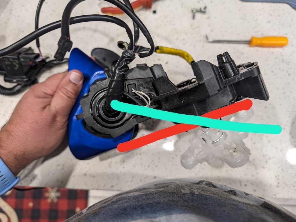

Does anyone have issues with alignment angle of their passenger mirror?
I got the kit and I installed the driver's without issue but the passenger doesn't seem to line up correctly and I cannot figure out how to make it fit right.
Red is the wrong angle
Teal is the correct angle it's supposed to be at.

I'm assuming the base is properly aligned where the cables and 3 screws go in? I think I remember there being an alignment tab so it could only go in one way.
I had the same thing happen with my driver's side and the position was a bit off. I plugged it in to test it and it resolved itself - I think the motor was possibly stuck and needed to go through its normal range once.

Thanks. I messed with it a bit and managed to get it manually lined up. I had to take the motor assembly apart and remove the gear to line it back up correctly. Luckily I put it back together and installed it and it worked ?
