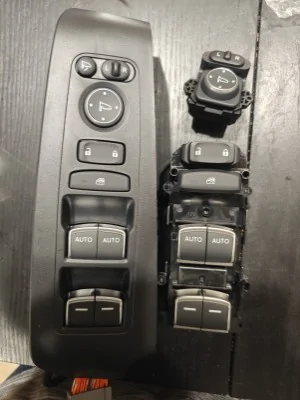

Okay, so I started tackling the install today (after having second thoughts for few days). Got the door panels removed and then realized the my socket isn't deep enough so will have to go buy another one in the morning.
In the mean while I assembled the windows switch console. Added the window auto lifter model and replaced the mirror switches. Kit also came with the window switches, which are identical to the one I already have (same part number), so there any reason to use Mikstore one?
Acura Integra DIY Power Folding Mirrors: a journey IMG20250523203637
