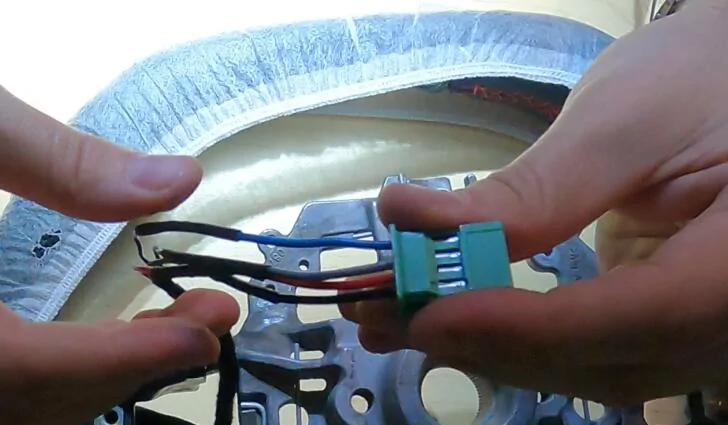

for the wheel, maybe I had a bad ground or loose test wire that was switching off the heated function after button. Seems better now. And actually the polarity seems to make a difference for me.
car purple to black TTD
car black to red TTD
the blues don’t seem to matter, but if I switch the black and red wires, I get almost no heat.
I am fairly disappointed in the heat. The wheel is nice, but the heated feature is what I really wanted and it’s definitely sub par

Interesting - I just took some time to look through my videos and found that I have the opposite setup as you (red to purple, and black to black). Not sure whether this is worth mentioning, but the heat is only in 4 spots (10 and 2, and 7 and 5), and not the whole wheel like I would have liked. Although in comparison, the RAV4 has it in similar spots. I think the wheel thickness definitely has something to do with it.
Now I'm wondering if either there are variances in the heat with the seats depending on when the car was made, or our expectations/tolerances for heat are just different. I have noticed you can feel the heat from the seats rather quickly, but I've never thought they get unbearably hot.

interesting. Maybe that’s why I’m feeling such varried temps. If 10/2 are hot, but 12 is just getting the left over, it might make sense. I did use it this morning on my 30° drive and it was better than none, so I’ll still call it a win. The shape of the wheel is really nice.

So I have been back and forth TTD about the heated wheel. They are telling me (and their engineers confirmed) that the heat should be all the way around and not just 10/2 and 8/4. I was concerned mostly because I drive a ton with my hand at 12 and there is little heat there. I mentioned to them you had the same wheel with the same problem and they wanted to get us on a chain together to figure it out. You game?

Interesting. Sure, thread me in. I wonder if anything has changed in the last year since I had mine made. But I'd be curious to see if mine is supposed to be all around and what can be done differently if possible. I'll PM you my email address so you can add me to the emails.
