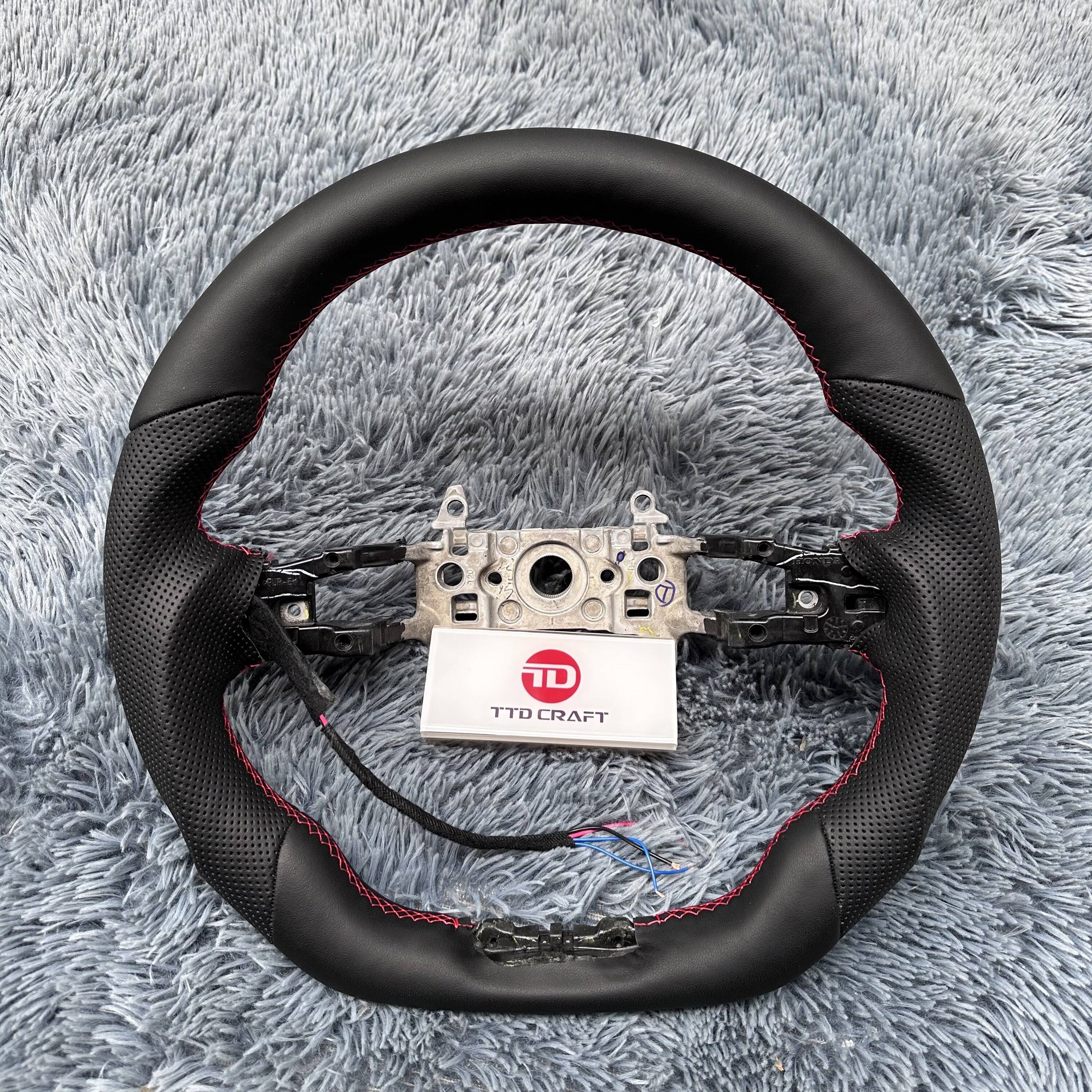

Here's the picture they sent me after they finished making it.
It actually ended up coming in today. It feels a little bit thicker than the OEM wheel, kinda similar thickness to BMW wheels. The perforation doesn't feel as pronounced but the look is still there.
The wires for the heating element don't have a connector so I'll have to transfer that from the OEM heated wheel. The wire colors are different so I will need to test with a multimeter to make sure I hook it up properly. I'll document this when I make my video.
Here's their site with a bunch of examples: https://ttdcraft.us/collections/integra. They all show some kind of carbon fiber on them but I wanted mine to look close to OEM and be fully leather so I emailed them and worked with them directly.

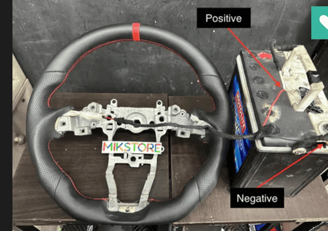

Looks like mik offers a similar wheel. Not sure if it's cheaper with the heating option added.

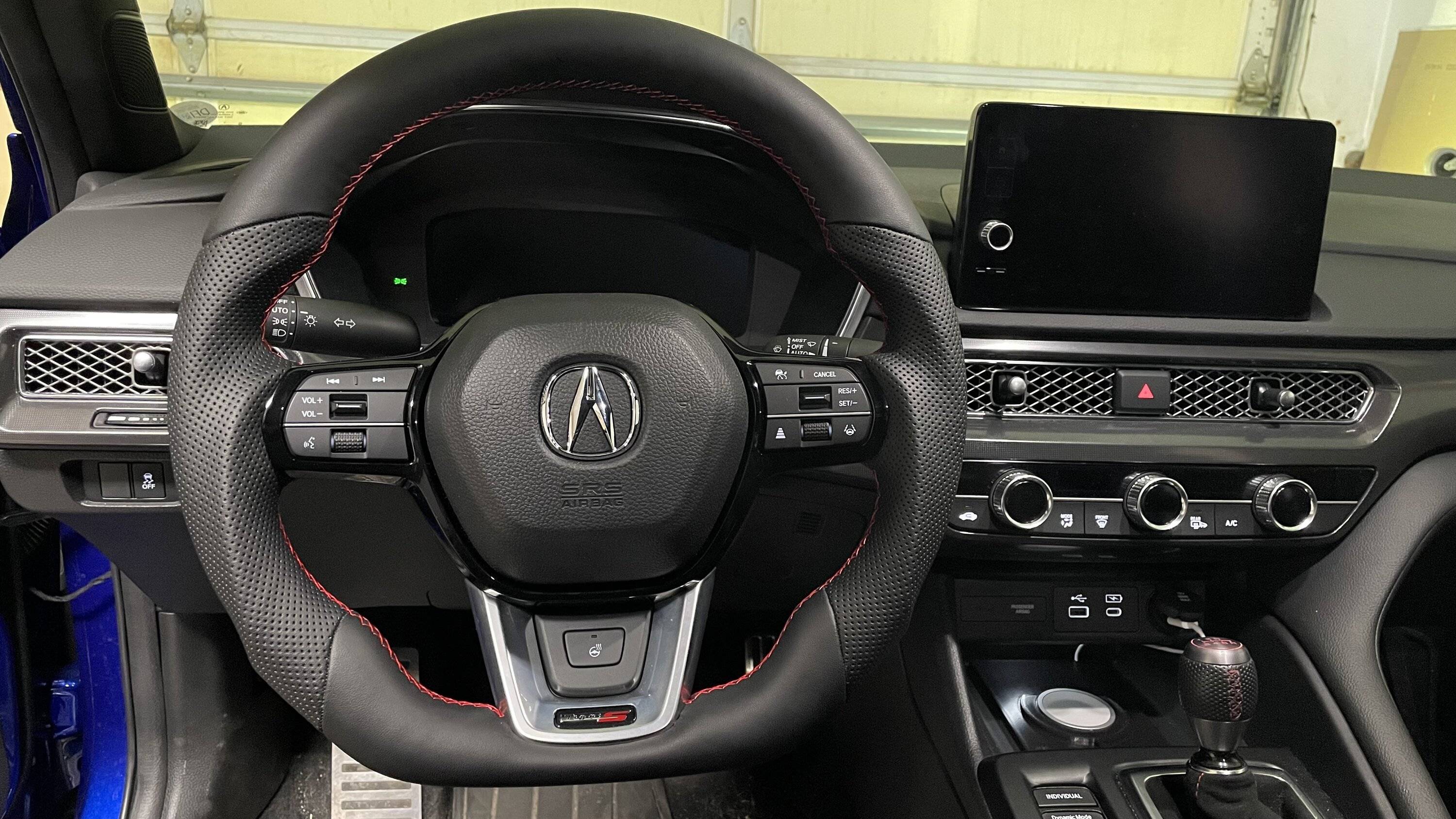

It did! I've been rocking it for a few weeks now and loving the comfort in the cold. I've gotten a bit lazy and haven't found time to put together my video yet, but thanks for the reminder - I'll try it to do it sometime soon. Here's a picture for now:
