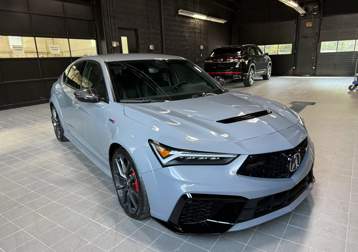

Hello fellow ITS owners,
I have to say I'm very disappointed with Acura overall.
I used to own Integra's back in the day and I've transitioned more-so to Germany vehicles, i.e., Mercedes at this time. I bought my first Acura Integra PWP Type-S back in June 2024. Never drove it, just saw reviews and videos, and was chasing nostalgia. I have to say I fell in love with it.

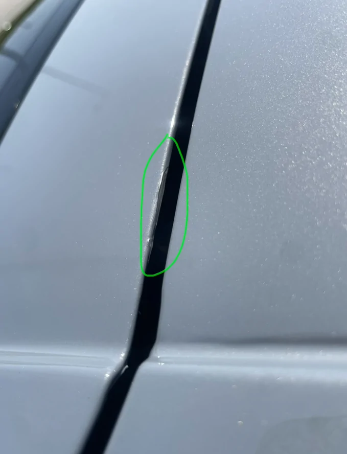

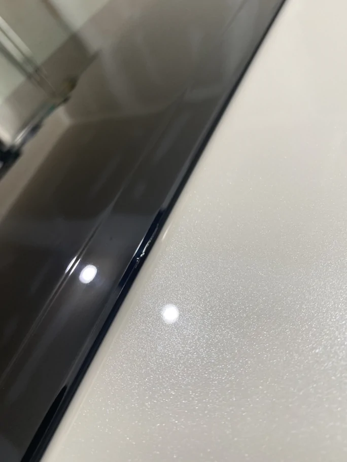

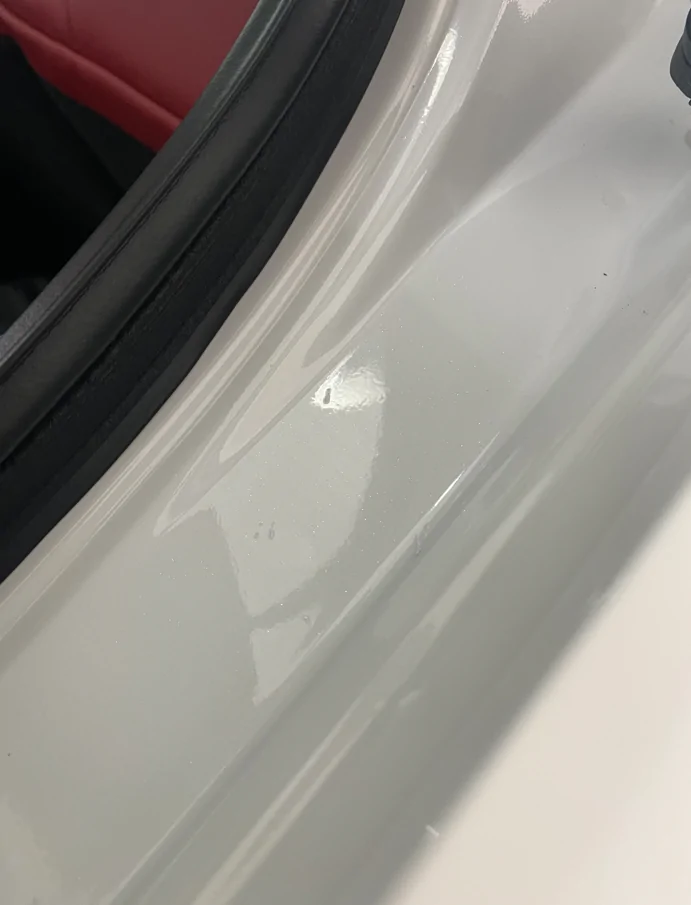

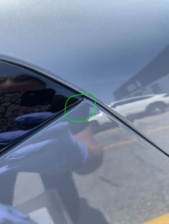

What really let me down is the build quality. I've attached some photos of dust in the paint and drip marks. I found an extra ECU cover that damaged the fins on the inside of my radiator. I mean I paid 2k for the PDI - why wasn't this noticed? The only solution I got from dealership was to have it painted by some third-party body shop and a warranty extension on the rad. I don't want to have my new car painted. I deferred but it stuck with me, left it how it was. I was recently at the dealership getting an oil change and was offered the same price on trade-in as I purchased it for. I was considering the 26 UGP for a while, and this decision made sense. I pick up my new UGP and it has blobs on tailgate, paint chipping at the tail lamp. What the hell? Another 2K on a PDI and they didn't see this. Sure, sometimes it's not the dealerships fault, but come on. The dealership is like "we'll figure out a solution" yeah - to have it painted again, I don't want that. I want Acura to step up and do more. So I'm off to fight with them for not meeting the basic standard of producing a decent vehicle. Literally, JUST took delivery of the vehicle yesterday, brand new. Two in a row, I'm disappointed to say the least.
Anyway, has anyone else had defects like this, issues with their paint, etc.? Has Acura stepped up outside of doing the bare minimum and repainting my car? Is this what is to expect from Acura/Honda?

Look up my "back on track" thread. I started it as a build thread but haven't updated much recently.
My first week of ownership was great, and then I started noticing all sorts of things. The first wash and detail I did left me very disappointed in the paint quality. You just can't compare it to anything German, even a lowly vw.
Whats worse is how much debris I found in nooks and crannies all over as well as just poor assembly, broken plastic clips, plastic interior panels that didn't align, headlight that didn't align with the bumper garnish, plastic panels that didn't align properly. I measured the paint across the car and found variance of 2mils all over including just across the hood. Worst of all my brake fluid was highly contaminated and had actual copper deposit at the bottom of the master cylinder.
Recently one of the techs I met outside of the dealership just smugly smiled and said, "yeah that's just acura." Almost like he was proud of it. His "who cares" attitude really tripped me up.
At the end of the day, this is not a luxury car. It's a tin can with a decent suspension setup, decent front brakes, and an okay engine. The shifter is solid, the clutch is meh, and the factory exhaust is well built but beyond quiet for a performance oriented car. Its biggest advantage is that it's "light" by 2024 standards, and very well balanced. If this was my daily i would have traded it for another gti or golf r in a heartbeat, but as a third car it's fun and can fit two of my kids in the back for fun grocery store runs and demonstrating to my students on track that a fwd "large sedan" can go fast.

I have the tail light rubbing the bumper issue. I read a few people also have that as well probably due to how the corner tail light angles down and vibration scrapes the corner. I ended up just putting touch up paint and cut a small ppf to protect it from rubbing.
Another paint issue I had where the driver door was rubbing the fender bracket, had to bend it slightly to prevent it.
My last paint issue where the passenger fender was rubbing the A-pillar. Didn't notice it until I was washing my car and saw a bit of rust on my PPF. There was zero tolerance in gap causing it to rub and scrape a bit of paint. All I did was touch it up and added another small piece of ppf to protect it from scraping.
A bit annoyed on these exterior imperfection but the interior rattle drives me nuts more. Other than that, I still enjoy the car since it's a blast to drive but wish build quality was a bit better.

I had one ceiling speaker cover not clipped on properly.
The piano black piece outside of the C pillar on the passenger side was popping out.
Two rubber bushings on the liftback was not fully on and were just hanging.
I don't know how many other things could be wrong in places I can't see.
I've had Toyota, Subaru, and Mazda, but Honda/Acura is the worst quality by far. But the driving feel. It's worth it.

My front driver side dash vent is missing a clip so it's easily popped up, and my rear bumper cover was missing 2 screws. Since I was installing the mud guards anyway, I just used the extra screws i took out to fill in one of the holes. The hole was completely untapped so it was obvious there wasn't even an attempt to add the screw. The other hole was missing its thread clip entirely.

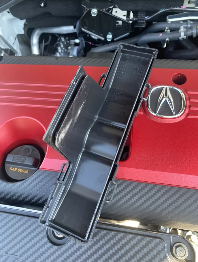

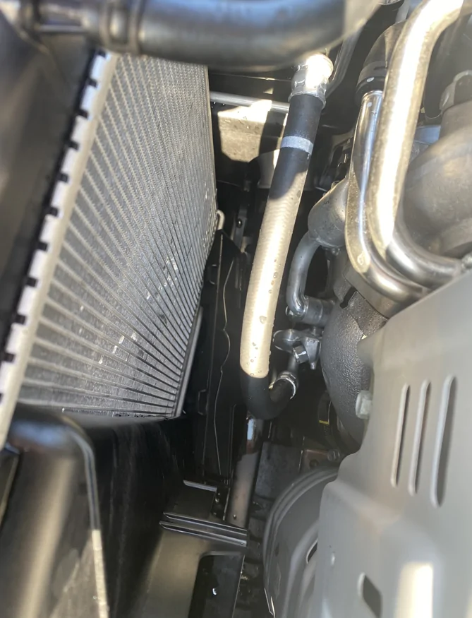

As far as the paint issues and random ECU cover in the engine bay.. that's wild.

Yeah I'm not seeing anything egregious here. The ECU cover thing is weird but I also had a Macan that didn't come with a bolt in the driver's seat bracket. Shit happens. Otherwise, some very forgivable paint blemishes. Wouldn't bother me personally.

This paint does chip way too easily because of how it's applied. The paint thickness variance is a concern, point blank. It's Tesla level bad. Also the ppf I've had removed in areas has occasionally taken paint with it šŸ™ƒ.
I'm in the process of some repairs due to an off course excursion, and I will not be doing ppf again on it. I'd rather just replace parts and repaint sections every few years at this point because it's not a garage queen.
