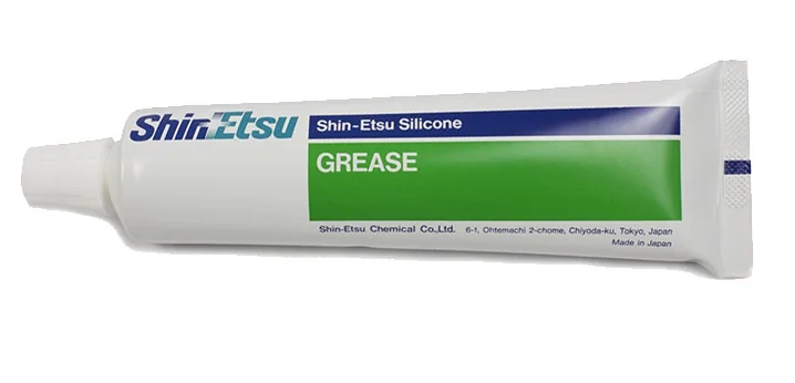

Get a q-tip and rub this generously inside the rubber of the window track.
Acura Integra Auto Up windows IMG_1026
It’s a “safety” thing. If the motor senses resistance when closing the window it will reopen as a precaution (ex. The window is closing on an arm or something). Grease is sold at Honda/Acura dealers but you can use any really. I’d avoid WD-40 as that is not meant for rubber, unless it’s the silicone version. When I bought my car it was having this issue and this solves it, the rubber tracks tend to dry out and creates resistance causing the window to reopen when auto closing.
