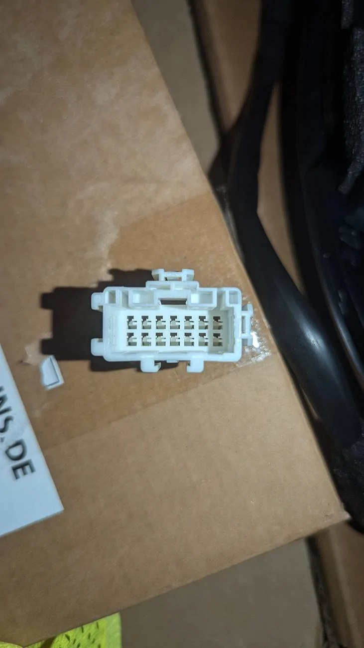

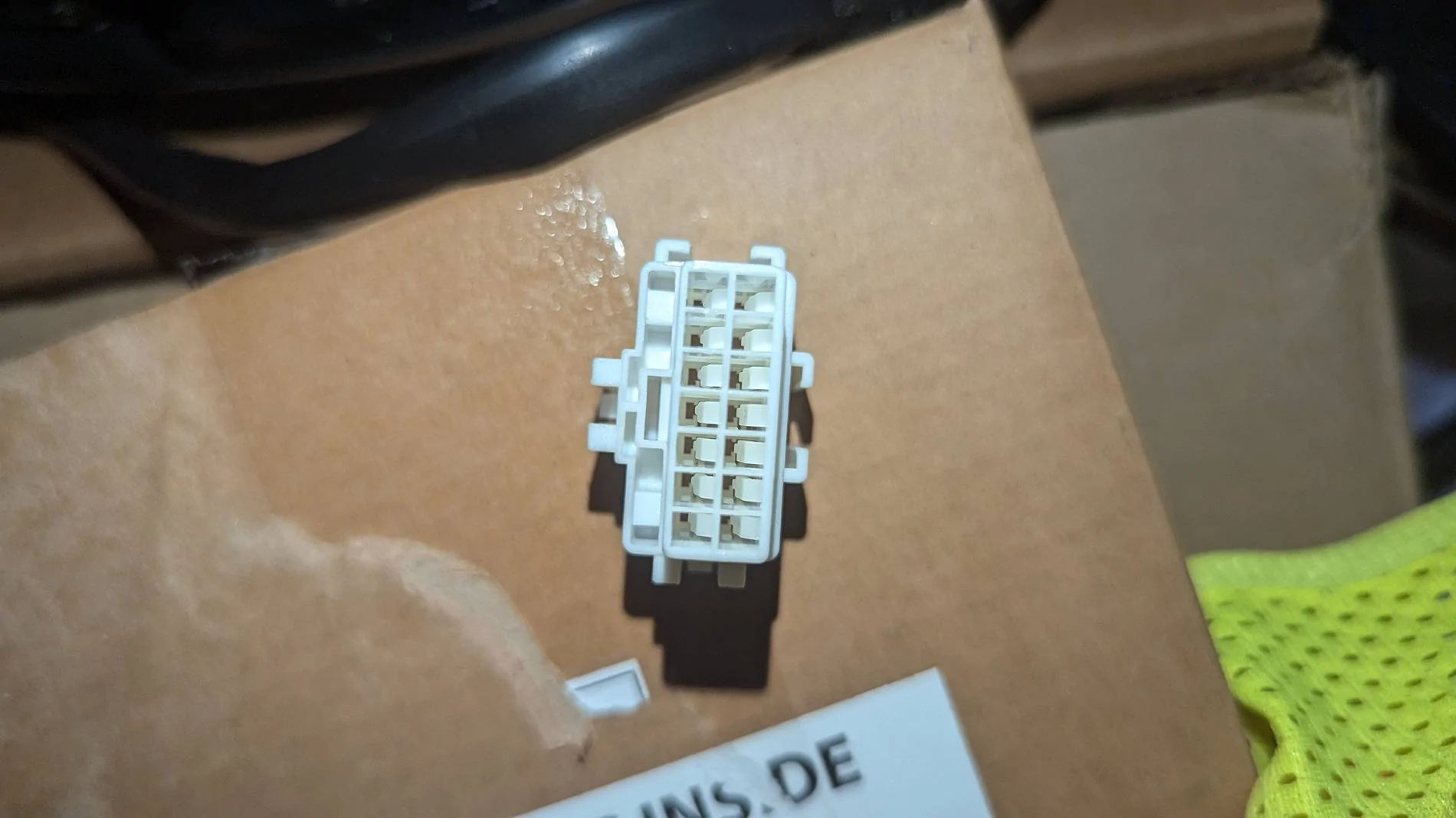

I put two in the wrong hole like a dope and I absolutely cannot figure out how to remove the wires. Tried the unlock on the gray plug with the black lock (it doesn’t unlock very far) and then I tried a tiny paper clip from the front and rear without success. WTF am I trying to accomplish?
3,448
2,940
It happens. I took photos before I disassembled.
You go through the pin side ,there's a slot.
I used a sewing needle to go in and pull that tab out
I figured it out. Pin side with a sewing needing. My trick was I needed to push the wire all the way in, hold it in place while I got the needle under the clasp (easier said than done) and then once the clasp was released I could pull the wire out. If the wire was too far out (often pushed back by the needle) it was putting pressure on the clasp and I could not release it.
