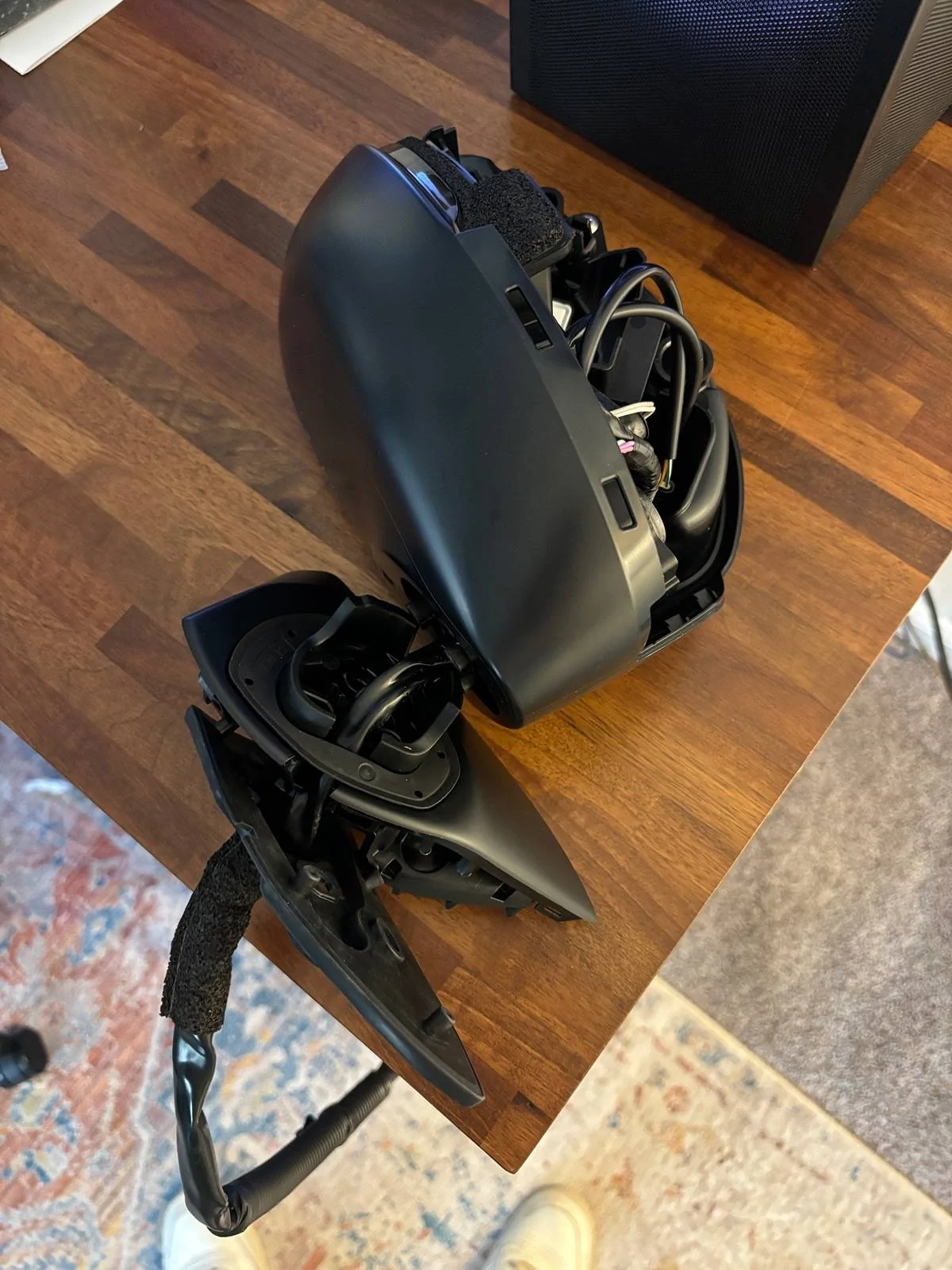

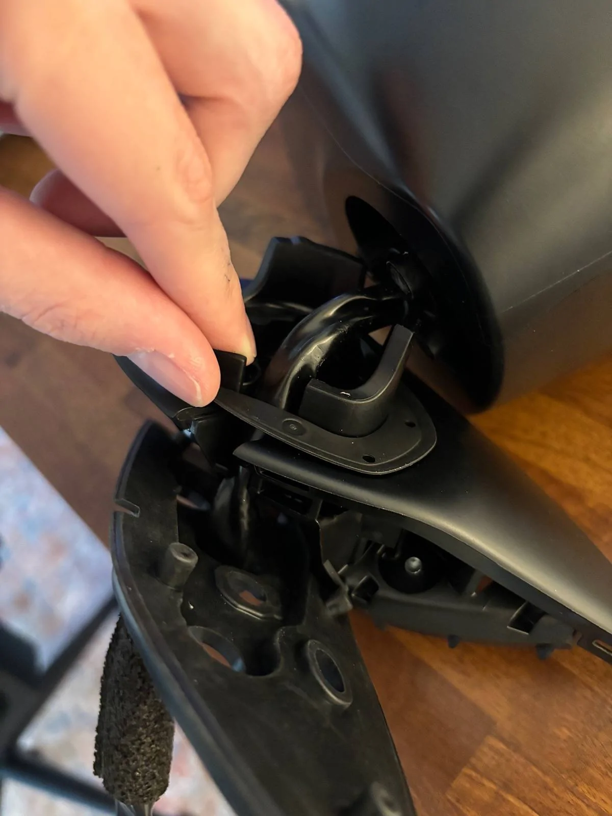

I got the turn signals installed and now I’m trying to get the base swapped out. Did you cut this foam gasket from the mikstore base to get the wire out?
Acura Integra Auto Folding Mirrors installed IMG_4287
Acura Integra Auto Folding Mirrors installed IMG_4286
Compromise
Aug 20, 2023
98
81
Integra Type S
No. Remove the adhesive/foam/electrical tape from the cable and the whole thing should come off.
De-pin connector and remove the foam adhesive tape that sealed the bottom of the boot. Slide everything through. If you salvaged the tape reapply.

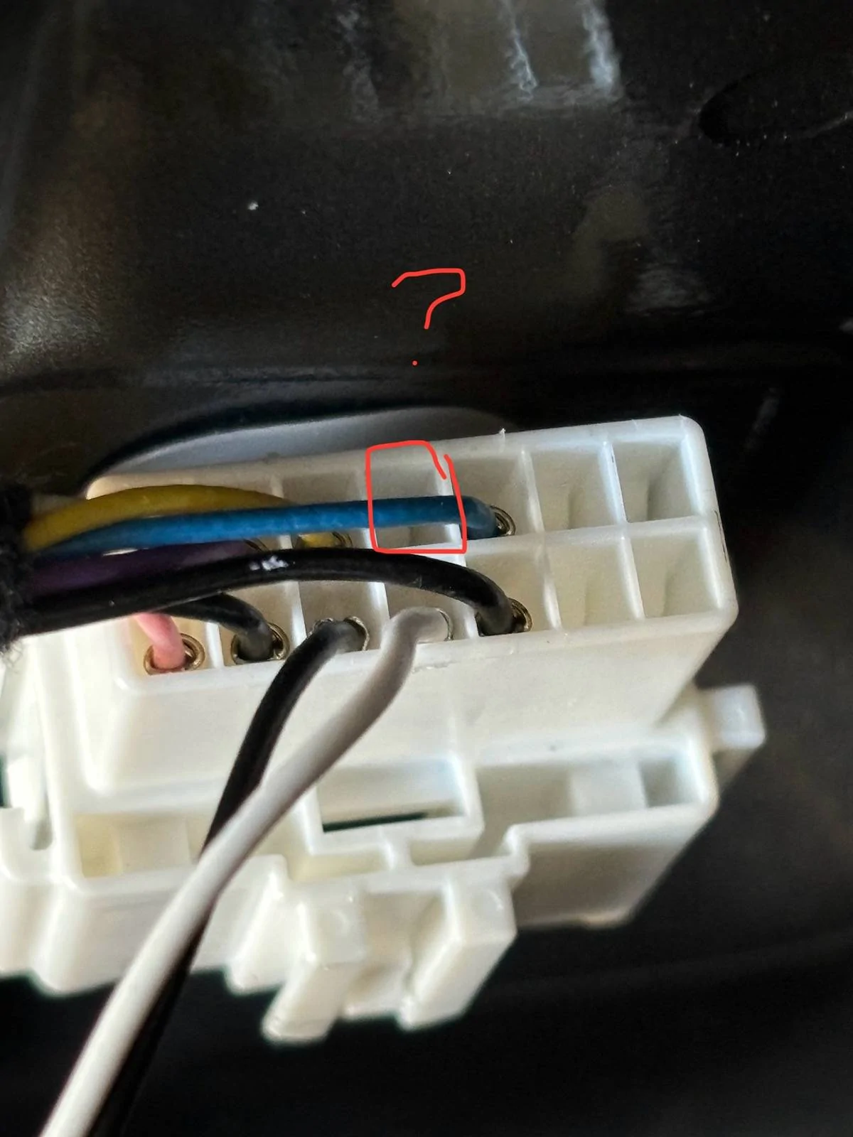

I’m still a little confused, should I have unlocked the plug when repinning the mirrors I unpinned
do these look pushed all the way through?
Acura Integra Auto Folding Mirrors installed IMG_4297
3,448
2,936
I don't think that plug has a lock.
That looks fully seated

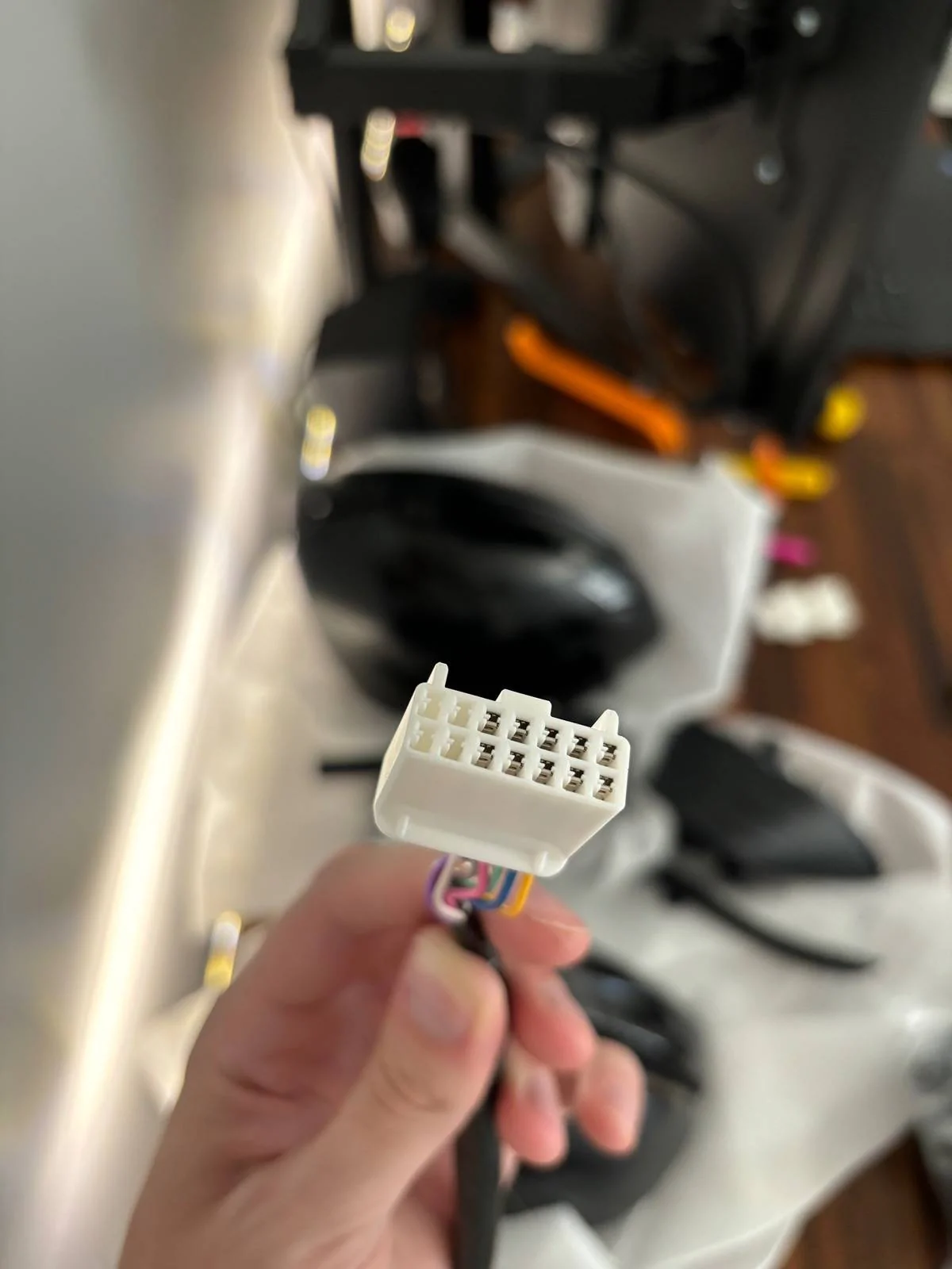

I think I’m missing a wire. The pink wire that goes to the mirror blinker is missing from the car door wiring harness. I plugged in the mirror to test and was able to move the mirror around but the blinkers won’t activate. I am driving a 2024 base spec integra
Acura Integra Auto Folding Mirrors installed IMG_4306
Acura Integra Auto Folding Mirrors installed IMG_4305
mugendc4
Dec 18, 2023
64
Socal
DE5
Looks like you're going to wire it if yours didn't come with turn signals initially. Probably should have gotten kit "C" since I believe it comes with extra harness/wiring for it. That's why I was making a little stink about mikstore charging "C" and "F" the same price when you get less harness. Sorry can't help you much on that part since mine came with turn signals but looks like their guide shows you what to do if you scroll down a bit to wire turn signals. Or ask any member that order the "C" kit that may have laying around to sell. I initially order "C" but they sent me "F" ?
