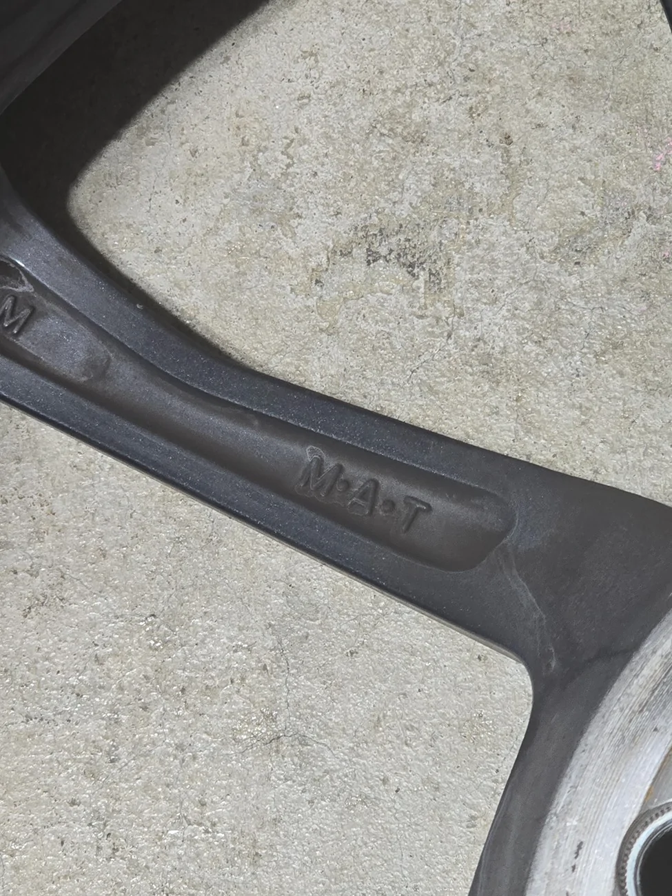

Confirmed, the oem wheels are made by enkei and they are "flow formed" or "flow forged", whatever your preferred terminology is. That means the face of the wheel is cast and the barrel is heated and then stretched to forged. More specifically they are the higher end enkei MAT process where under low pressure the facing is cast to produce a more uniform and stronger cast section. VERY good quality wheels... The paint is just shit, but that's true of all enkei wheels. If you run your fingers over the barrel you can see and feel the ridges from the stretching process. Knock on it and there's a distinct metallic echo. Knock on the spokes and hub face and you'll find they're more thud-like but consistent across the spokes and wheels. The holes also have inserts for improved rigidity under higher heat.
Acura Integra Are the wheels cast or forged? 20251109_163231
Acura Integra Are the wheels cast or forged? 20251109_163225
