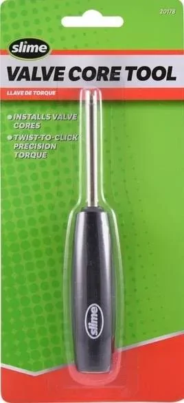

You might want to try torquing the valve stem to 8 Nm and tightening up the valve core with this $6 tool from your local Walmart. Hopefully it's an easy fix.

We did try the core and the stem stuff. Spraying soapy water reveals the bead seat as the culprit.
