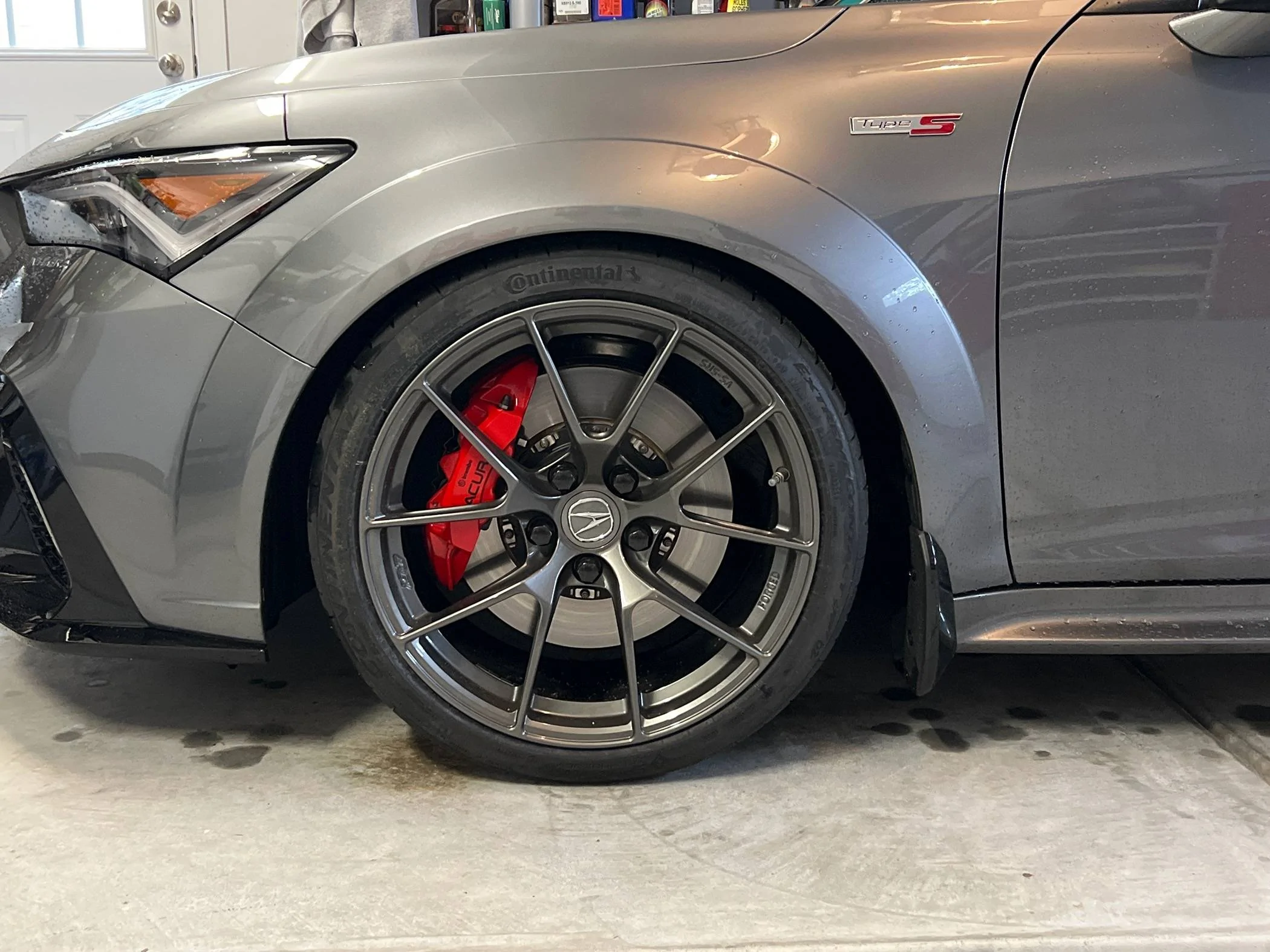

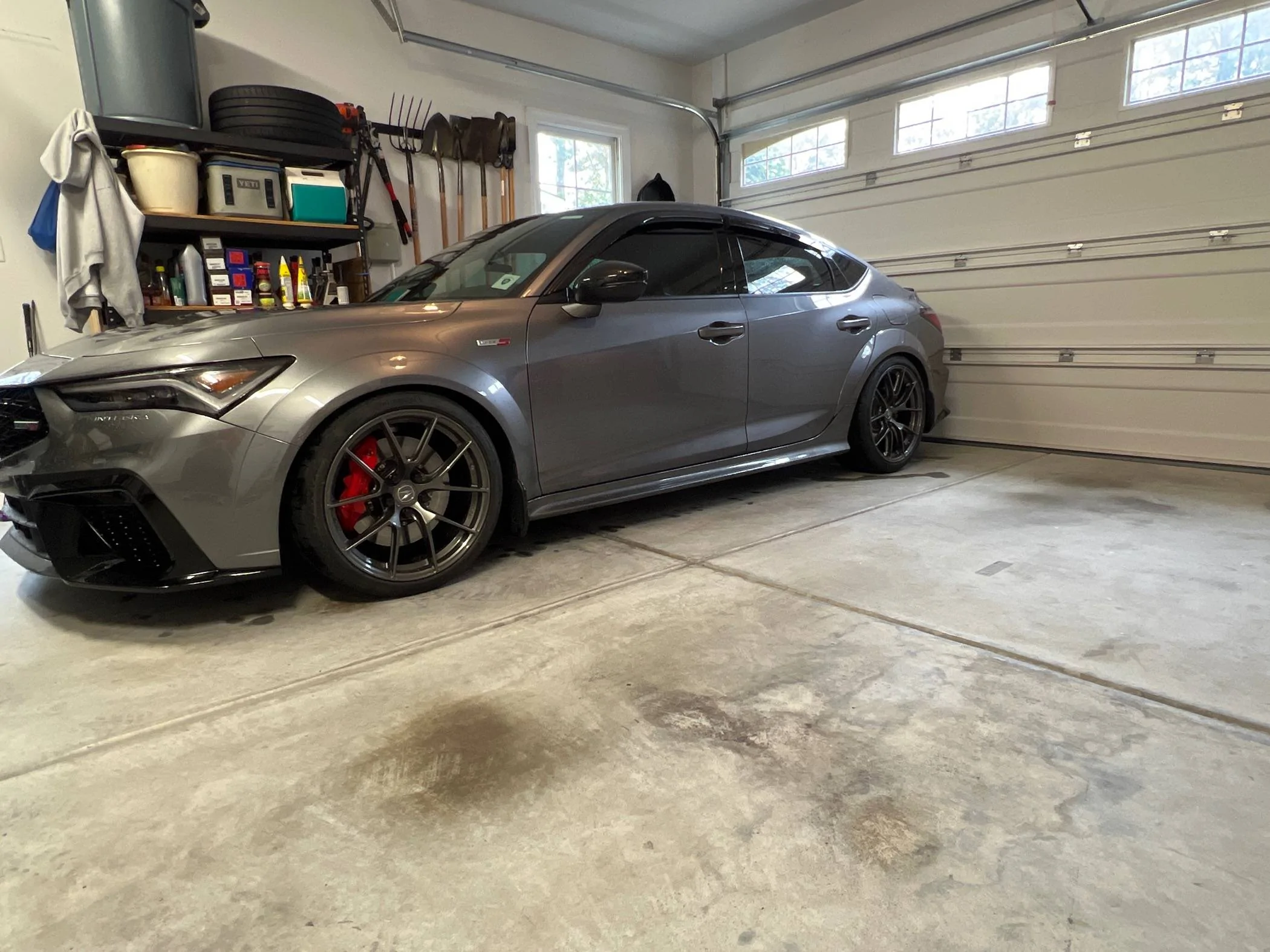

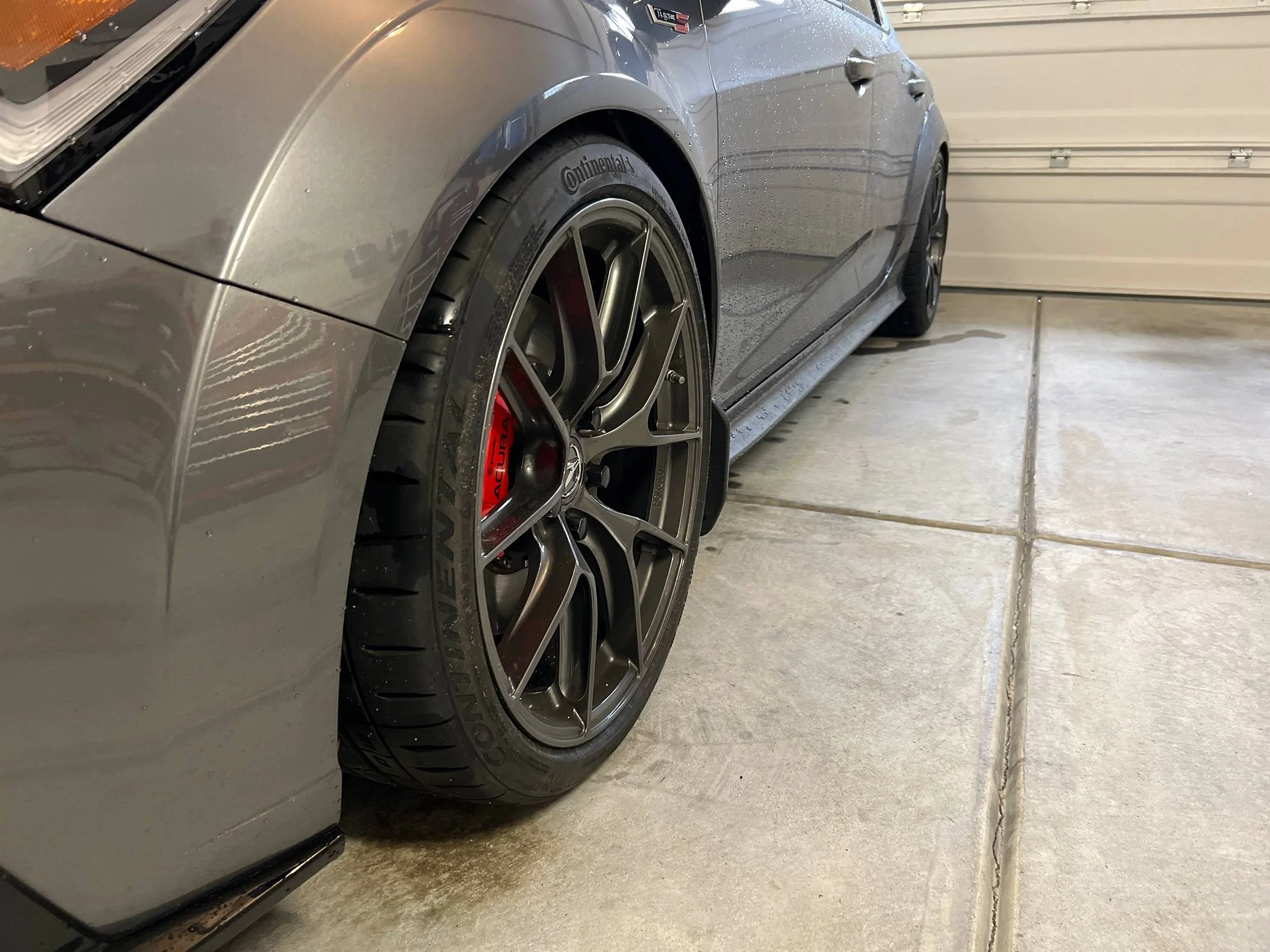

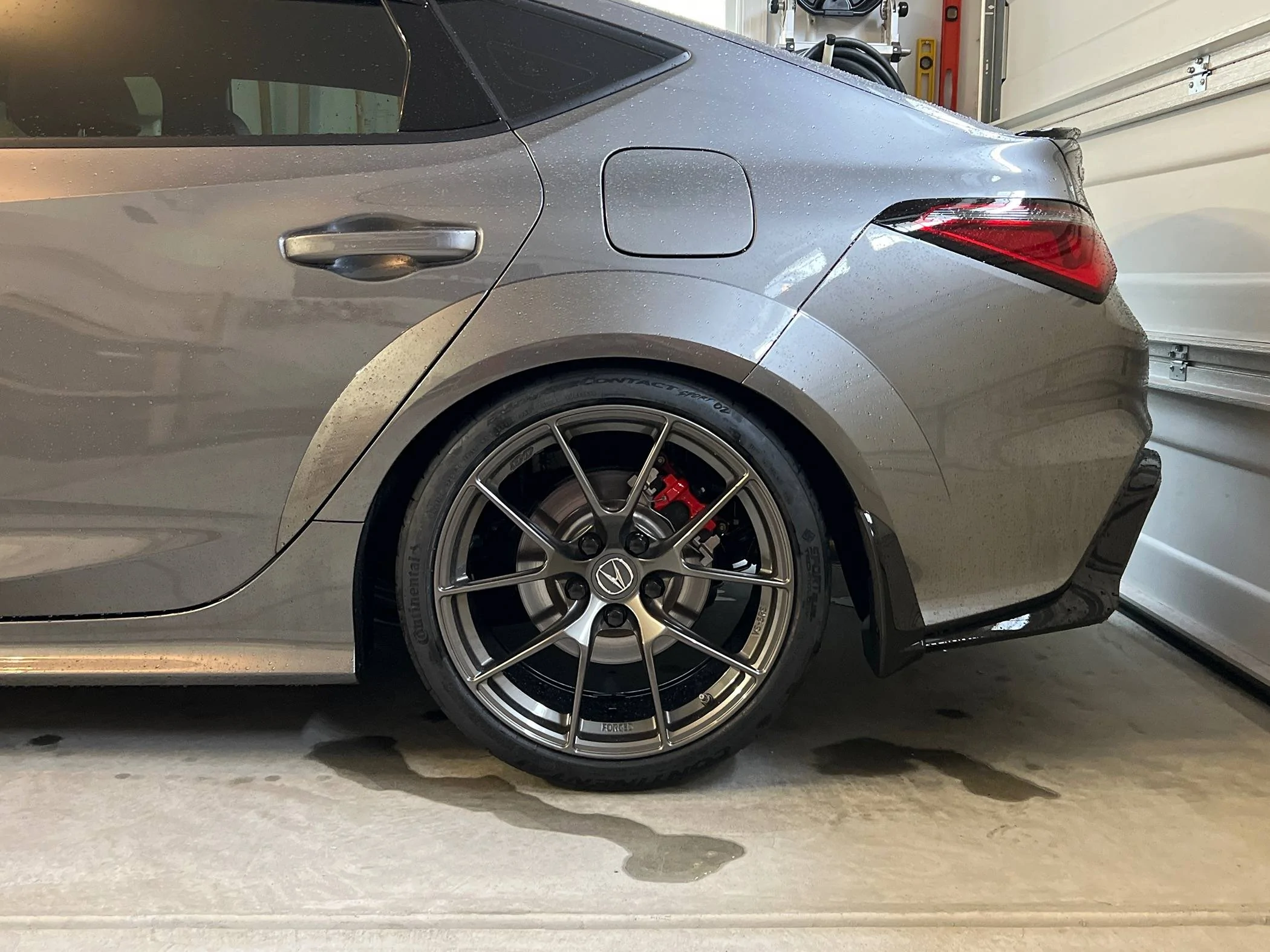

Couple pics to tide you over. Definitely a bit more meaty looking. I’ll post better pics once I can get the car cleaned up. 4 days in and air pressure is good. Also after day one I dropped pressure back to 36 front, 34 rear.
