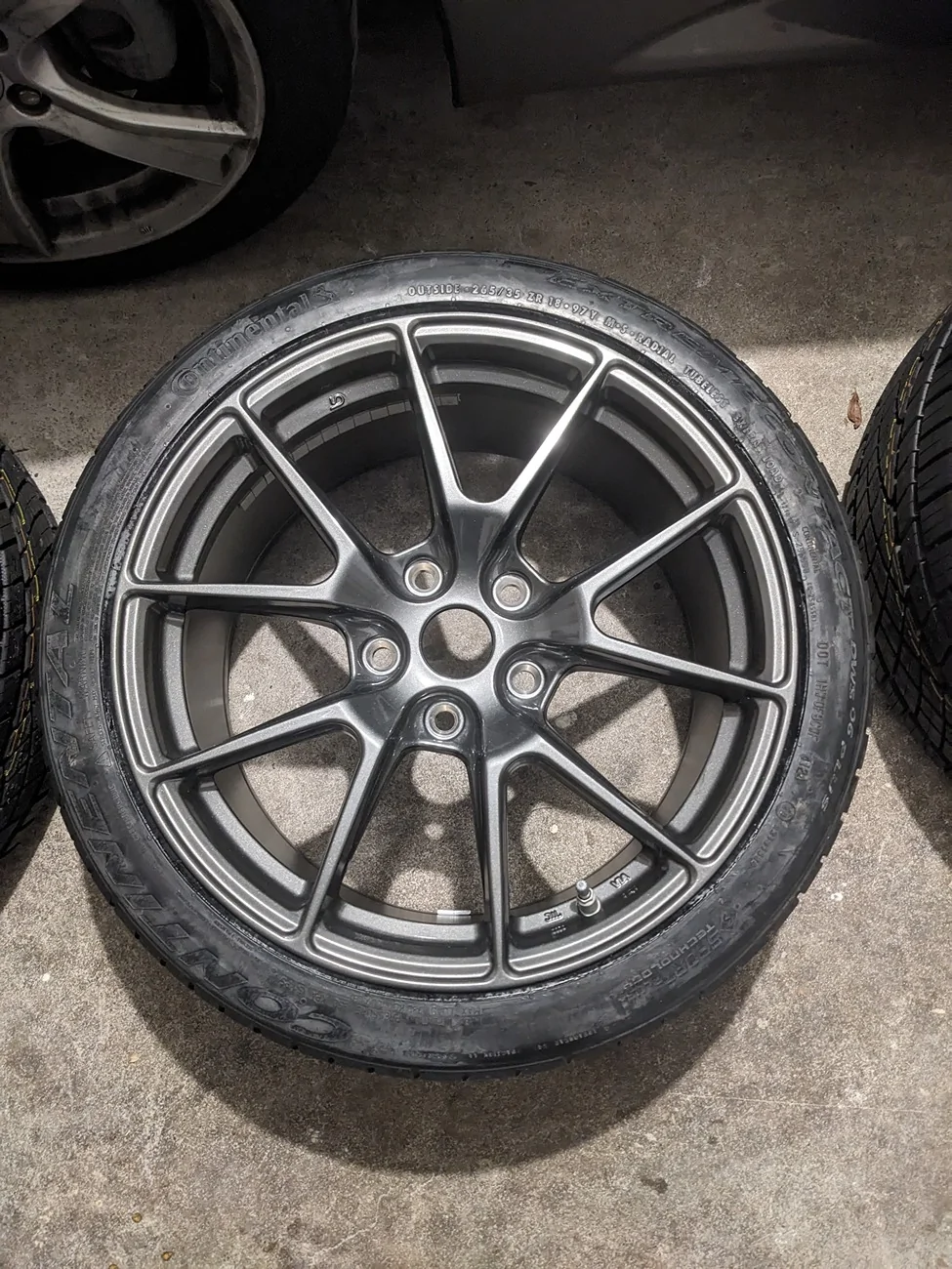

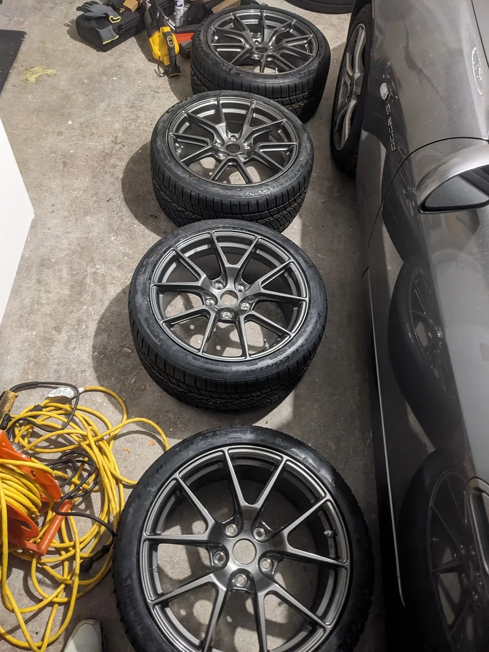

31/29 just sounds too low. I'll have to do my due diligence to make sure I'm not hung up on a number arbitrarily.
They were mounted and balanced today. They'll go on the car the next day or so. Got them from Tire rack through a dealer. Must be new old stock, 4124 is the date code.

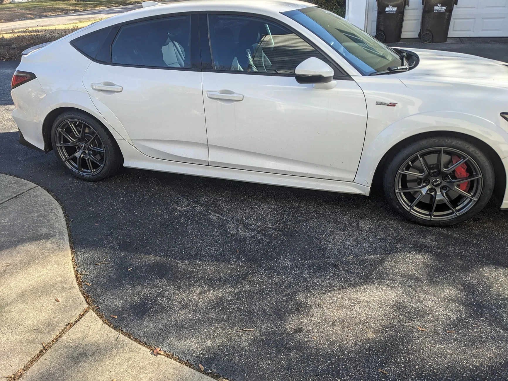

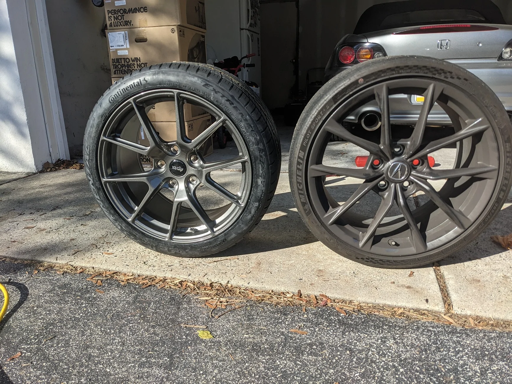

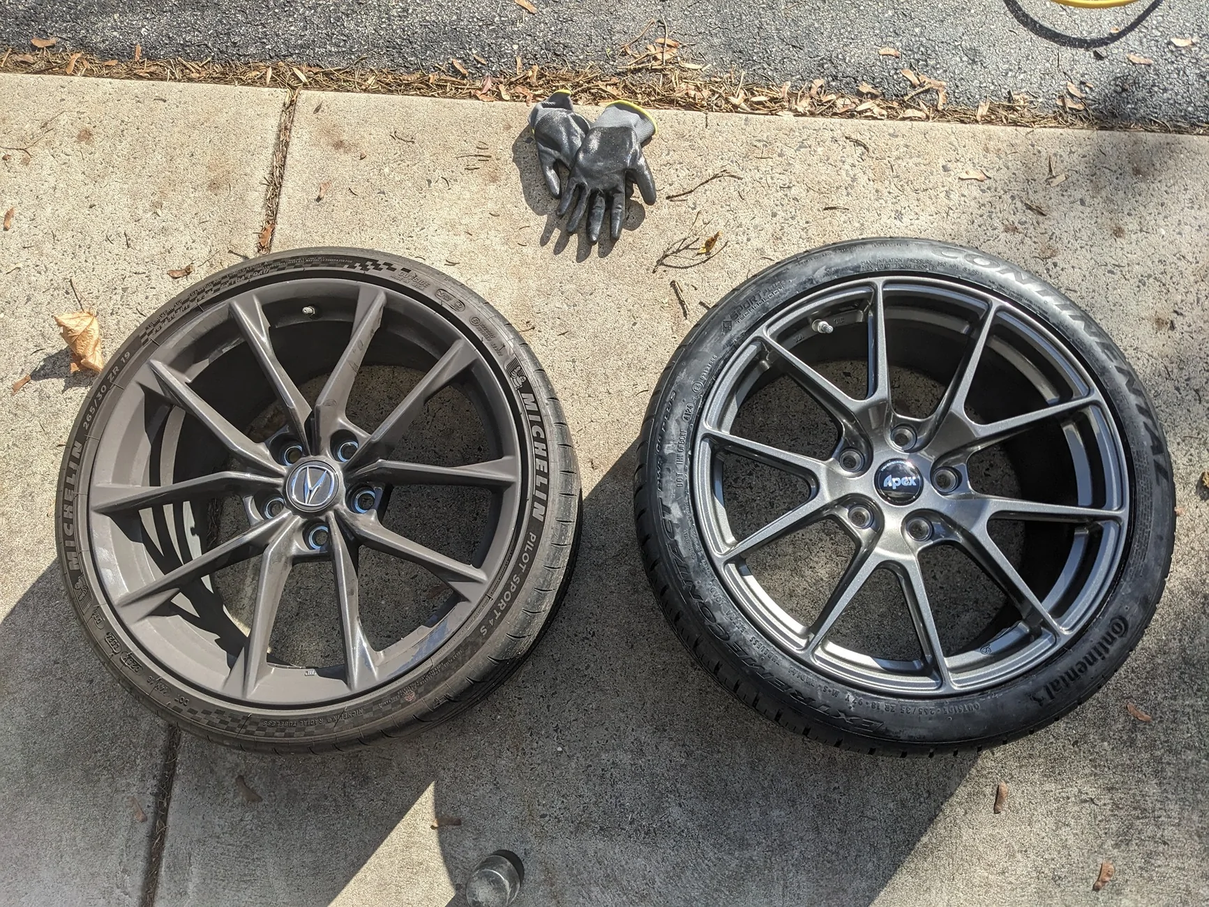

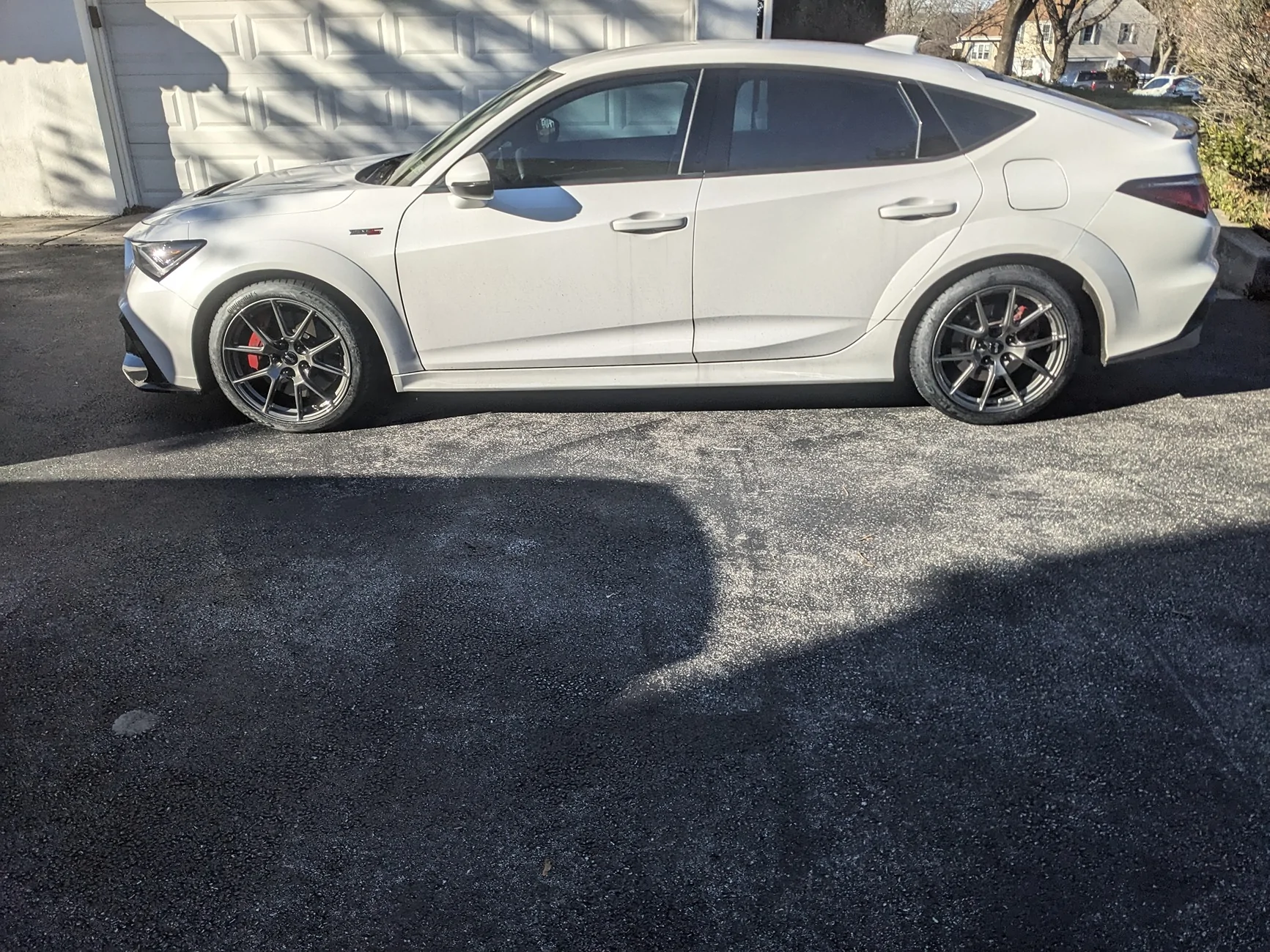

Got them on the car just in time. It snowed a little the day after I put them on. Started with 33/31 and dropped it to 31/29. So far I'm happy with the setup. It's killed some of the road noise which is a nice bonus.
