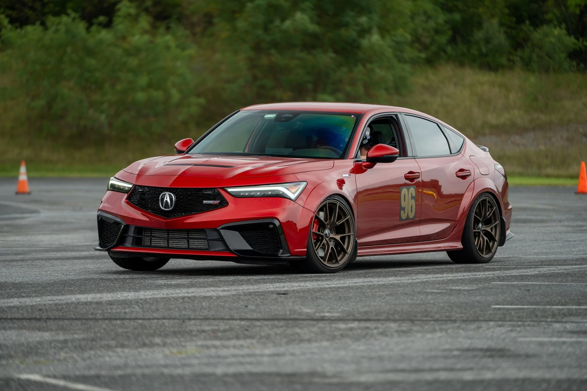

I love the look of the 19" VS-5RS, but it is true I've been eyeing a move to 18s. For me though it's pretty much exclusively just to run the tires I want. This past year I got a little more serious about autocross, and went from my usual annual outing frequency of 3-5 events to 8-10, and I only see that escalating. Not only are there virtually no options for winter tires, there are very limited options for 200TW tires too. That may change if I can confirm Bridgestone will be offering the upgraded version of the RE-71RS in 265 or 275/30/19, but after seeing too many pictures of 18" CE28s on our cars I feel strongly compelled to go that direction- and the CE28 is only available in 18s so that's almost surely what I'd do- but that said I haven't locked in on it yet. Even selling off my Apex's, $5k for wheels is a lot of scratch and I have other priorities at the moment.
I'm particular with how 18s look on this car so I personally wouldn't do VS-5/RSs in 18s but @Zygrene has VS-5RS 18s on his DE5 and I think it does look great. I just REALLY like the CE28s.

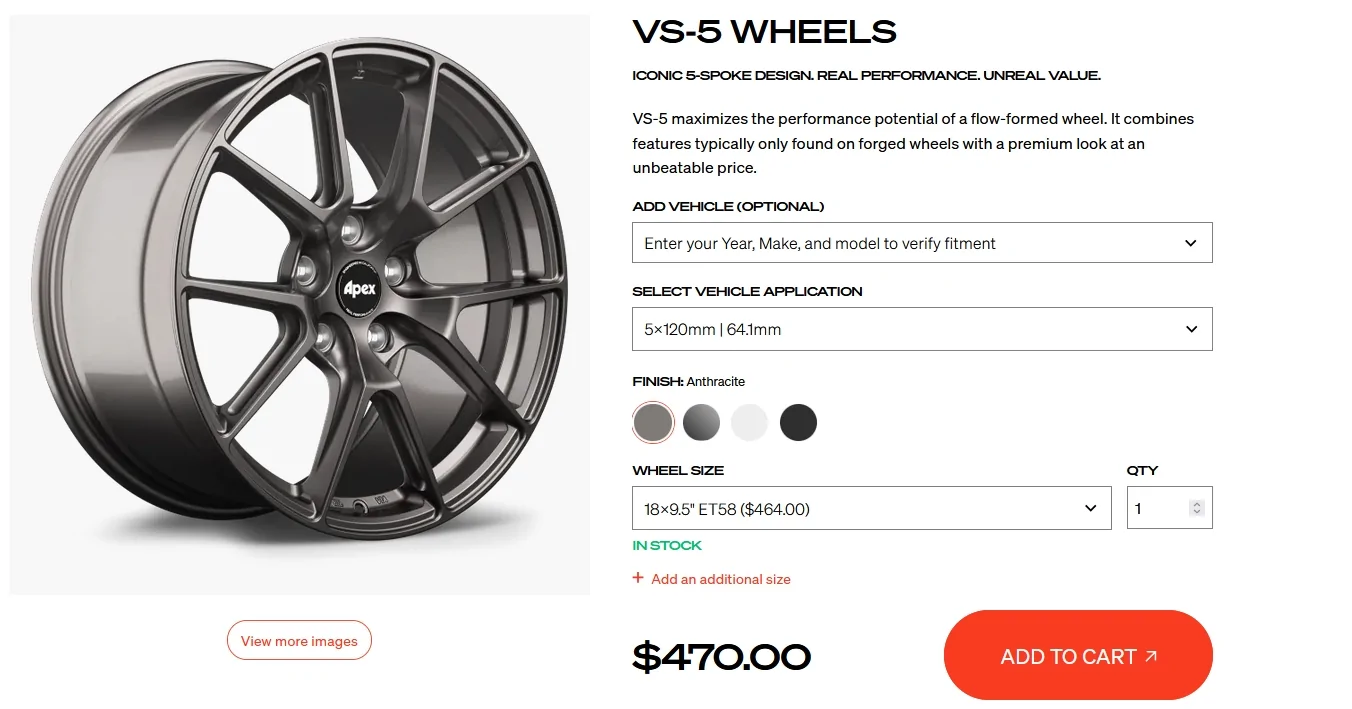

I'll have to call them back with more questions. It looks like they raised the price of the wheels $6 since yesterday. They were $464 and now they're $470. Maybe raising the price in preparation for the sale 😁😁

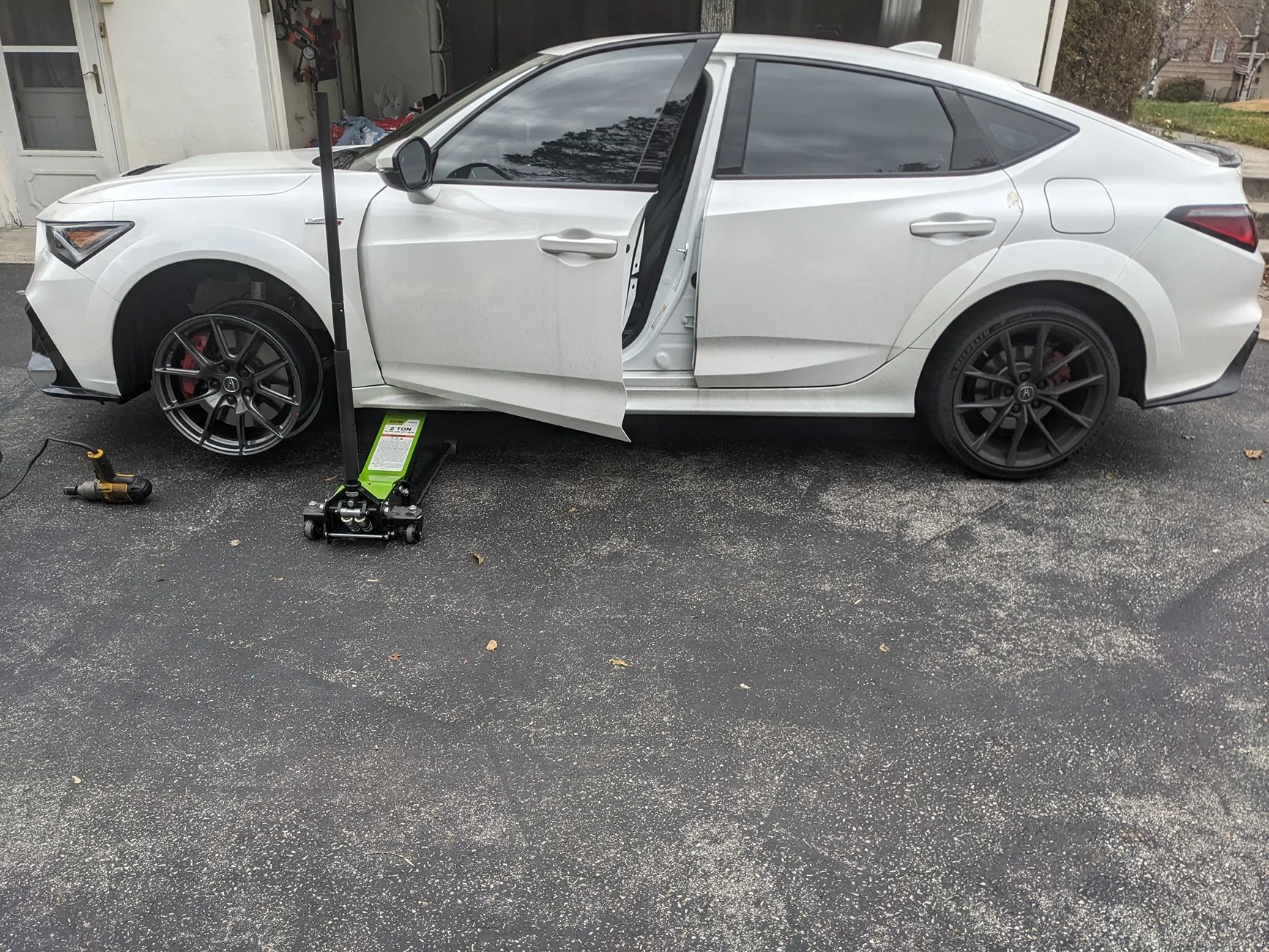

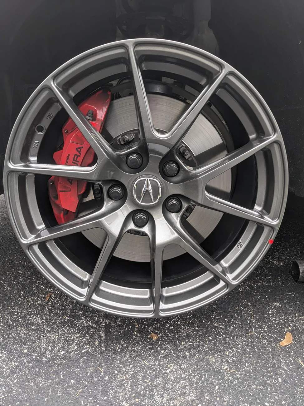

I did a test fit with one wheel. The wheel fits and clears the calipers easily. I'd say it's similar to OEM wheel clearance. The stock center caps almost fit, if you shaved down the clips you could make it work. I just had them sit in place to get an idea. Stock lugs finger tight to keep it from slipping.
